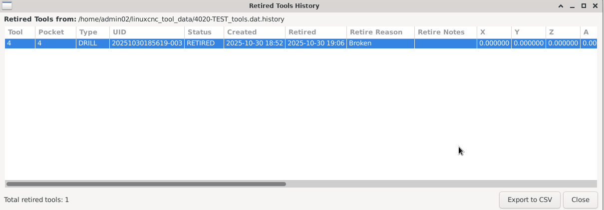

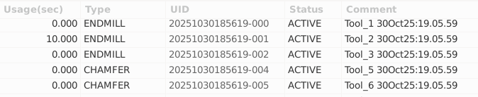

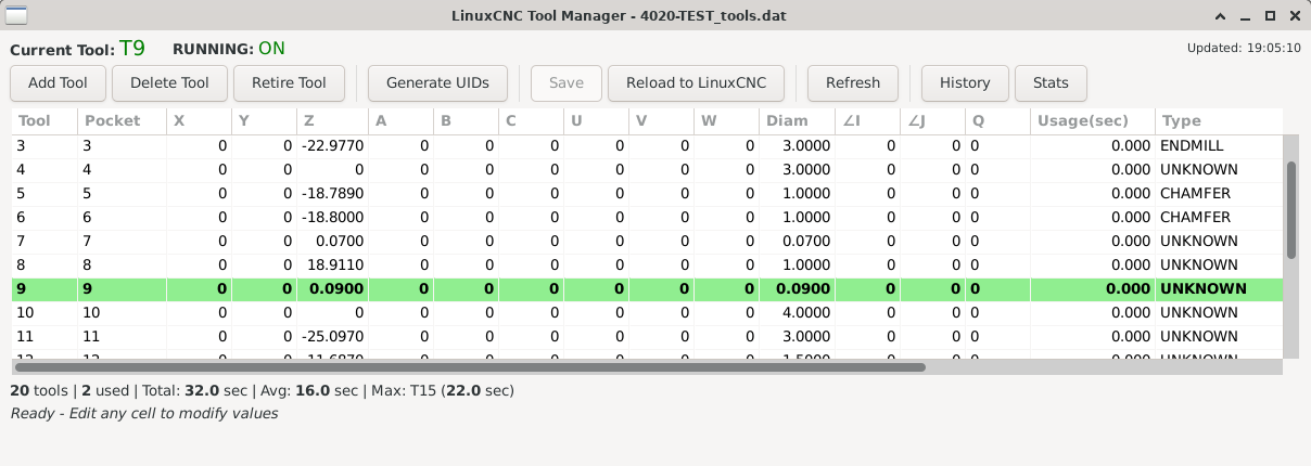

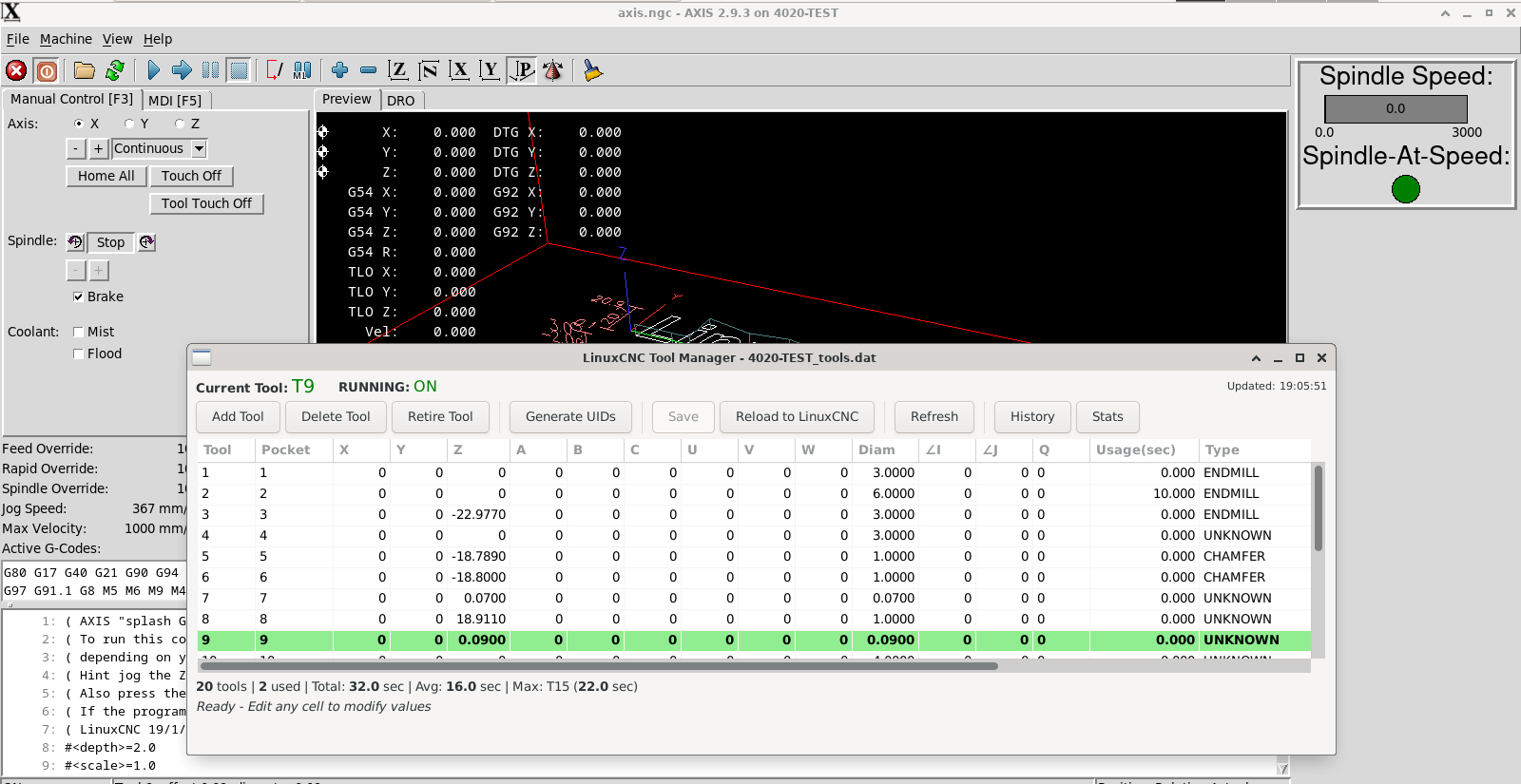

30 Oct 2025 18:44 #337552 by spacestate1
Replied by spacestate1 on topic Tool life tracking with tooldata
I know it’s been a couple of years, but since this is the top Google search result for this topic, I’ve finally put something together.
Here is a tool usage track for LinuxCNC  it used the existing tool db api code to get the information it uses.  It does take the place of the current linuxCNC tool table so be aware of this.
It tracks tool usage time (somewhat accurate, +/-3 sec) it's also not super accurate with drilling.
There's also a tool  retirement feature and  tool UID tagging so tool wear and breaks can be tracked.
The attached Debian also contains all the source to build this, and it's MIT so have at it.
INSTRUCTIONS:
 INSTALL THE PACKAGE
Install with dpkg:
  sudo dpkg -i linuxcnc-db-tool_1.0.0_amd64.deb
This installs:
  /usr/local/bin/db_tool           - Main daemon
  /usr/local/bin/db_tool_manager   - GUI manager
  /usr/local/bin/db_tool_monitor   - GUI viewer
  /usr/local/share/linuxcnc-db-tool/ - Documentation & examples
STEP 3: CONFIGURE LINUXCNC
Edit your LinuxCNC INI file and add:
  [EMCIO]
  DB_PROGRAM = /usr/local/bin/db_tool /path/to/your/tool_table.tbl
Example:
  [EMCIO]
  DB_PROGRAM = /usr/local/bin/db_tool /home/cnc/linuxcnc/configs/my_mill/tool.tbl
STEP 4: START LINUXCNC
Start LinuxCNC as normal. The tool database daemon will:
Start automatically
Launch the GUI manager (if enabled)
Begin tracking tool usage
The following user(s) said Thank You: Becksvill, Aciera, onceloved
