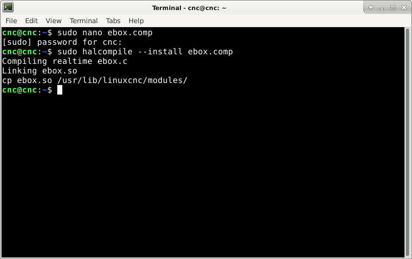

I have an OKK VM4. It has an 8000rpm spindle motor and 2500ppr encoder 2 speed gear box.
Low speed 1:4 /High speed 1:0.75, gear changing mechanism with air cylinder, takes about 5 seconds to change gear while stationary.
I built a 2 speed Hal with Pncconf. I want the output signal to be sent to the gear selector pin A when the M3S is less than 2000 and check the cylinder position sensor within the ebox.comp file.
I'm a newbie to Halcompile, trying to read what I thought was similar to this post. forum.linuxcnc.org/10-advanced-configura...dle-gearbox?start=20
I have tried to use andypugh's e-box on 2.8.4 but it didn't work as shown in the picture. What caused this? How should I fix it? Or suggest the right thing because I don't have any compiler skills yet.
Another problem: When using G33.1, the number of revolutions of the encoder installed on the spindle motor is not equal to the speed of the tap.

15 Oct 2023 17:09 #283081
Replied by andypugh on topic ebox.comp for gearbox 2speed
Can you attach the .comp file? There is something wrong with the syntax on line 2.

- chris@cnc
- Posts: 529
- Thank you received: 140
16 Oct 2023 13:47 #283124
by chris@cnc
Replied by chris@cnc on topic ebox.comp for gearbox 2speed
There was going something wrong during copy.
Typo in Line 2should be
Typo in Line 2
licence "GPL";license "GPL";
The following user(s) said Thank You: SOLD
- SOLD
- Posts: 122
- Thank you received: 13
16 Oct 2023 14:48 #283126
by SOLD
Replied by SOLD on topic ebox.comp for gearbox 2speed
I'll check it. ThankThere was going something wrong during copy.
Typo in Line 2
[/code]licence "GPL"; should be [code]license "GPL";

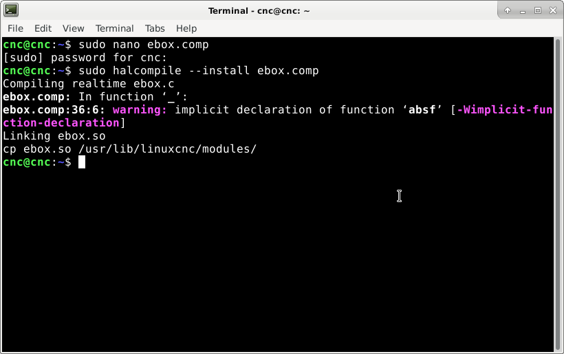

- SOLD
- Posts: 122
17 Oct 2023 15:47 #283186
by SOLD
There is a problem at ABSF. What should I do?
17 Oct 2023 21:53 #283195
Ah, yes. I reckon I probably just typed that out (it was 8 years ago) and used the British spelling (because I am)There was going something wrong during copy.
Typo in Line 2
17 Oct 2023 22:00 #283196
(Sorry, this looks like something that I wrote in my lunch break, without access to a Linux machine to check it with).
Try this:
It needs to be fabs, and that needs an include statement.There is a problem at ABSF. What should I do?
Try this:
The following user(s) said Thank You: tommylight, SOLD
- SOLD
- Posts: 122
18 Oct 2023 05:47 #283208
by SOLD
Thank you for your support.
I compiled it and it worked.
Try this:
