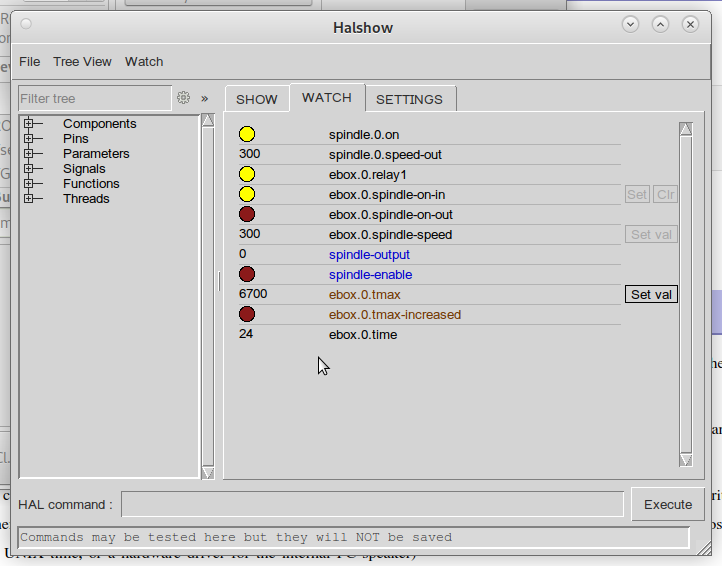

and see the Hal show relay1 = will be 1 when M3S >= 1500 relay1 = will be 0, correct as desired.
I also noticed that when I ordered the M3S2000 it would spin immediately. without stopping and waiting to change gears
Or if increasing speed from S1000-S2000 with GUI relay1 will work on S1500. which means It changes gears as it spins.
As mentioned I still need to study more. before actually using it
If you have a guide, please suggest it. I'm new to this.
Thank you for following.

26 Oct 2023 05:16 - 26 Oct 2023 06:42 #283842
by SOLD
Replied by SOLD on topic ebox.comp for gearbox 2speed
ฉันกำหนดเส้นทางการเชื่อมต่อสปินเดิลผ่านส่วนประกอบ
When the spindle is on ,ebox.0.spindle-on-in is activated. But the spindle-out pin doesn't respond.
I edit the ebox.comp( spindle_on_out = 1; )The ebox.0.spindle-on-out and spindle-enable pin is always active.
I have no knowledge of basic C Please suggest how to fix this problem.
Thank.
loadrt ebox
addf ebox.0 servo-thread
net spindle-vel-cmd-rpm <= spindle.0.speed-out => ebox.0.spindle-speed
#net spindle-enable <= spindle.0.on
net spindle-enable.ebox <= spindle.0.on
net spindle-enable.ebox => ebox.0.spindle-on-in
net spindle-enable <= ebox.0.spindle-on-out
Thank.
Last edit: 26 Oct 2023 06:42 by SOLD.

26 Oct 2023 09:41 - 26 Oct 2023 09:46 #283851
Replied by andypugh on topic ebox.comp for gearbox 2speed
I see the problem, the component does a check for a change in the spindle speed:
But it never updates the "last_speed" so this comparison always returns "false" so the code continues and the timer is set back to 2000.
Try this version.
// Only do anything if the spindle speed has changed
if ( fabs(spindle_speed - last_speed) < 50) return;But it never updates the "last_speed" so this comparison always returns "false" so the code continues and the timer is set back to 2000.
Try this version.
component ebox "electronic gearbox component";
license "GPL";
pin in bit spindle-on-in;
pin out bit spindle-on-out;
pin in float spindle-speed;
pin out bit relay1;
pin out bit relay2;
pin out bit relay3;
function _;
include "rtapi_math.h";
FUNCTION(_){
static int timer;
static double last_speed = -100;
if (timer > 0){
timer -= 1;
spindle_on_out = 0;
} else {
spindle_on_out = spindle_on_in;
last_speed = spindle_speed;
if (spindle_speed >= 1500 ){
relay1 = 0;
relay2 = 0;
relay3 = 0;
spindle_on_out = 0;
timer = 2000;
} else {
relay1 = 1;
relay2 = 0;
relay3 = 0;
spindle_on_out = 0;
timer = 2000;
Last edit: 26 Oct 2023 09:46 by andypugh.
