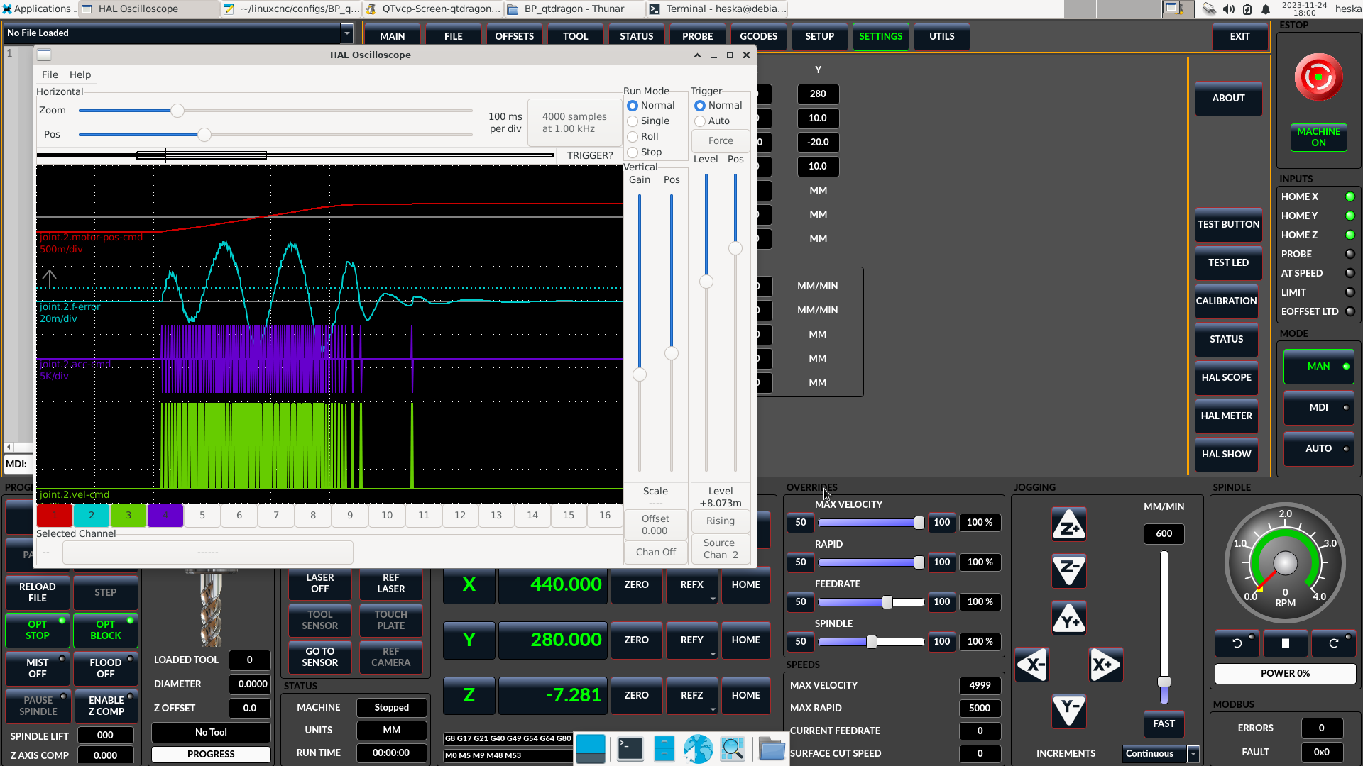

Thanks for suggestion, pos3 is there because without it there is no change in neither joint.2.pos-cmd nor joint.3.pos-cmd when table is moved. Z value in dro changes though. I would like to understand why it does that.
When pos3 is added to kinematics, joint.2.pos-cmd follows the position of the table encoder, but pid goes crazy. Screenshot attached.
I would only expect the z dro position to change as you move the table up. Are you expecting the quill to automatically retract?
I'm just somewhat doubtful that the 'pos' variable actually works across both the forward and inverse functions the way you think. But since I'm no good at C I may be wrong and your code may be right.
