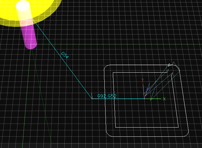

hmm it doesnt look like g52 is going to work either. i'm trying to add or subtract from the current work offset, not just tell the machine where it is. so for example, if the corner of the spoilboard is x0y0z0 but the part is 3" from there in x and y, i just want to offset the work offset by 3" instead of changing it, if that makes sense. That way the machine doesnt need to be in any specific position when the temporary offset is entered, it just shifts the whole program by that amount (probably like the external offset would, except i dont want the machine to move until the program starts)
Sounds exactly what G52 does, add an offset to the current work offset. This screen shot shows the effect of 'G52 x80' on top of an existing G54 offset. :
