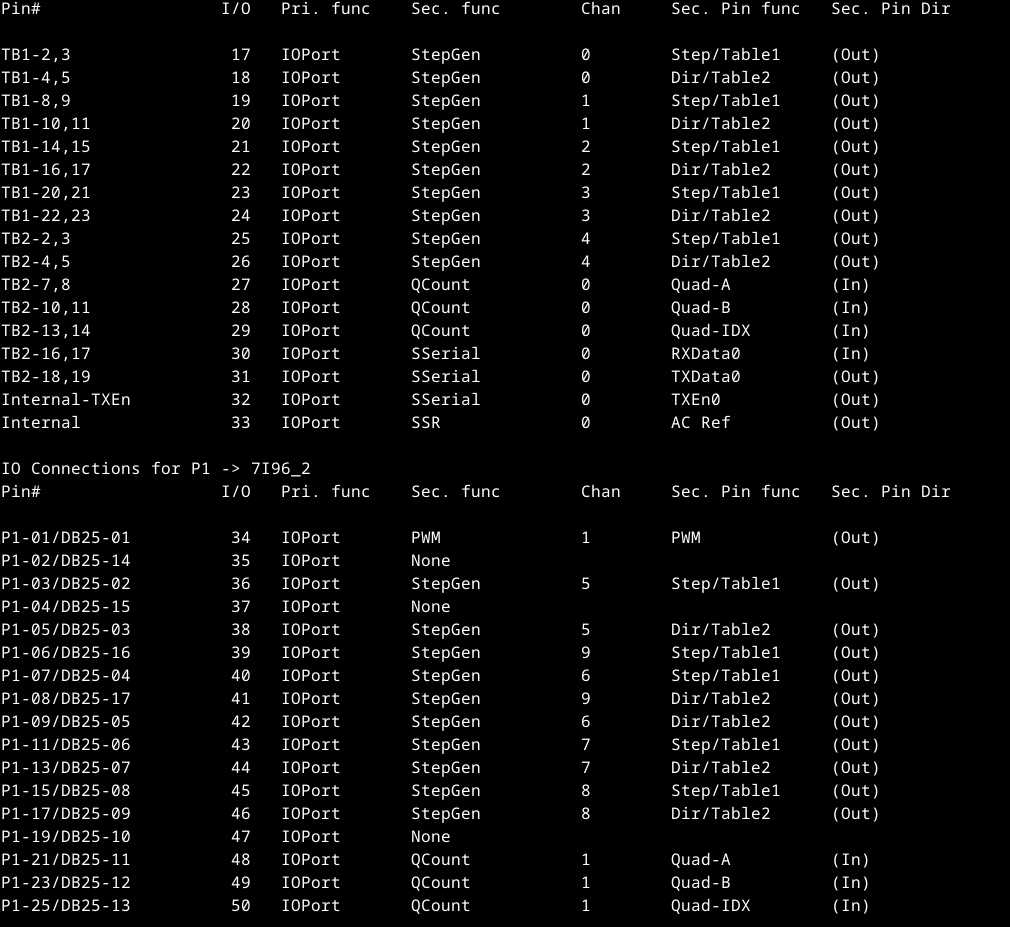

The firmwares are here: www.mesanet.com/software/parallel/7i96s.zip
Looking at thr 5abob.pin file, that has 5 more stepgens (5 through to 9) on the P1 connector.

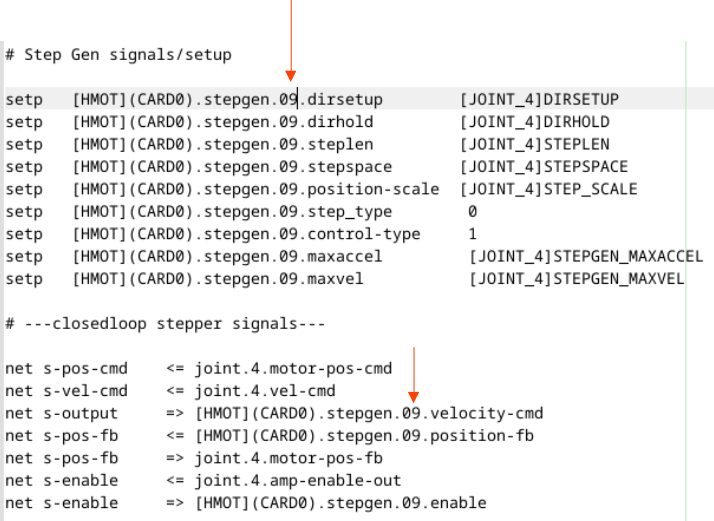

As I understand it, the new firmware adds 5 additional step generators. In the previous configuration, the 5-step generator sent signals to IO-port numbers 17, 19, 21, 23, 25. With the new firmware, the five new step generators send signals to IO-port numbers 36, 39, 40, 43, 45.
When using the Gcode command "G1 X10," the signal is sent to IO17. However, I would like to direct the signal to the P1 expansion port, for example, IO36.
I attempted to resolve my issue by adjusting the step generator's number in the Hal file. As indicated in the attached file, I modified the step generator's number from 04 to 09, anticipating the signal on pin IO39 and IO41 instead of IO25 and IO26. However, regrettably, I cannot detect any voltage change in the newly assigned pins. .
How can I achieve this? (This was my initial question.)
Additionally, I am now curious to know how to command the extra step generators created by this new firmware.

Assuming you are not using stepgen 0..4, you would need to edit the hal file so
it refers to stepgens 5..8 rather than stepgens 0..4
Which brings up the question: Why are you not using the 7I96S TB1,TB2 stepgen outputs?
These are buffered 5V signals intended connect directly to motor drives.
The P1 signals are unbuffered 3.3V signals

Are you buffering the step/dir signals from P1?
As I said, these are 3.3V signals.
You would need to change all the stepgen numbers
for this to work (including all the setup "setp"s)
