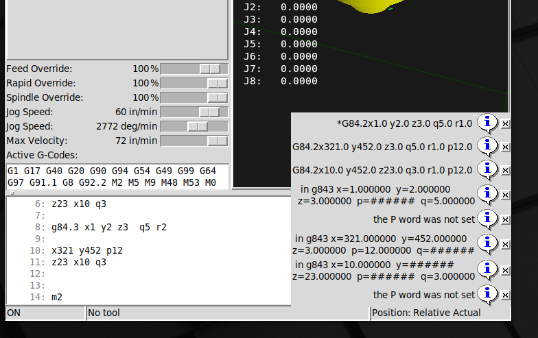

One problem found: in cycle.ini of the example, the [PYTHON] stanza is missing with all the PATH_ entrys. Fixed that, but still it is not working

I'm getting:
File "/home/user/linuxcnc-2_9-oct/configs/sim/axis/remap/cycle/../../nc_files/remap_lib/python-stdglue/stdglue.py", line 361, in cycle_prolog
if self.sticky_params[r.name] <= 0.0:
TypeError: '<=' not supported between instances of 'dict' and 'float'
[edit]
Changing line 361 in '/home/user/linuxcnc-2_9-oct/nc_files/remap_lib/python-stdglue.stdglue.py'
to
if self.sticky_params[r.name]["r"] <= 0.0:
gives me this when I run the demo code, so I guess something is not quite right yet:

I think the answer is to change the stdglue.py line 361 to:
(ie, append to index into the dict to find the float value.)
else:
if self.sticky_params[r.name]['r'] <= 0.0:
return "%s: R word must be > 0 if used (%.4f)" % (r.name, words["r"])(ie, append to index into the dict to find the float value.)

Curiously, you can't run the G84.3 command from the MDI tab, but it works in G-code.
On a normal installation the strdglue.py file is found in /usr/share/linuxcnc/ncfiles/remap_lib/python_stdglue/

or maybe rather some kind of python context as it seems to be unable to find it
Replied by Aciera on topic remap.cycle in 2.9.1 broken?
Not sure but it may be missing values that get set by G84.2 if it is run in the same gcode program.Curiously, you can't run the G84.3 command from the MDI tab, but it works in G-code.

I think it's the call to init_stdglue:
Anyway: github.com/LinuxCNC/linuxcnc/commit/052a...6ef4e3f0efec06f717b7
def cycle_prolog(self,**words):
# self.sticky_params is assumed to have been initialized by the
# init_stgdlue() method belowAnyway: github.com/LinuxCNC/linuxcnc/commit/052a...6ef4e3f0efec06f717b7

Great support. It is working now. Thank you
