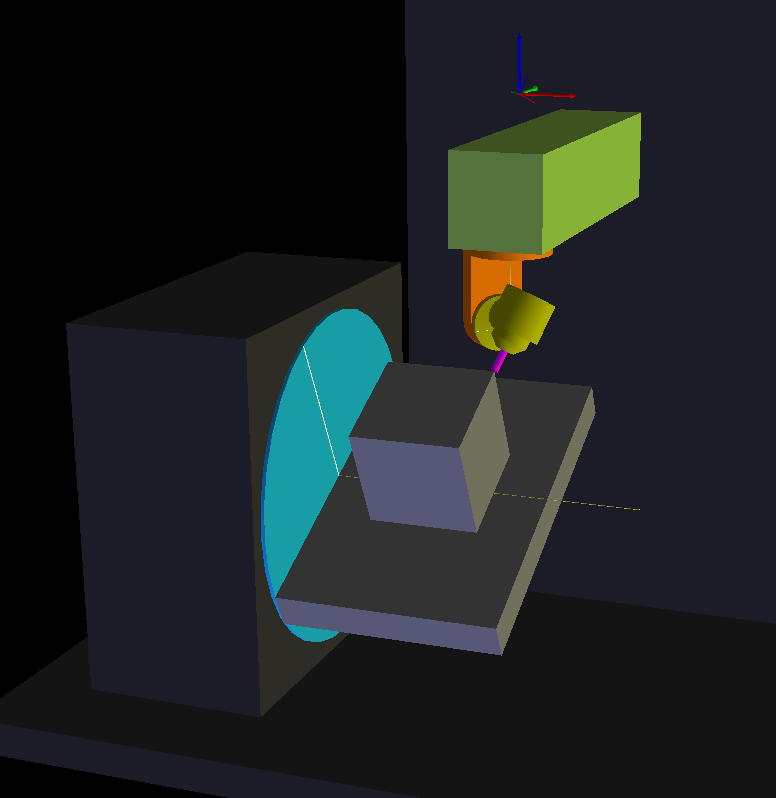

I would need a little help modifying "default" 5axiskins.c used also by configs/sim/axis/vismach/5axis/bridgemill, and there B axis rotates in opposite direction as I would need for my machine (clockwise around Y axis, looking from machine coordinate 0).

Warning: Spoiler!

- Thank you received: 4654
12 Jan 2024 11:54 #290497
Replied by andypugh on topic 5-axis kinematics B axis invert rotation
What exactly is the problem? Is it that the B axis rotates in the wrong direction when commanded to move directly, or that it moves in the wrong direction when it is part of a TCP coordinated move? Or both?
- tommy
- Posts: 106
- Thank you received: 3
12 Jan 2024 12:22 #290499
by tommy
Replied by tommy on topic 5-axis kinematics B axis invert rotation
12 Jan 2024 12:40 #290501
Yes, but, is it purely reversed, or only reversed in TCP mode?
- Posts: 4818
- Thank you received: 2176
13 Jan 2024 16:53 #290568
Replied by Aciera on topic 5-axis kinematics B axis invert rotation
I'm not familiar with the posemath library use in the bridgemill config but I've made a sim config for a CB-spindle-rotary-tilting machine that includes TCP and TOOL kinematics (this also includes an A-axis table-rotary).
Documentation is included in the README and the 'Documentation'-folder
- tommy
- Posts: 106
13 Jan 2024 18:51 #290574
by tommy
I figured it out it is much easier for me to modify my postprocessor.
Anyway I still need to adjust #define DEFAULT_PIVOT_LENGTH 250 to different number than 250 inside kinematics file, but can't compile
Compiling realtime 5axiskins.c
Linking 5axiskins.so
/usr/ld:5axiskins.ver:2 syntax error in VERSION script
collect2: error: ld returned 1 exit status
make: *** [/usr/share/linuxcnc/Makefile.modinc:125 5axiskins.so] Error 1Please Log in or Create an account to join the conversation.
- Posts: 21957
- Thank you received: 7478
13 Jan 2024 19:48 #290577
Replied by tommylight on topic 5-axis kinematics B axis invert rotation
Syntax error is usually a missing or added : or ; or , or typo somewhere, not easy to pinpoint as the report does not give much to go on.
- Posts: 4818
13 Jan 2024 20:02 #290580
Looking at '5axisgui.hal' I don't think you need to change the kinematic component to change the pivot-length:
loadusr -W 5axisgui
# to set different pivot_len, use:
# 'loadusr -W 5axisgui pivot_len=value'Please Log in or Create an account to join the conversation.
- tommy
- Posts: 106
14 Jan 2024 17:28 #290673
by tommy
I missed this one, it works!
loadusr -W 5axisgui pivot_len=valuePlease Log in or Create an account to join the conversation.
- tommy
- Posts: 106
23 Jan 2024 19:41 #291455
by tommy
Time to create page: 0.489 seconds
