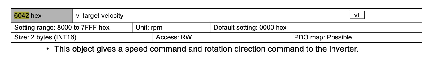

Hello folks,
I have a spindle with max 60.000rpm. While using with 1000Hz VFD from the vfd software working on max rpm. The vdf is connected throuhg ethercat and I can control all the functions.
But the lcnc max rpm is 32766. In the ini file contains 10-60k rpm.
Where can I look for additional settings?
thx.
thx.

Seems like 6042 hex "target velocity" is 16Bit (2Byte).
That would give you -32768 to +32767 if you need forward and reverse spindle speed.
14 Jan 2024 14:25 #290646
You might need to command the motor frequency directly and convert in HAL, or possibly send the revs-per-second value from HAL and scale in the VFD.
Replied by andypugh on topic Spindle speed limited
Yes, that specific number immediately made me think of hitting the 16-bit integer limit.Seems like 6042 hex "target velocity" is 16Bit (2Byte).

Nice. Yes it is 16 bit.
"You might need to command the motor frequency directly and convert in HAL, or possibly send the revs-per-second value from HAL and scale in the VFD. "
I take a look at the VFD manual, but I think 0x6042 is in rpm. How can I command it diretly? You mean analog?

Your XML doesn't matter. If you look at the manual it states that OD 6042h is 16Bit only.

Yes, I did exatly that. I also look for rps, but nothing found.

Not sure if there is an option with the EtherCAT interface for your VFD. You might need to go back to analog 0-10V and start, stop and reverse inputs.

Yes, I think going back to modbus. Maybe some ethercat modbus converter for beckhoff.
...If I did not get help from omron, maybe firmware update for ethercat hat.
