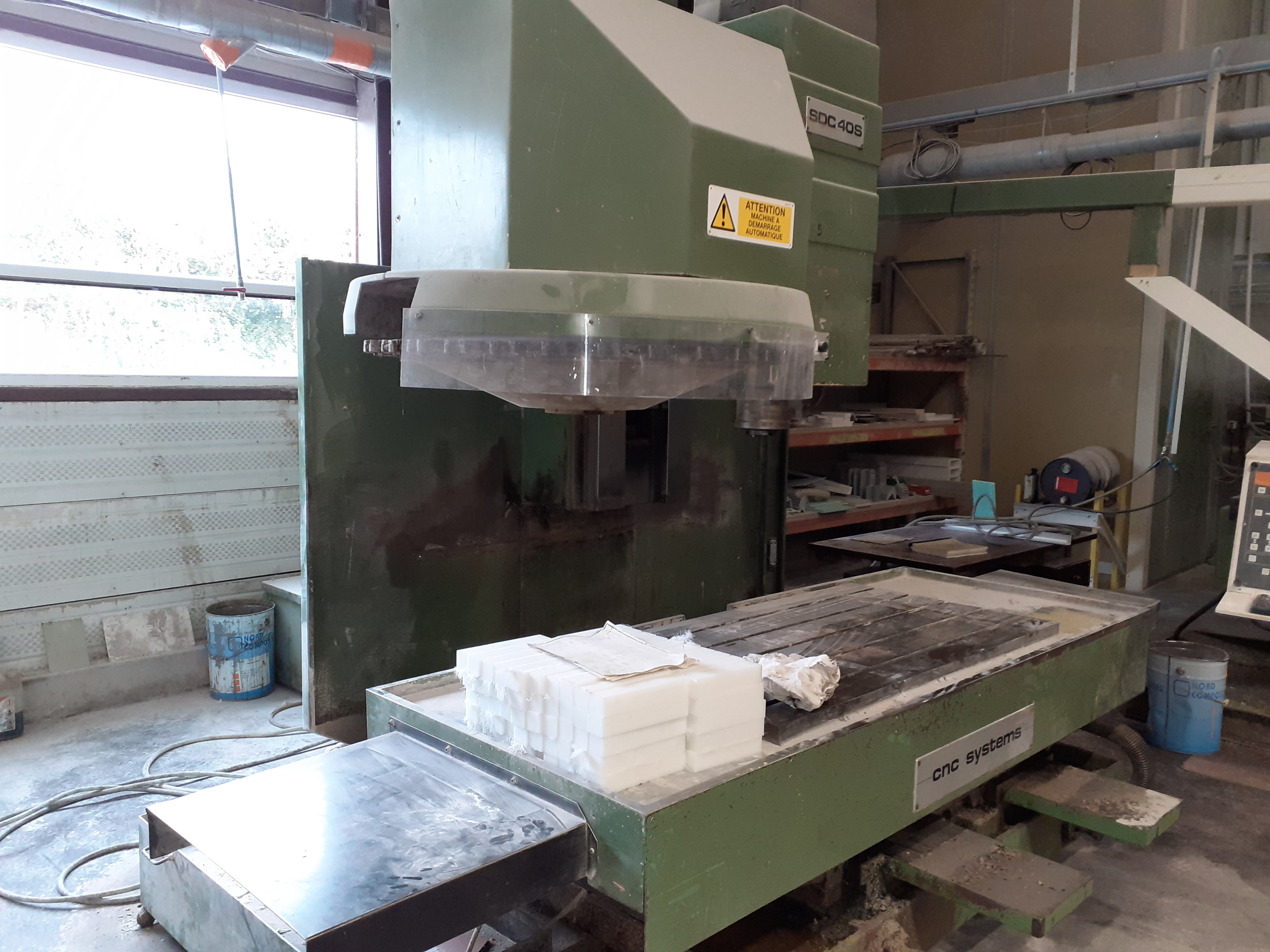

I'm having problems with my tool change/caroussel.
loadrt carousel pockets=30 encoding=index num_sense=2 dir=2
on my caroussel the home is on tool 30 (the last one)
when I ask for a tool change I am shifted by 1 just after the homing, then the carousel works perfectly, I have the right tool shift
I think that the modification should be made on the carrousel.comp but not knowing pyton programming, I prefer not to modify the program too much.
the second problem comes from the jog of the carousel, the programming I have done does not work, what modification should I make to make it work?

yes, I have a sensor for the index of my caroussel and I have a sensor for the motor of the caroussel 1rev = 1 pocket
The reason why on the pocket 30, I do not know, it was assembled like that of origin and to modify mechanically and too complicated.
a photo of my milling machine attached
after a lot of reading of the caroussel.comp file i think this parameter should be changed
if ( ! index_enable || ((! old_index) && ind)){ // index found
current_position = 1; ============> 30
is there a command to edit a coump file or do i have to download it on github modify and install it?
for the jog, i found your post, i will read it more in depth.
