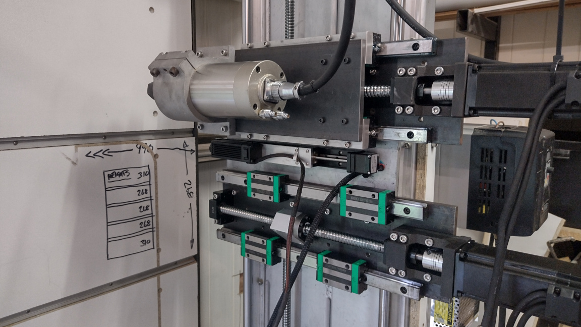

I'm in the process of upgrading from one spindle to two spindles plus a laser all on separate Z axis' (3 x Z axis' in total: X, V and W) attached to the common Y axis fixed gantry. The workpiece moves along the X axis. I intend to use the primary X axis spindle for routing, the V axis laser for engraving and marking with a 5500mW laser and the W axis spindle for drilling.

I've now got the machine running with the the 3 x Z axes: main spindle, laser engraver and drilling spindle on ZVW respectively. The concept of a custom kinematic is intriguing. Would you set up 3 joints and link them all to the one "Z" axis but only operate the 'active' joint based on a state stored in the kinematic component? Does Axis still think it only has one 'Z' axis but perhaps swap between the joints with a HAL 'variable' or something? Perhaps use some custom M codes to change the active axis? Sorry, I'm not very experienced with LinuxCNC - still trying to piece it all together. Maybe I'm off track.

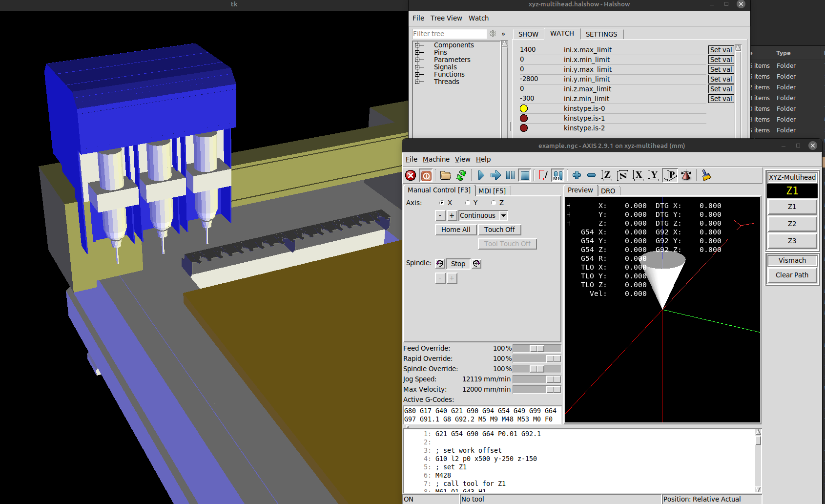

I have created a sim config for an XYZ gantry machine with 3 heads:
github.com/Sigma1912/LinuxCNC_Demo_Confi...e/main/xyz-multihead
To test you need to install the custom component 'xyz_multihead.comp'. Instructions can be found in the enclosed README.
That is pretty much spot on.

Note that you could also handle the spindle offsets using an automatic shift in the current work offset when changing the kinematic. Or possibly automatic adjustment of the current tool offset values.
As mentioned in the README you can automatically change z-axis settings from the ini file (currently commented out in the M428, M429, M430 remaps). Ie you could adjust the acceleration, velocity, and limit values for the z-axis depending on the head currently selected.
Switchable kinematics has been merged into Linuxcnc rather recently so not many users have made use of it outside of 5-axis configurations or robots. Personally I find that it's capabilities are very much underrated and many potential uses are still to be discovered.
