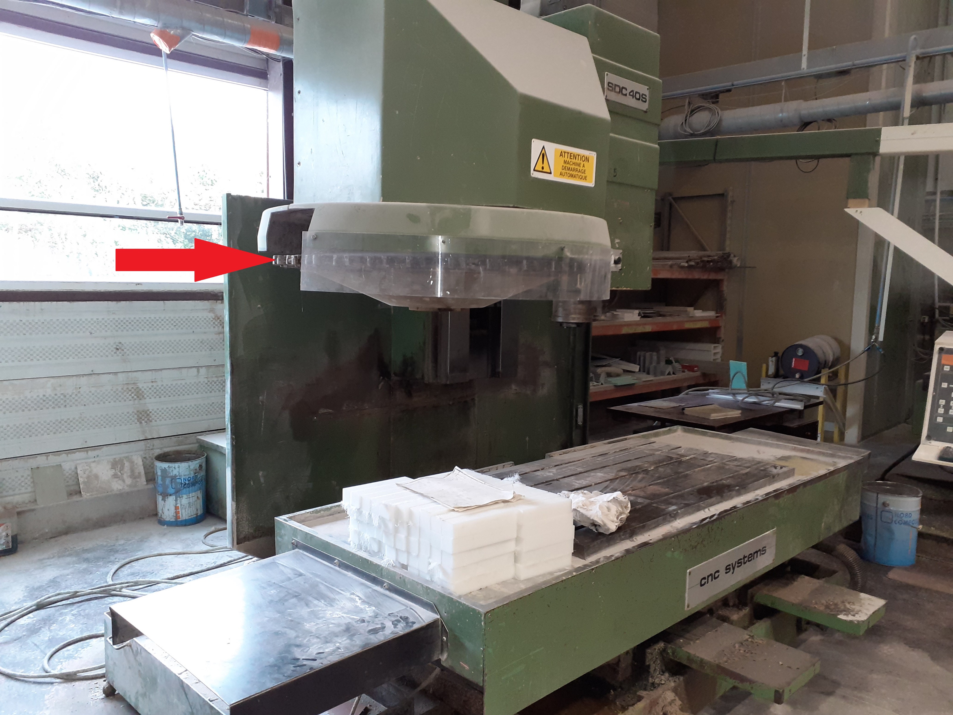

To start with, at the moment the carousel is working perfectly but my problem comes from the condition
o103 if [#<tool_in_spindle> NE #<current_pocket>]
(abort, tool changer in wrong position)
o103 endif
I have a little program called mdi_command, which when you press a physical button turns the carousel to tool 16 (No tool change). This mini program works.
on the other hand if I ask for tool number 2, the program does not abort, but executes the tool change. so the tool currently in the spindle is in pocket 16.

it's not for a random tool change, i have a carousel with 30 tools. my carousel is surrounded by safety casing except in 1 place, opposite the spindle.
when my button is pressed, the carousel shows tool 1 in front of the slot, so tool 16 in front of the spindle, to avoid having to press jog 15-16 times to be in front of tool number 1.
the mini-program (MDI_command) is as follows:
it shows tool number 1 in front of the slot, but if I call tool number 2 in the spindle using M6, it should display an error message.
but as said before, it executes the tool change program, so the current tool in the spindle is inserted into pocket number 16 or the pocket immediately in front of it. Whereas in the M6 remapping I did insert the condition

That's precisely how the random tool changer option behaves the system manages tools and pockets.

yes, sorry, I've just tried it out and it works perfectly!
