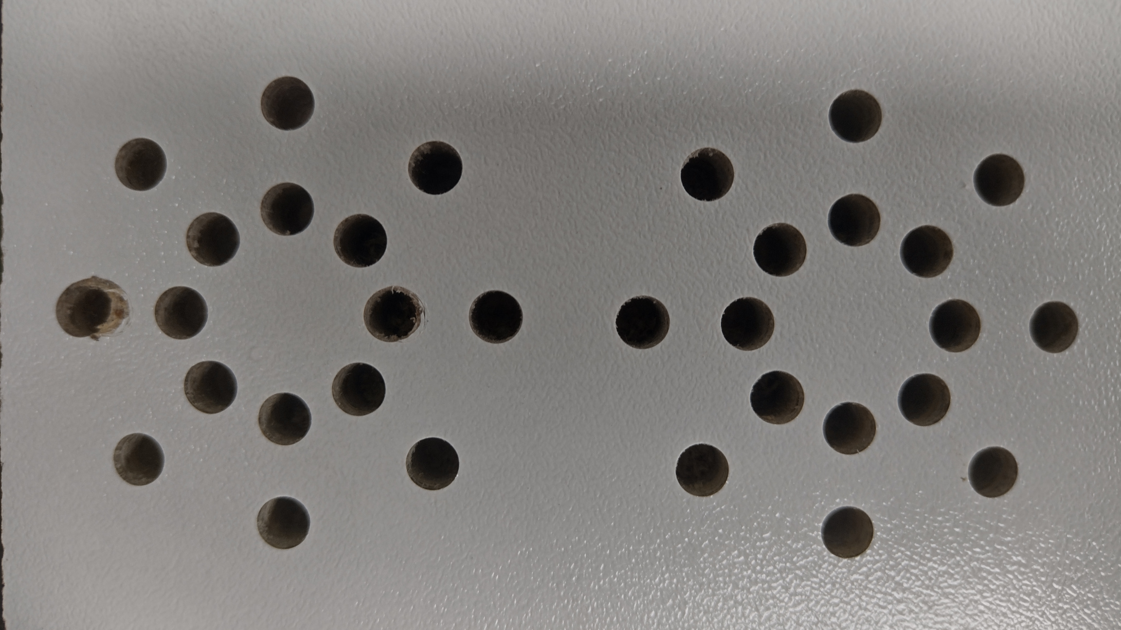

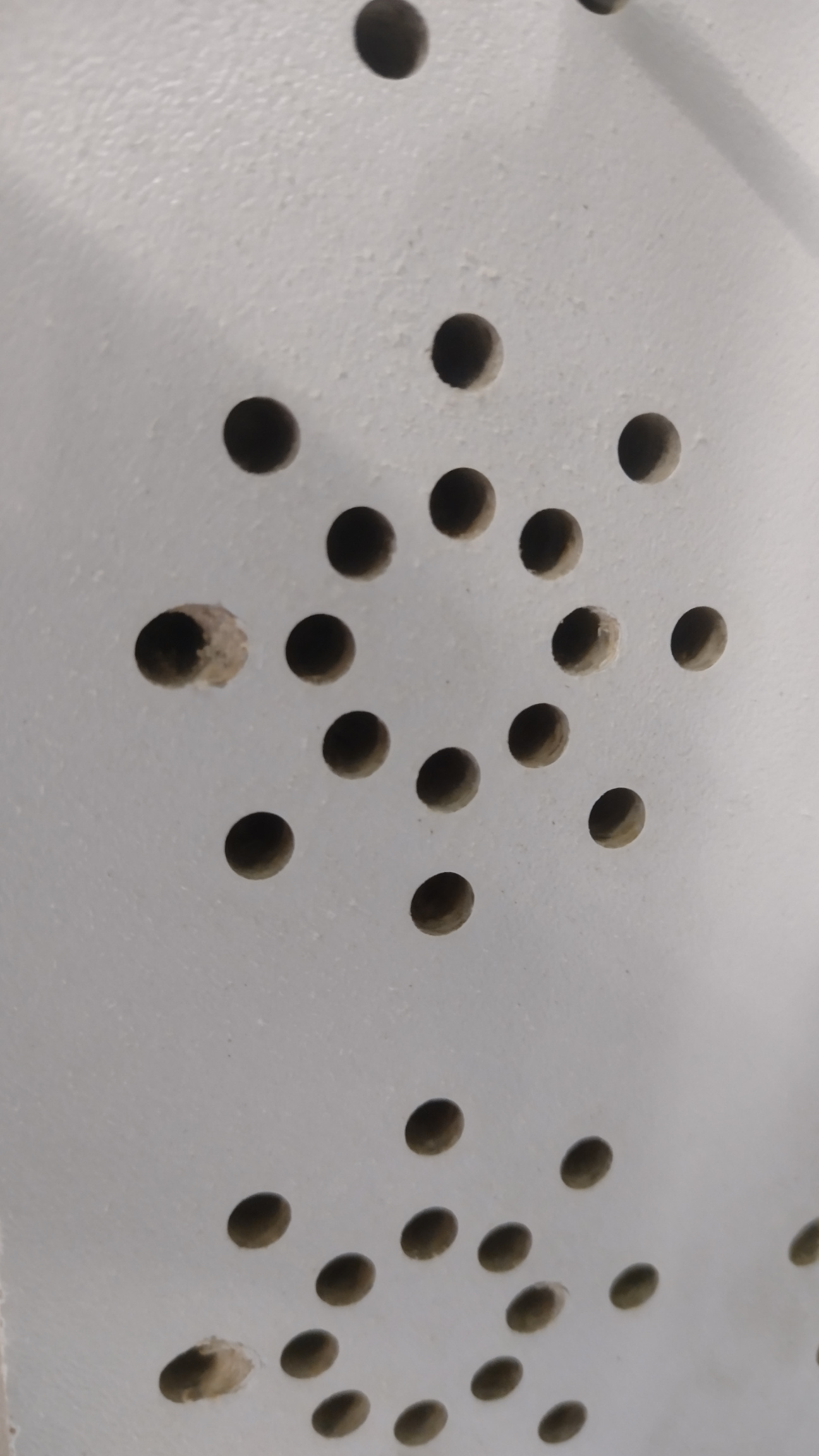

Here's a puzzling one: I ran a test file that drills some holes. The X axis starts moving before the W axis has retracted. See the holes in the middle (horizontal) row - the leftmost hole and the third of four in that row - in the photo attached. Where do I look to solve this one? It only seems to happen in the X direction; not when diagonal moves are next in the sequence.

I can't totally explain what is going on but I tend to throw in quebusters when I use loops, try this in your 'holes_5mm,ngc' (Note the two lines with 'M66 E0 L0' at the beginning and at the end):

Thanks Aciera, the
M66 E0 L0 (wait on input)
fixes the issue.
In testing, I also found G61 (Exact Path Mode) also fixes the issue.
