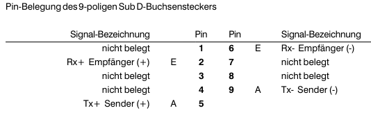

Hello,At my university, we have acquired a portal milling machine from 1998. We are interested in installing LinuxCNC on it.In 2001, the machine received a new frequency converter, an Isel FC2200-C. We aim to control the spindle using the Mesa 7i96s board. The question now is how to accomplish this.Is it possible to control it using RS-422 or RS-485? If so, how would we go about it?Alternatively, do we need to connect via the 15-pin plug?I have attached the pin layout, but unfortunately, it's in German.
translation for the 15pin Plug:
X1:
Pin 1: reference ground analog Pin 2:Auxiliary voltage + 10 V
Pin 3: start left Pin 4: Error acknowledgment (PLC-compatible)
Pin 5: Signal voltage (+ 24 V) Pin 6: Output A2 (max. 20 mA)
Pin 7: GND Pin 8: not occupied
Pin 9: Analog setpoint Pin 10: Enable (PLC-compatible)
Pin 11: start right Pin 12: Pulse generator (5 V... 30 V)
Pin 13: Output A1 (max. 100 mA) pin 14: Rotational speed actual value (0 V... 5 V)
Pin 15: not occupied
thanks
X1:
thanks

Assuming analog control, the analog section looks like it should be:
X1 7I96S
2 10V --> 7I96S SPINDLE+ (TB2.24)
9 ANALOG SETPOINT --> 7I96S SPINDLE OUT (TB2.23)
1 ANALOG GROUND --> 7I96S SPINDLE- (TB2.22)
Not sure about the digital control pins, probable need an
example from the manual for that.
X1 7I96S

We wired the frequency converter to the 15pin plug and get it done.
thanks
