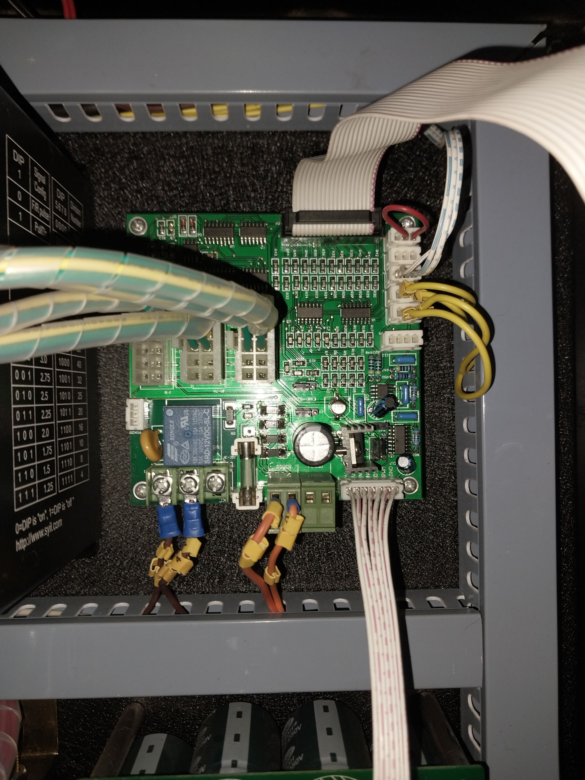

Hi so I’ve made a couple posts on here and hopefully not annoying any of the moderators. I guess it’s difficult to explain what’s happening in my situation so I made a little quick short youtube video about it. Its only about 3 min long and goes straight to the point besides a couple brain farts while clicking through the Stepconf wizard. Anyways it has to do with configuring the spindle and I can’t understand anything about it. If someone could have a look at it and maybe shed some insight I would really appreciate it very much. So far, I can run the spindle in manual mode but I have to be there to turn it off after a job is running and also have select a different speed every time I change tools. Anyways thanks?
Also should I completely otherwise just replace my spindle driver and maybe even the motor and is there any setups that I can still configure to work using parallel port? I have a feeling that this spindle system I have is outdated and low quality because there no documentation on it
- Posts: 18122
- Thank you received: 5337
30 Apr 2024 16:25 #299423
Replied by PCW on topic Spindle Situation
Can you post your hal/ini files and indicate what
kind of parallel port breakout card you have?

Hi PCW thanks for your trying to help. Im not sure what breakout board it is other than the one that came stock with a Syil machine. I took a couple photos of it and picture of the stepper drives. I also included uploaded the ini and hal files. Do you think i should get rid of the generic breakout board and replace it with something more modern?

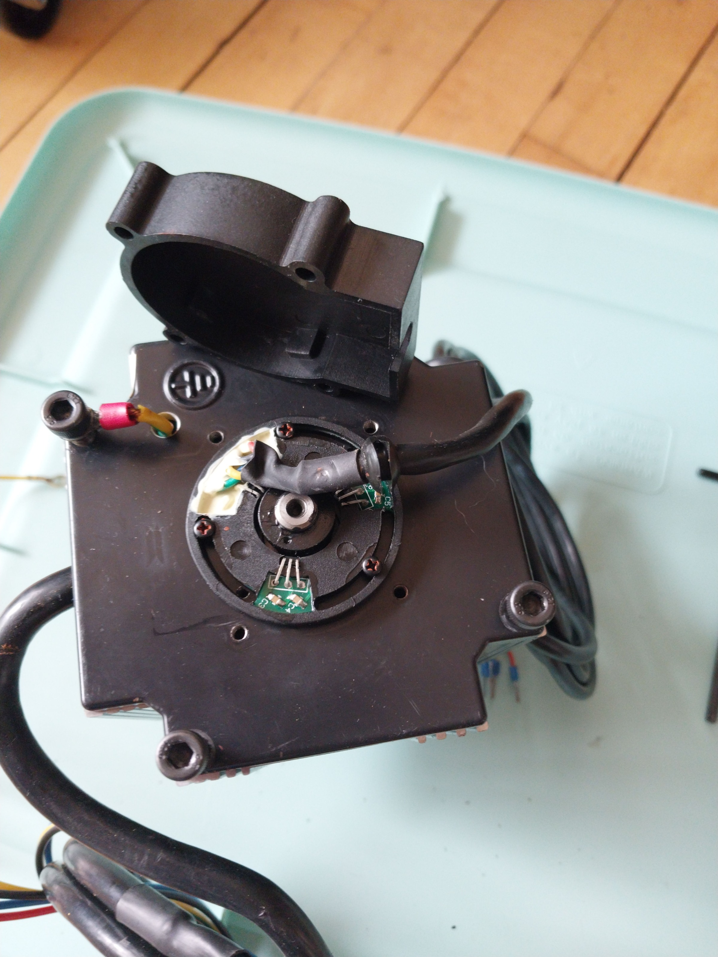

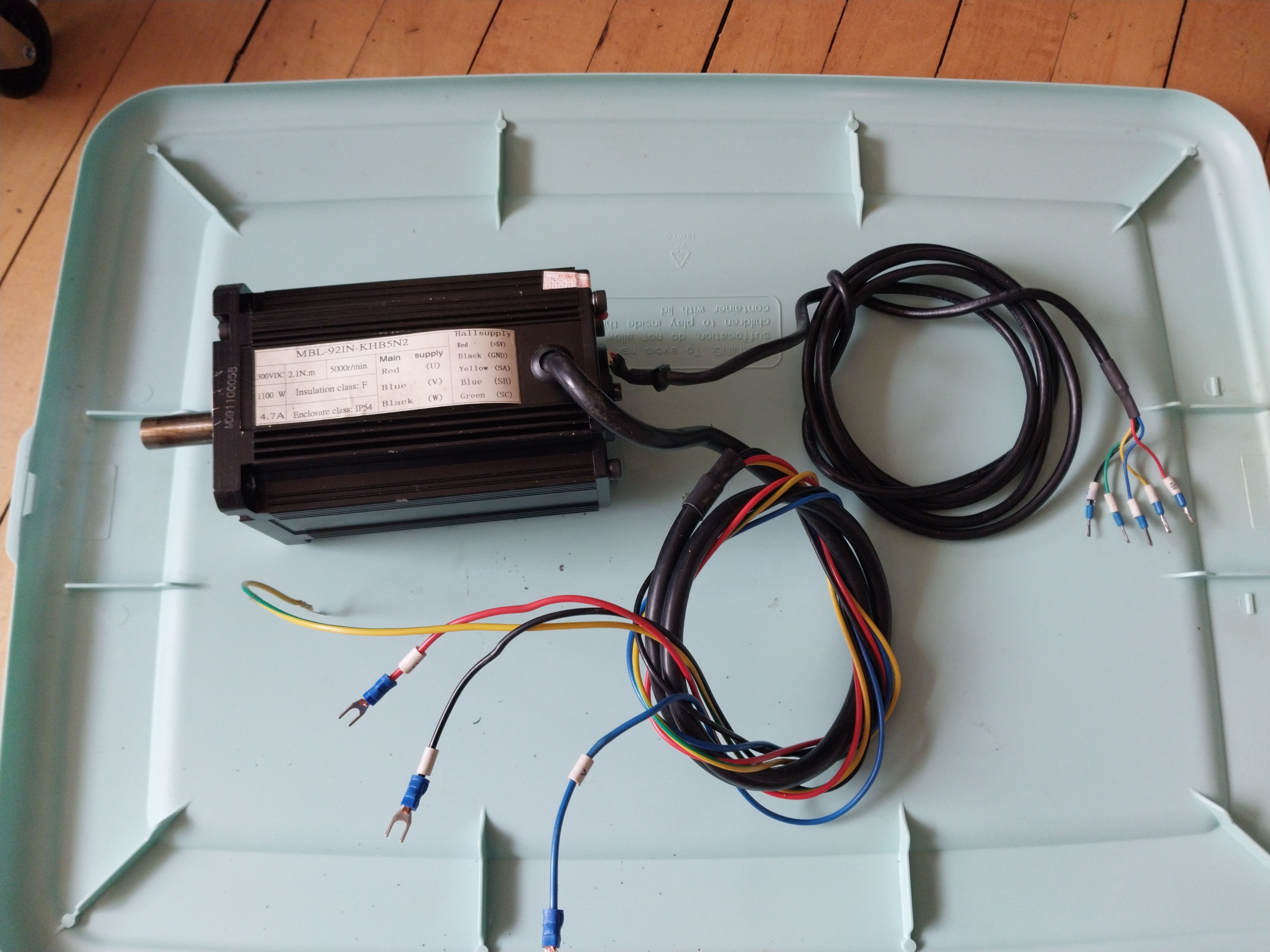

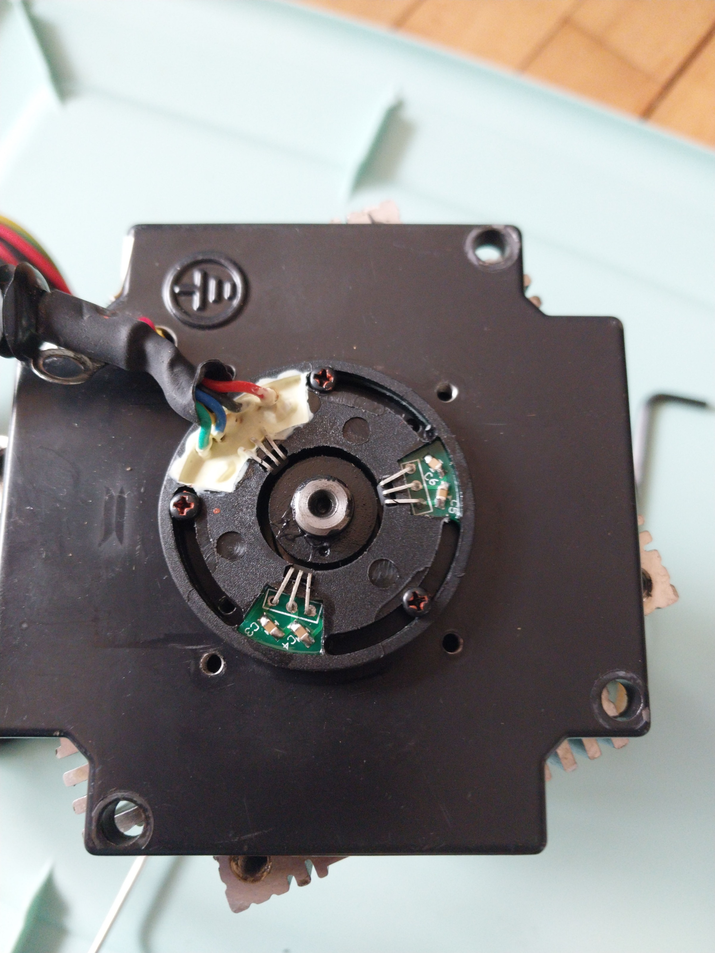

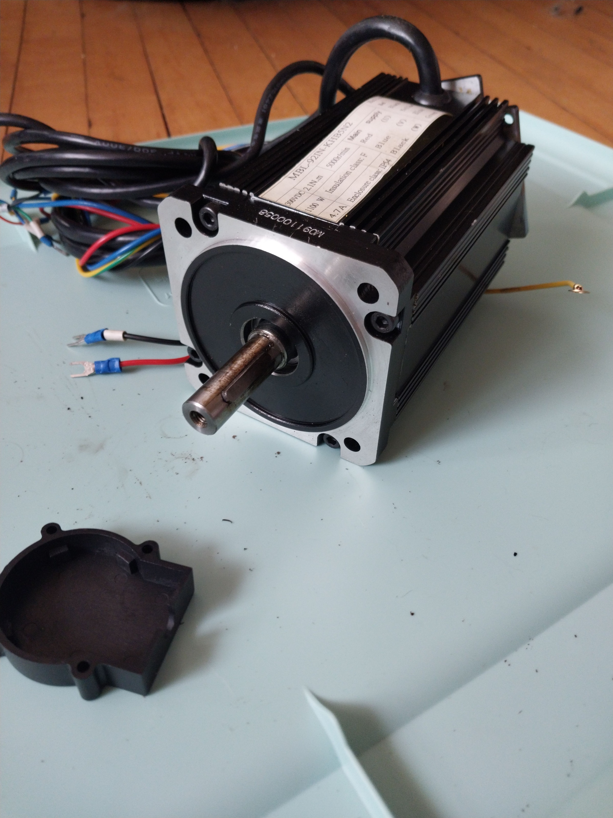

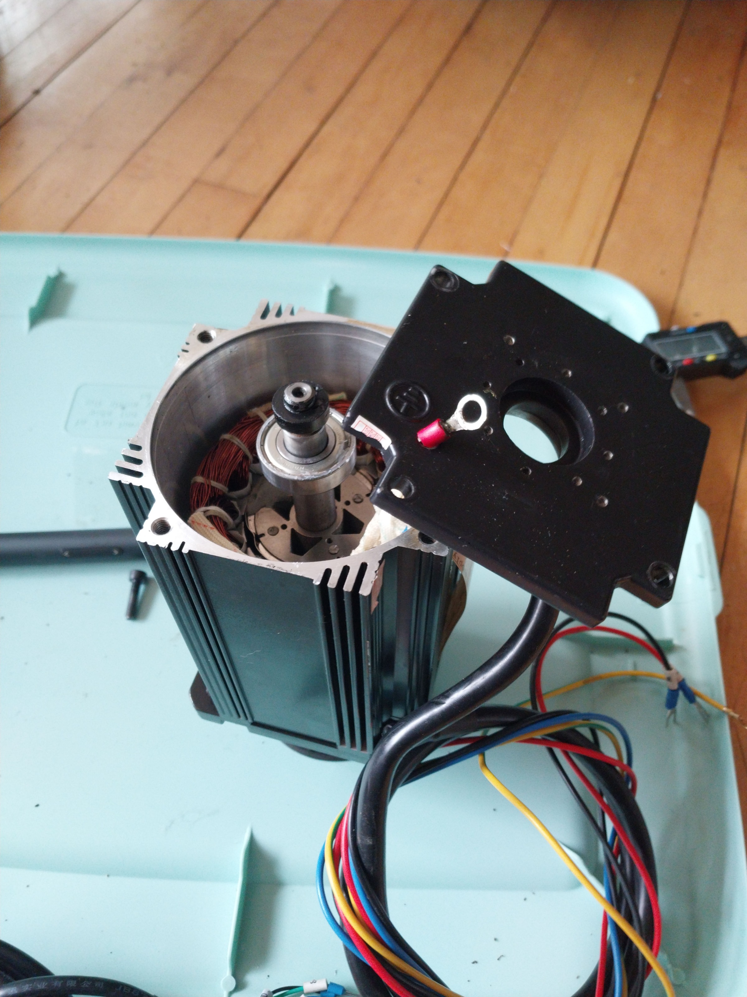

- Dave2024
- Posts: 58
- Thank you received: 10
01 May 2024 16:11 - 01 May 2024 16:58 #299510
by Dave2024
Replied by Dave2024 on topic Spindle Situation
How’s it going and good day spumco, so I took the spindle motor out of the machine and I’m taking a look at it to see if it will accept an encoder of some kind. I’ve never done this before but I kind of understand what its purpose is from all my research after you gave me the recommendation. The motor does have a sticker on it says it’s a 300v unit 4.7A with IP45 enclosure type. I take it you’ve done modifications like this before and are very knowledgeable so as I appreciate your helping me with this. My goal in the end is to have a control link through my existing LTP cable using LinuxCNC. I’m still not completely sure where to start though but understand that if I do find an encoder to fit the motor that I will also need a special motor drive (Of which I also am not sure where to start lol. Possibly the Allen Bradley Ultra 3000 or Copley Controls Xenus like you’ve mentioned) Also I was trying to remove the hall sensors cap cover on the motor but I’m not able to without potentially damaging the bushing/holder as it appears to be glued to the shaft. I did notice there’s a couple holes tapped on the cap cover that are potentially the rite size and dimensions to accept an encoder though. What do you suggest I should do? I’ve still got a lot to learn about this. Thanks. Ohh and also the shaft size in the front is 14mm and on the back hall sensor the shaft is size is much smaller 8mm
Edit: I just got the hall sensor off and the cover. (Cover probably wasn’t necessary lol) The hall sensor bushing pickup thing is still glued to the 8mm shaft though.
Last edit: 01 May 2024 16:58 by Dave2024.

Ok I got an AMT312C-V and a Allen Bradley 2098-DSD-010-SE ULTRA 3000 lined up in a cart. Should i pull the trigger you think? Also I posted some pictures on here at the bottom of the forum. Let me know what you think?
- spumco
- Posts: 2180
- Thank you received: 905
01 May 2024 19:53 #299520
by spumco
Replied by spumco on topic Spindle Situation
SLOW DOWN.
Don't buy anything yet.
First thing... you're trying to use the LPT port on a computer to output signals. I've never done that, so before you start buying stuff you need to get some more advice from some other folks here on what the LPT is capable of. It can't do analog signals, so you're left with step & direction.
Next, the Xenus can't use single-ended step & direction signals. Only differential, so I think that leaves the Xenus out of the running if you insist on using the LPT port(s).
The U3k can - I think - use single-ended S&D signals, but you should read the drive manual first. I've got a copy but it's too big to post here. Search the internets for it. Same thing for a free copy of the drive programming software (Ultraware), which also requires a Win PC.
Is there some reason you aren't using a Mesa board for your setup?
Have you priced out cables? Have you ever made a fiddly encoder cable? You'll need a cable from the encoder to the drive, plus a connector to attach it to the drive. Plus a cable from the drive to the LPT port (or other IO hardware).
I'm pointing this stuff out because you come across as rather excited at a potential solution... but this isn't trivial for a novice.
