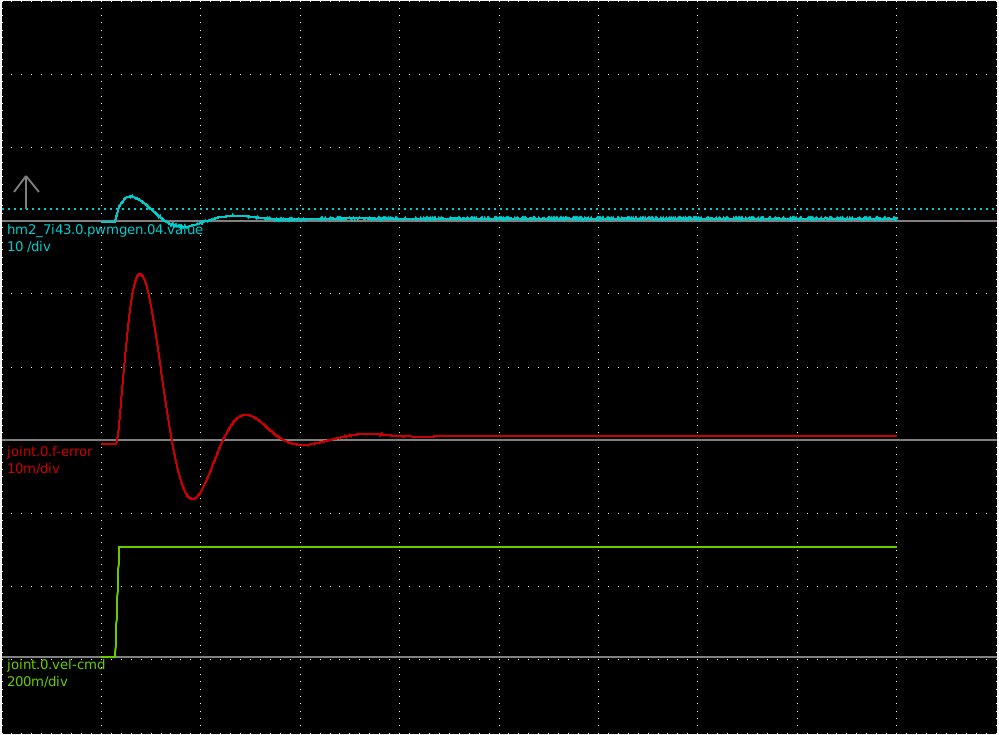

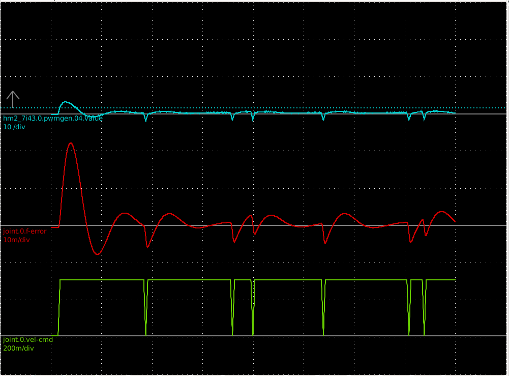

Something to keep in mind when you think you're going to lose your mind!
I spent a number of hours yesterday working on servo tuning and I wasted time with something I didn't expect. I kept seeing glitching in my f-error that I couldn't explain. After checking for mechanical issues (belt slip, loose mounts, etc.), on a whim I happened to try some moves from the MDI - and surprise, no more random glitching!
Long story short, it turns out key repeat was causing problems. It's easy to 'fix' by issuing an xset -r command to disable key repeat. There are other approaches as well, a forum search will turn up a few threads.
Here's what I was seeing with key repeat enabled. You can see the spikes in the velocity command. It really wreaks havoc on the f-error.
And when it's disabled, no more random glitches. Terrible servo tuning, but no glitches!
