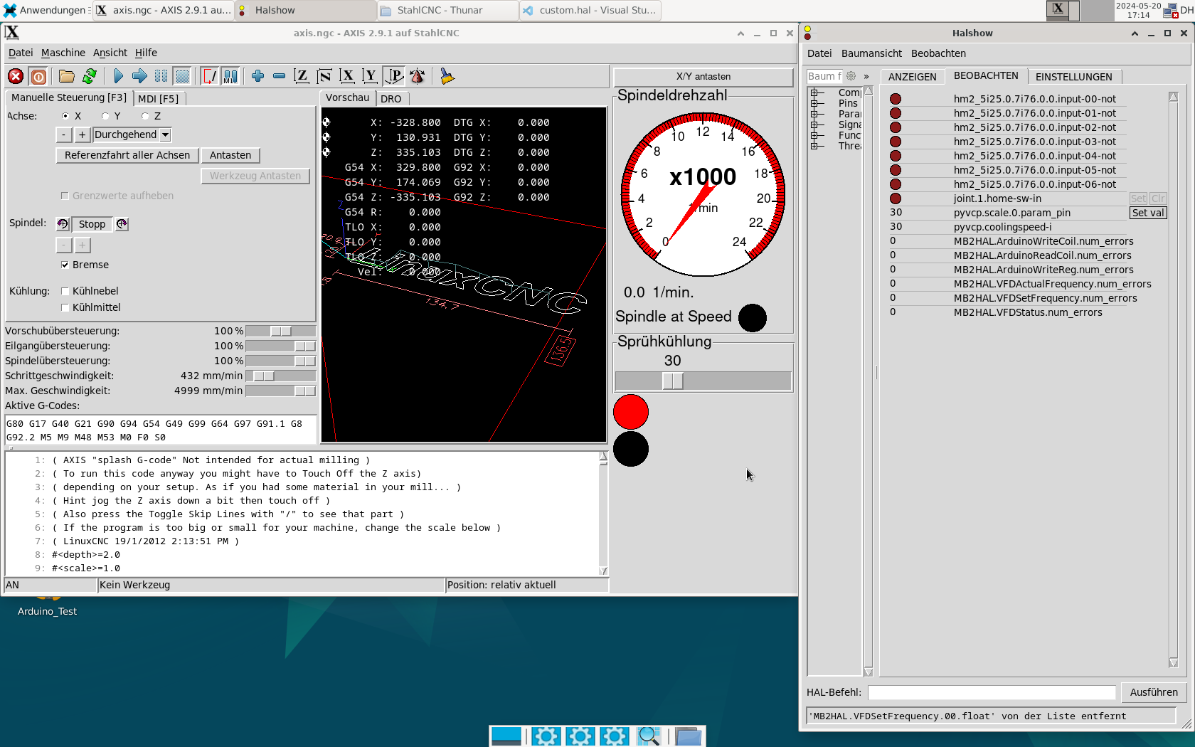

Hello,

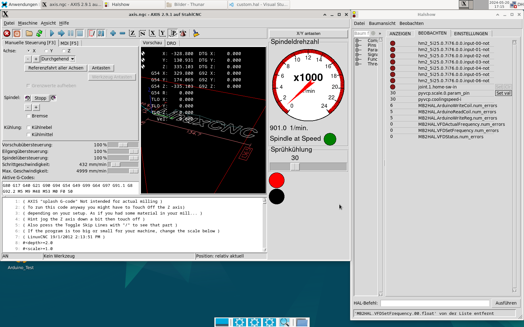

I used MB2HAL to communicate with my VFD for a long time already. I use a USB to RS485 converter on my PC and a 2-wire cable to the VFD.
Now I added an arduino to to the same line. The arduino is used to switch cooling and a vacuum cleaner on and off with M7 and M8 commands.
Everything works well, as long as the configuration takes care of one of both. I have a test configuration, which only talks to the arduino wich works fine, and the VFD also works on its own. But as soon as I combine both in one configuration, the problems are starting. I have attached two screenshots. The first one is the initial state. No errors, no problems.
When I then let the Spindle rotate, the increase of the spindle speed and the feedback has a delay of a couple of seconds and in the Halshow window you can see that the arduino has en error - see second screenshot. As soon as I stop the spindle, the error is gone.
With the spindle running, the M7/M8/M9 command don't reach the arduino. So, when I call M7 with the spindle running, my vacuum cleaner starts working just after I stopped the spindle.
Does anyone know, where the mistake is hidden? In the attachment, you can find the relevant configuration files.
Thanks for your help
Dominik

...today I changed my setup and connected the Arduino to a separate USB to RS485-adapter. The VFD is now connected to ttyUSB0 and the Arduino to ttyUSB1. This solved the problem that the VFD is reacting with a delay, Also, it is now possible to start the cooling while the spindle is running. However, the Arduino still has a delay and some errors occur.
By the way, I'm running LinuxCNC 2.9.2 .

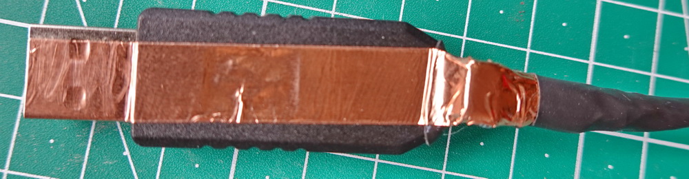

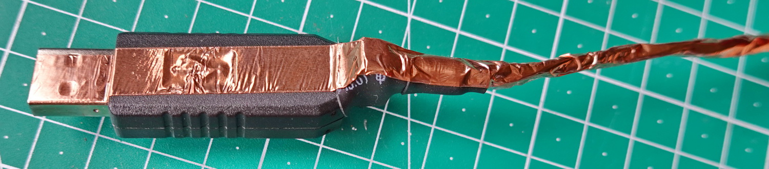

...guess you were right. Actually I used shielded wires (from an old network cable) but didn't ground them. Now, I connected them to the housing of the PC and added a ferrite choke on each end of the wire. At first, it didn't change anything. Then I played around with my VFD to start the spindle manually. With this, it worked ... put everything back to modbus ... and it still works
I think, I better not try to understand this. EMI is somehow voodoo to me and ruined already a few of my projects.
Many thanks for your advice!
