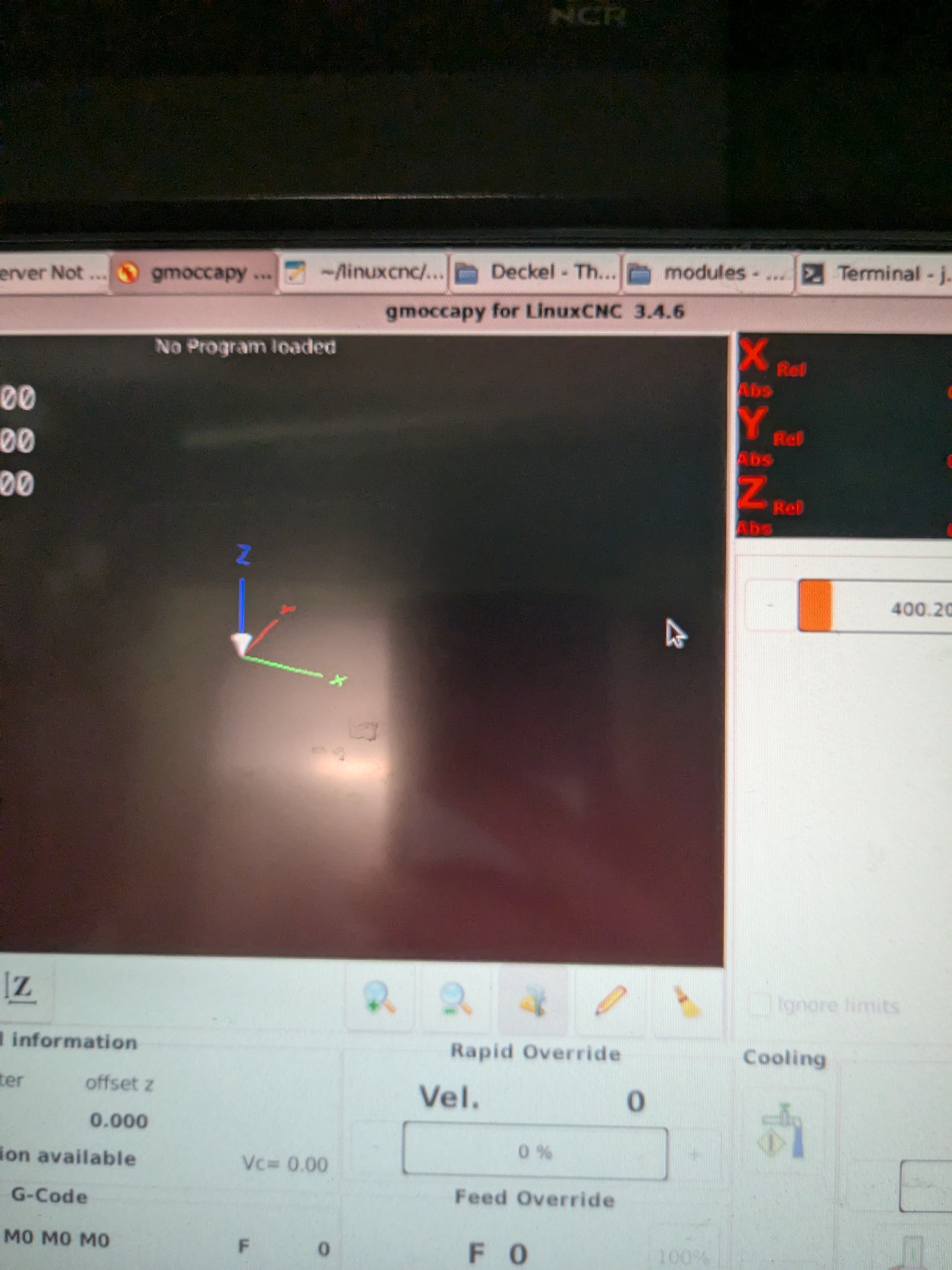

Replied by Aciera on topic Deckel FP4 Gearbox Comp
The pins starting with 'FP4-gearbox.' would likely be coming from a custom hal component. I cannot say for certain as I don't know which hal file you got this from.

Replied by Walkahz on topic Deckel FP4 Gearbox Comp
See attached Config files.
Possibly the Fp4_gearbox.hal??
Well I would have said 'FP4_gearbox.comp' but looking at the component itself has me confused as none of the component pins created seem to be used in the actual function:
Warning: Spoiler!
LinuxCNC component for controlling the Deckel FP4 gearbox.

08 Jul 2024 10:27 #304655
by Walkahz
Solved the boot issue.
Seems to be an issue with the line
Addf mh400e-gearbox. Servo-thread
Once I removed this from HAL I could boot normally again.
I attached the screen that was showing when it was bugging. See attached
- Posts: 4818
- Thank you received: 2176
08 Jul 2024 10:35 #304656
3.4.6 is the version of the GUI (Gmoccapy) not the version of linuxCNC
As for the 'mh400e-gearbox' component, this is likely because it is having trouble with the various .c and .h files it want to include. Unfortunately I'm not enough of a C programmer to provide assistance with setting that up correctly.
