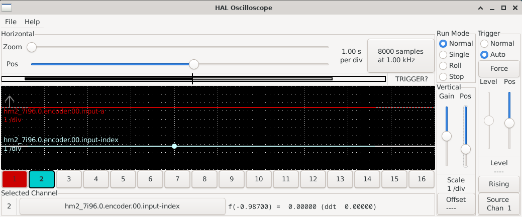

Hi, Im retrofitting a ZX7045. Im trying to get a encoder setup on my spindle.
I used pncconfig to setup the spindle encoder, but when I run the spindle i get no feedback on linuxcnc.
I tried using hal.scope but im seeing no activity. Same goes for hal show.
I have a oscilloscope connected between the encoder A and ground and I can see the signal there.
This is my first advance linuxcnc build, so I'm still figuring out how to edit .HAL and .INI directly.
I suspect my encoder is not configured correctly. I have attached my INI and HAL files.
Can someone see if I did something wrong in my configuration?

Im not qualified to be the one to answer this but if I could attempt it would be perhaps your encoder is single ended and your board is configured for differential input. If you wanted you could try moving the jumpers on W1, W2 , and W3 over to the left pins and try check if you get any data.
In Pncconf on the Spindle page if you also have the encoder correctly connected to the encoder port A,B,Z and GND then click the 'Open Loop Test' button it should display encoder feedback

Thank you, Yes, it works now. I can see rpm.
I thought it going to be something this stupid.
Jumper position, I did not think of jumper position.
Now I can move on to figuring out how to program my Speed/torque control.
Thank you. I have been banging my head against the wall for two weeks now trying to solve this. First thought it was EMI, so got a bunch of filter, shielded wire and earthed every thing on the machine. I even installed a second earthing rod in my house.
Lol all because a jumper position.

After checking that we can move on to other stuff, if any.
Replied by tommylight on topic 7i96 Splindle Encoder setup.
That would be the best answer right now, thank you.Im not qualified to be the one to answer this but if I could attempt it would be perhaps your encoder is single ended and your board is configured for differential input. If you wanted you could try moving the jumpers on W1, W2 , and W3 over to the left pins and try check if you get any data.
