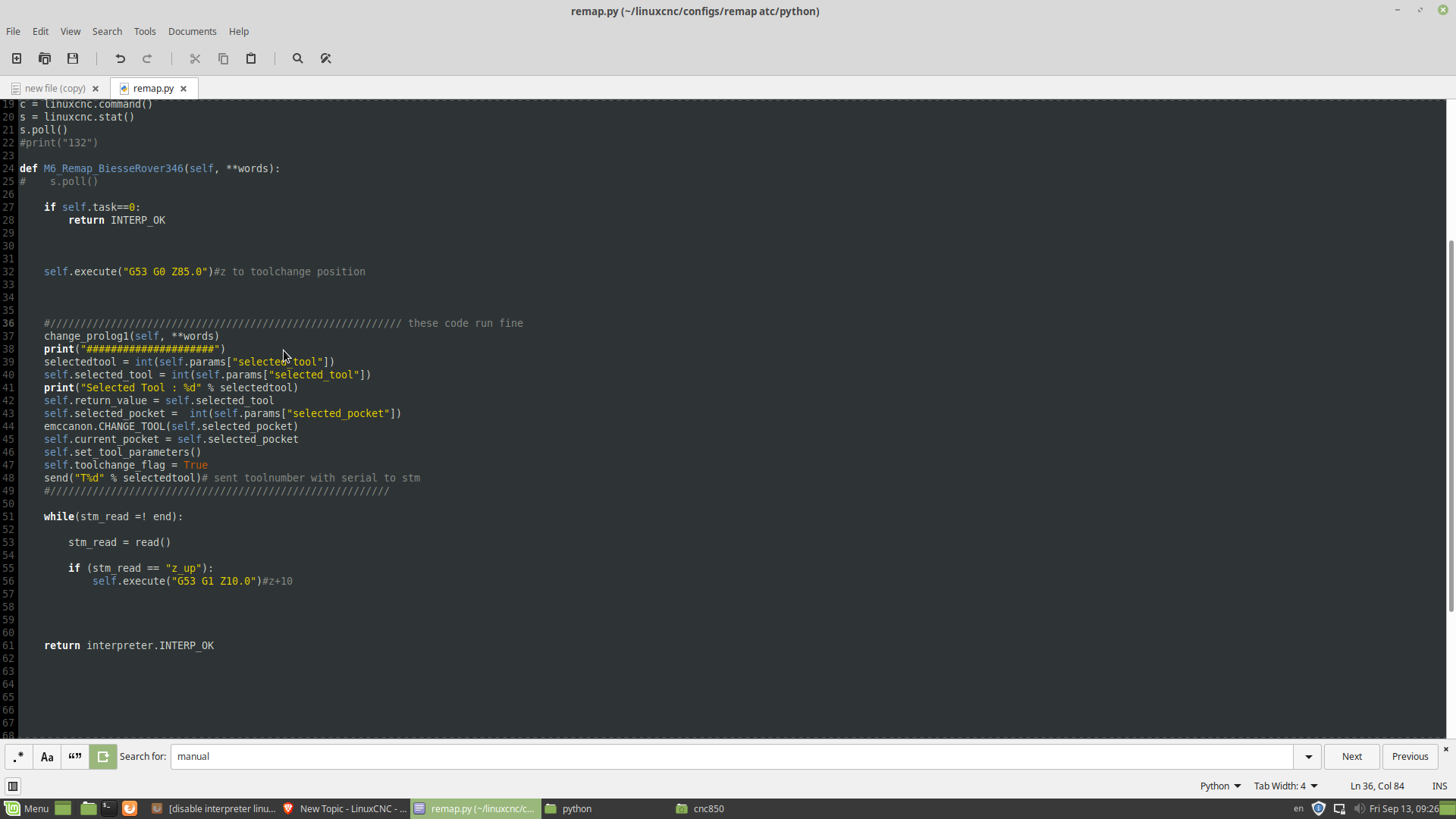

Hello everyone
I'm creating a toolchange with stm and I just can't solve this problem.
I have remapped the M6 so when it's reached, python will send tool number to my stm with serial and z will go to tool change position
Now I have to turn the spindle to correct position and stop it
Then I have to move z up a bit in a precise moment when tool is about to release(its when stm send "z up" to python)
Then again I have to move back Z to its previous position
Theses are the tasks must be done through linuxcnc
So I thought I could easily usecommand and sent some gcodes but it didn't work during toolchange
So I use and it worked well
But the other commands must wait for serial command.
I start writing a while loop so the code always get new serial and Execute the right command in its price moment, but when I write a while anywhere in python self.execute will not work and nothing happens
c.mdiSo I use
self.Execute("G53 G0 Z85.0") #z to start positionBut the other commands must wait for serial command.

Forto actually execute before the remap code is done you would have to have a quebuster like this right after it
However due to internal limitations we cannot call 'self.execute()' again after having used ' yield INTERP_EXECUTE_FINISH' so your current approach won't work.
My usual workaround is to call the python remap code through an ngc wrapper and split the python code into multiple functions. With this approach you have much more freedom in inserting queuebuster commands in the python remap and in the ngc wrapper (eg M66 E0 L0).
So in your example:
I would remove 'self.Execute("G53 G0 Z85.0") #z to start position' and instead of directly calling 'M6_Remap_BiesseRover346' I would call an ngc routine like this:
self.Execute("G53 G0 Z85.0") #z to start positionyield INTERP_EXECUTE_FINISHHowever due to internal limitations we cannot call 'self.execute()' again after having used ' yield INTERP_EXECUTE_FINISH' so your current approach won't work.
So in your example:
G53 G0 Z85
M66 E0 L0
<call the python remap here>

I send "z_up" with stm with serial and in exact moment I need z axis to go up
I'm confused how I'm supposed to do it based on your statement.

Python does not run in real time so for timing critical things a python remap is not really what you want to use in the first place. You would be much better off using a compiled real time component (ie .c or .comp) that could export stm state as hal pins.I send "z_up" with stm with serial and in exact moment I need z axis to go up

Some thoughts.
As for getting data to/from your STM, here is a project using STM, that may (or may not) give you some ideas:
github.com/scottalford75/Remora
Also with the 'external offset' feature you could move your Z axis without using Gcode but entirely from HAL.
linuxcnc.org/docs/stable/html/motion/external-offsets.html
