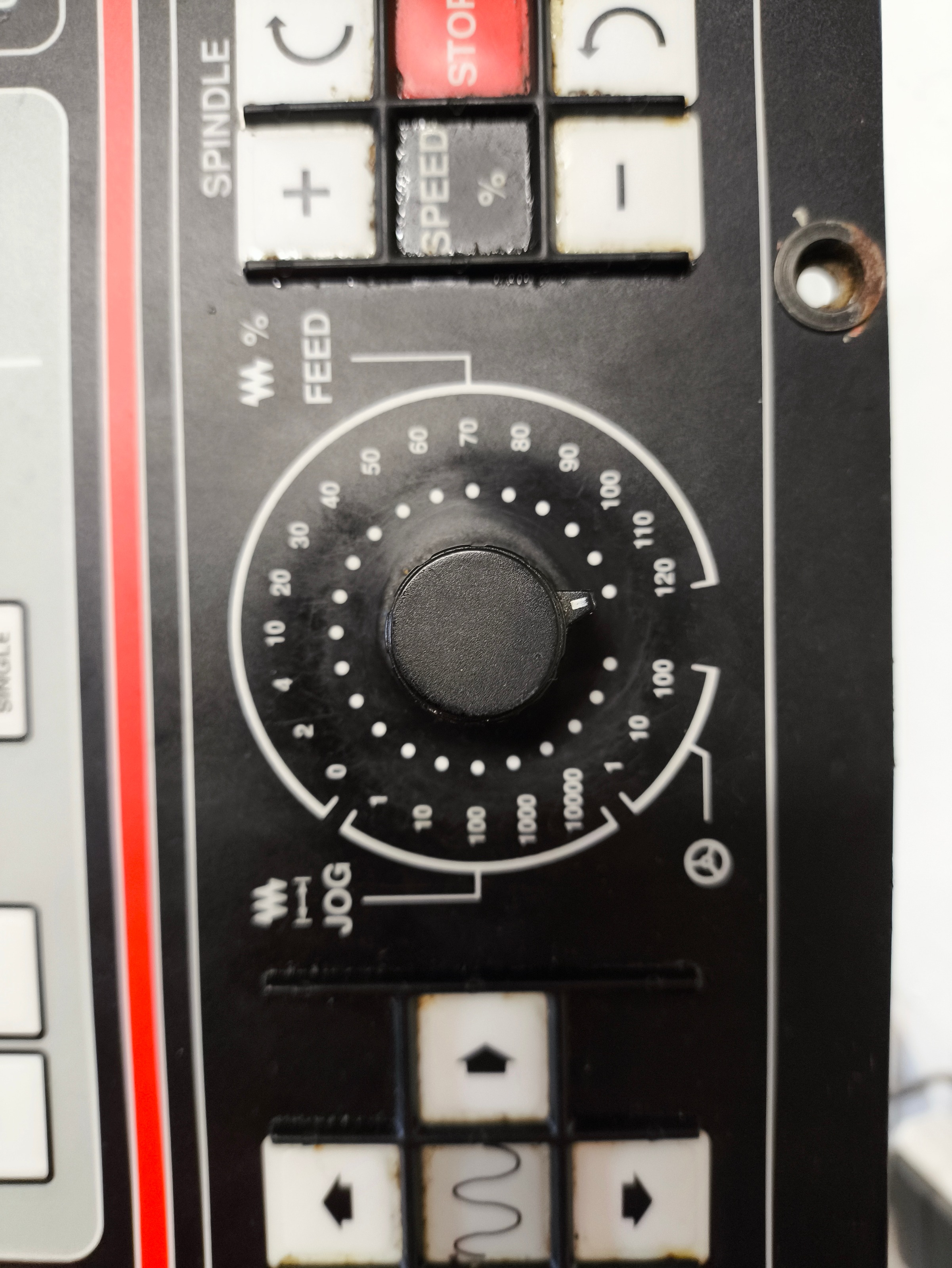

How to configure this knob?
- vibram
- Posts: 84
12 Oct 2024 19:26 #311890
by vibram
How to configure this knob? was created by vibram
- Posts: 21957
- Thank you received: 7478
12 Oct 2024 19:32 #311893
Replied by tommylight on topic How to configure this knob?
How many wires? How is it wired? To what is it wired?
- vibram
- Posts: 84
12 Oct 2024 19:36 #311894
by vibram
Replied by vibram on topic How to configure this knob?
6 wires
As of today I received a value in linuxcnc from 1 to 31, from a Grey code. But what to do with this value?
- COFHAL
- Posts: 461
- Thank you received: 62
13 Oct 2024 00:41 #311909
by COFHAL
Replied by COFHAL on topic How to configure this knob?
How did you make the connection to receive those values?
- Benb
- Posts: 184
- Thank you received: 61
13 Oct 2024 00:48 #311910
by Benb
Replied by Benb on topic How to configure this knob?
Linuxcnc wiki has examples for wheels/pendants ..., have look at the section adding external controls.
wiki.linuxcnc.org/cgi-bin/wiki.pl
- COFHAL
- Posts: 461
13 Oct 2024 00:49 - 13 Oct 2024 00:59 #311911
by COFHAL
Use MUX_GENERIC and connect the output through a signal to halui.feed-override.counts and halui.jog-speed
