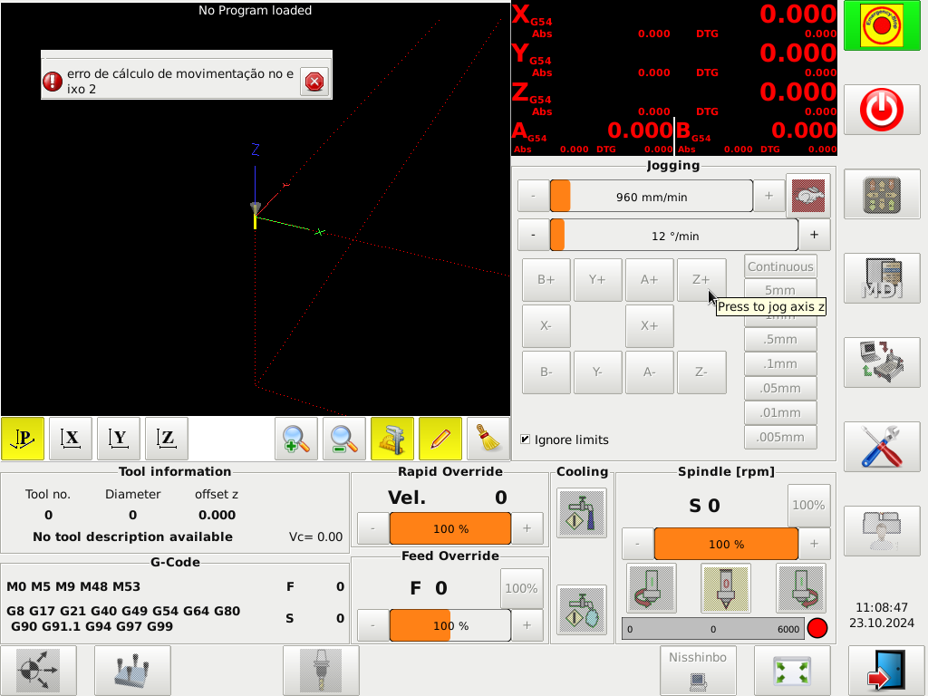

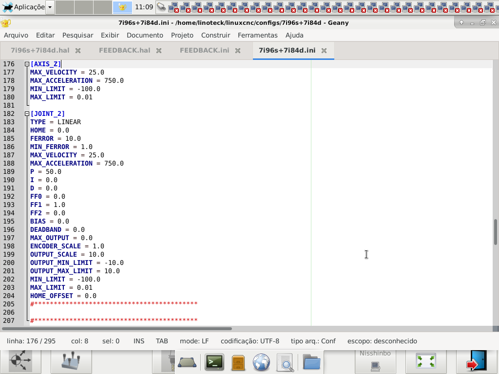

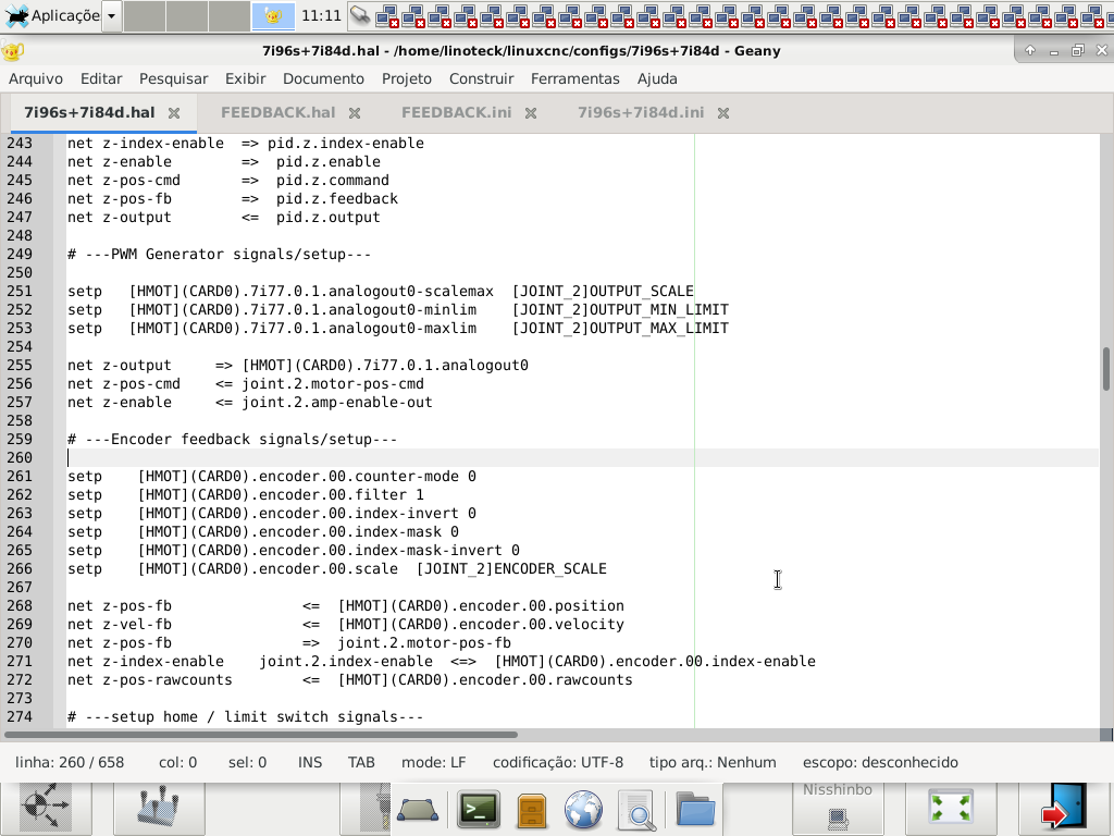

Good afternoon everyone
Can you please help me with how to configure the Z axis drive and recognize the THCAD2 as an encoder? I have tried several times without success.
When trying to move the axis, an error appears calculating the movement of the Z axis.
This is the INI file type configuration
this is the HAL type file configuration
Please, can someone guide me?
INI and HAl files attached
