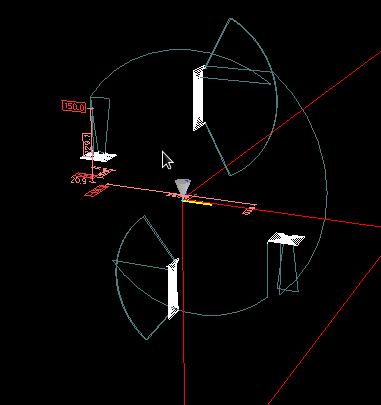

I have added rotary axis (workpiece rotates) to my 5-axis machine (BC head). I created separate config, as I want to run it as an "ordinary 3-axis" machine with 4th axis. So, configuration is changed in the way that all axis are homing but then after I use only XYZ and rotary B (as it is parallel to Y).
Machine works OK, only thing that is causing me problem now is preview of toolpath as it is not wrapped around Y.
Here is how it is programmed:
https://i.ibb.co/RYt6Vfc/ROTAR-CAM.jpg"
And how it is displayed:
https://i.ibb.co/hDnfNkF/ROTARY-DISPLAY.jpg"

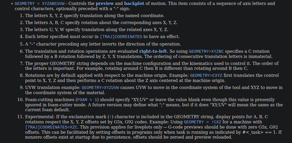

Don't know what Version you are running but the toolpath preview does not 'wrap' around by default. There is a somewhat experimental setting for the [DISPLAY] GEOMETRY, so maybe tryThere are some caveats to this, see point 11 below:
linuxcnc.org/docs/html/config/ini-config...#sub:ini:sec:display
GEOMETRY = !BXYZlinuxcnc.org/docs/html/config/ini-config...#sub:ini:sec:display

06 Nov 2024 14:02 #313907
Replied by tommylight on topic Rotary axis Display
From the pictures it seems your CAM is outputting strange positions as everything is out of machine limits, it uses center coordinates as it seems.
Probably should check that first.
- tommy
- Posts: 106
- Thank you received: 3
08 Nov 2024 09:35 - 08 Nov 2024 09:36 #314068
by tommy
Replied by tommy on topic Rotary axis Display
I hope this video will make more clear what is happening, I have no issue with g-code from CAM, machined parts are ok, only display section is a bit off in my case:
Last edit: 08 Nov 2024 09:36 by tommy.
- Posts: 4819
- Thank you received: 2177
08 Nov 2024 10:24 #314070
This issue is a known limitation of the feature. Please read paragraph 11 the documentation I posted above.
Replied by Aciera on topic Rotary axis Display
but after applying G54 on X, it becomes a mess:

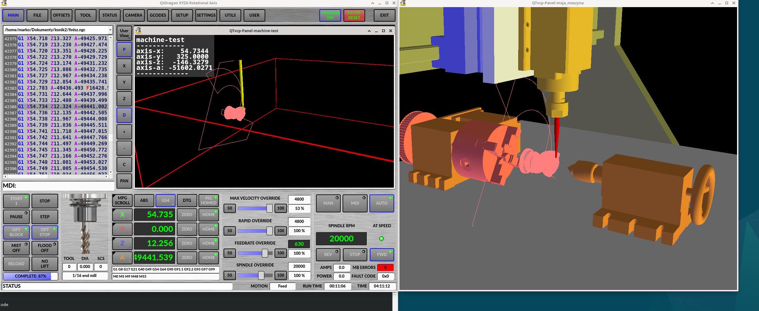

09 Nov 2024 02:47 #314107
by MarkoPolo
Replied by MarkoPolo on topic Rotary axis Display
You can try to make a preview window with QtVismach. In Vismach the rotation axis displays well. I quickly made a window that is overlaid on qtdragon , as in the screenshot. You would have to work on displaying the gcode preview, but it would probably be useful.
- COFHAL
- Posts: 461
- Thank you received: 62
07 Nov 2025 19:23 #338045
by COFHAL
Replied by COFHAL on topic QtVismach file
Could you share your QtVismach file?
- MarkoPolo
- Posts: 319
- Thank you received: 90
07 Nov 2025 21:56 #338058
by MarkoPolo
Replied by MarkoPolo on topic QtVismach file
Try it out.This should draw the tool, detect your machine's workspace, and correctly map the A-axis rotation.Copy the entire directory to "/usr/share/qtvcp/panels" and run "qtvcp machine-test"
