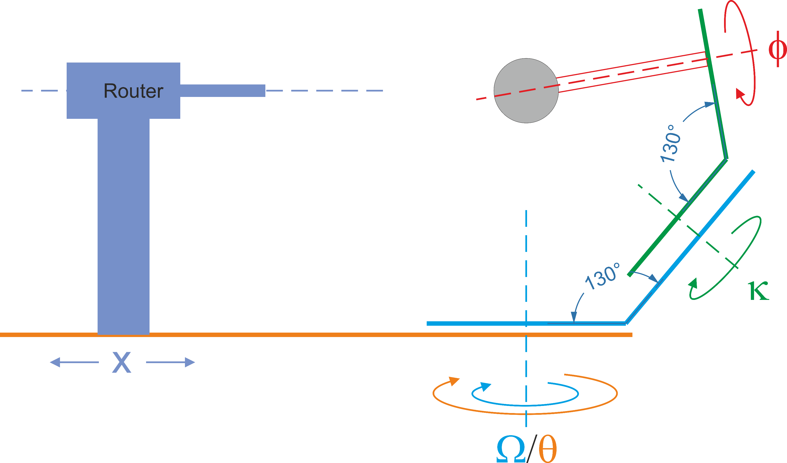

I have an old kappa-goniostat (crystallography) that should be disposed and it's breaking my heart. It has 3 rotational axis for the sample in middle of the goniometer and an additional rotation+translation axis where originally detector was mounted.
I had this crazy idea that one could use it to work on spheric shapes in the wood (think about Escher's "Angels and Devils").
Two main problems:
1) I'm newbie to linuxCNC
2) goniometer has a strange geometry. I've attached image how it works.
The object rotates in center of system with three axis omega, kappa and phi. The kappa-angle is 50° to base (or 130°).
I tried to read examples about 5-axis geometry but all of them describe systems with orthogonal axis.
Any suggestions on how I should start this project? I have no idea how to tackle kinematics.
And before I spend hours reverse engineering encoders on DC motors, I need to know whether it is actually possible with LinuxCNC.
all best, Kris

Hm, interesting. It might be worth considering an issue that usually only pops up once the machine is finished which is: How are you going to create gcode for this?

As I understand it there is one linear and four rotary axes which is not one of the traditional 5axis kinematics (ie 3 linear and 2 rotary).

yepp, 4 rotary axis around center of the universe and one translation.
