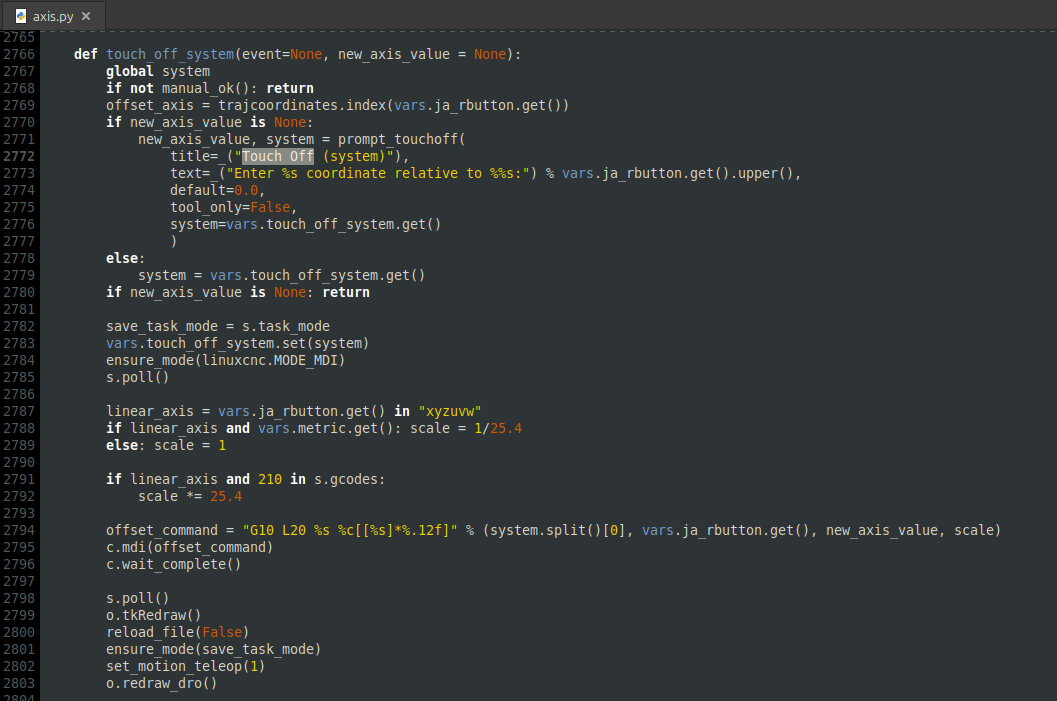

So my main problem is when I use "tool touch off" or "touch off" button sometimes randomly it starts tool change process and
net tool-change-request control. 0.tool-change => hm2_7i96.0.gpio.022.out
this pin supposed to become output when we are doing tool change
But suddenly out of nowhere its stuck and don't do anything
So I came up with the idea of adding
if (s. task_mode == 2):
At my Tool change remap
this solution fixes my problem but I no longer can use MDI and its mean I only can do tool change when its running a G-code in auto mode.
What do you suggest?
Do you know why this happened or how to solve it? I tried to create a tab and put some button
and execute tool change commands but as you said it's impossible
That sounds pretty crazy, I've never heard of anything like this. What GUI are you using?
I think I would want to find the reason for that before doing anything else.

i'm using axis
29 Jan 2025 13:06 #320083 by Aciera
Replied by Aciera on topic change tool commend with button
The 'Touch Off' and 'Tool Touch Off' buttons create an MDI call with an G10 L... command through the python interface. I'm afraid I have no idea how that could randomly start a tool change process in your config.
