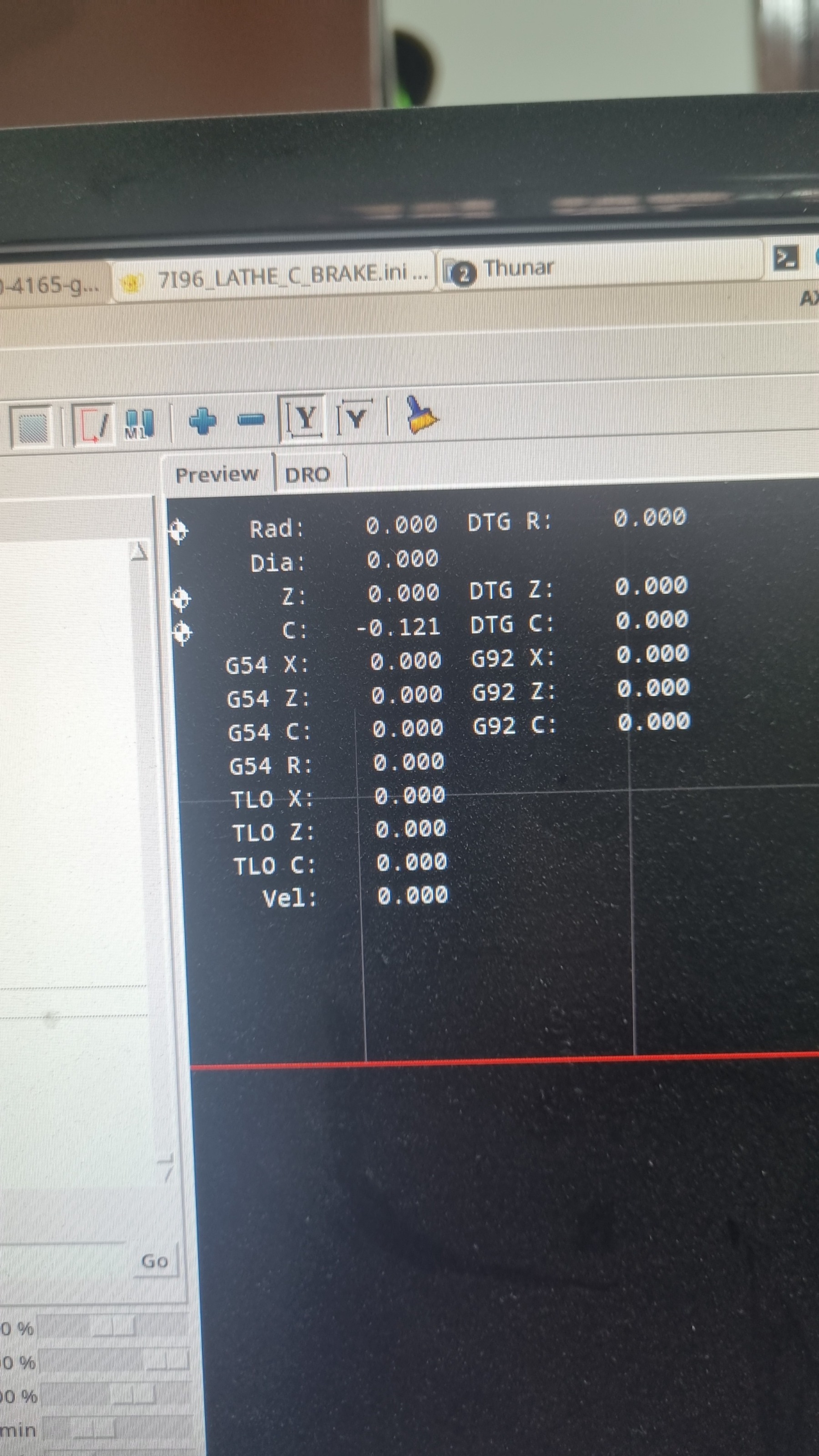

Hello,
I have a little lathe that was originally using a bldc motor. I wanted to change it out with a servo motor and use it both in positional mode, but also with turning. I went through the basic configurations in pncconf using my mesa 7i96s and got it to work as a turning machine with a stepgen spindle.
I read about the possibility of using mux2 to switch between the two modes but I am stuck getting strange errors like command 176, etc. I cant figure out how to debug or what I need to change in my INI and HAL (I have two hal files I am using). I am wondering if someone could look over my files and see if I am missing something obvious? I keep staring at it and am getting nowhere...
I config'd it as an XZ lathe with stepgen spindle originally. I have to HAL files I use: C+turning and the mux HAL
My current issue is as follows: The program compiles and opens. I then home axis, which causes my X and Z axis to home. I can now move those freely. However, when I go to try and move the C axis, I get "error on joint 2" and on terminal it just gives all sorts of "command" errors that I cant seem to debug further. Has anyone experienced this?
Main HAL:
Auxillary HAL
INI FILE
Main HAL:

# ---manual tool change signals---
net tool-change-request <= iocontrol.0.tool-change
net tool-change-confirmed => iocontrol.0.tool-changed
net tool-number <= iocontrol.0.tool-prep-number
# ---Use external manual tool change dialog---
net tool-change-request => hal_manualtoolchange.change
net tool-change-confirmed <= hal_manualtoolchange.changed
net tool-number => hal_manualtoolchange.number
# ---ignore tool prepare requests---
net tool-prepare-loopback iocontrol.0.tool-prepare => iocontrol.0.tool-preparedAuxillary HAL
# Include your custom HAL commands here
# This file will not be overwritten when you run PNCconf again
loadrt mux2 count=1
addf mux2.0 servo-thread
# Mux inputs
net c-axis-pos-cmd joint.2.motor-pos-cmd => mux2.0.in0
net spindle-vel-cmd-rpm => mux2.0.in1
net spindle-enable => mux2.0.sel
net spindle-enable => hm2_7i96s.0.stepgen.04.enable
# Mux output to stepgen.04
net mux-out mux2.0.out => hm2_7i96s.0.stepgen.04.position-cmd
# Feedback and enable
net c-pos-fb <= hm2_7i96s.0.stepgen.04.position-fb
net c-pos-fb => joint.2.motor-pos-fbINI FILE
# Generated by PNCconf at Wed Apr 2 16:24:00 2025
# Using LinuxCNC version: Master (2.9)
# overwritten when you run PNCconf again
[EMC]
MACHINE = Turn+C_lathe
DEBUG = 0
VERSION = 1.1
[DISPLAY]
DISPLAY = axis
POSITION_OFFSET = RELATIVE
POSITION_FEEDBACK = ACTUAL
MAX_FEED_OVERRIDE = 2.000000
MAX_SPINDLE_OVERRIDE = 1.000000
MIN_SPINDLE_OVERRIDE = 0.500000
INTRO_TIME = 5
PROGRAM_PREFIX = /home/maksym/linuxcnc/nc_files
PYVCP = pyvcp-panel.xml
INCREMENTS = 5mm 1mm .5mm .1mm .05mm .01mm .005mm
LATHE = 1
DEFAULT_LINEAR_VELOCITY = 13.333333
MAX_LINEAR_VELOCITY = 41.666667
MIN_LINEAR_VELOCITY = 0.500000
DEFAULT_ANGULAR_VELOCITY = 12.000000
MAX_ANGULAR_VELOCITY = 180.000000
MIN_ANGULAR_VELOCITY = 1.666667
EDITOR = gedit
GEOMETRY = xyz
CYCLE_TIME = 100
[FILTER]
png = image-to-gcode
gif = image-to-gcode
jpg = image-to-gcode
py = python
[TASK]
TASK = milltask
CYCLE_TIME = 0.010
[RS274NGC]
PARAMETER_FILE = linuxcnc.var
RS274NGC_STARTUP_CODE = G21 G40 G90 G94 G97 G64 P0.025
[EMCMOT]
EMCMOT = motmod
COMM_TIMEOUT = 1.0
SERVO_PERIOD = 1000000
[HMOT]
# **** This is for info only ****
CARD0=hm2_7i96s.0
[HAL]
HALUI = halui
HALFILE = Turn+C_lathe.hal
HALFILE = c_axis_mux.hal
HALFILE = custom.hal
POSTGUI_HALFILE = custom_postgui.hal
SHUTDOWN = shutdown.hal
[HALUI]
[KINS]
JOINTS = 3
KINEMATICS = trivkins coordinates=XZC
[TRAJ]
COORDINATES = XZC
LINEAR_UNITS = mm
ANGULAR_UNITS = degree
DEFAULT_LINEAR_VELOCITY = 4.17
MAX_LINEAR_VELOCITY = 41.67
NO_FORCE_HOMING = 1
[EMCIO]
EMCIO = io
CYCLE_TIME = 0.100
TOOL_TABLE = tool.tbl
[AXIS_X]
MAX_VELOCITY = 41.666666666666664
MAX_ACCELERATION = 500.0
MIN_LIMIT = -0.0
MAX_LIMIT = 100.0
[JOINT_0]
TYPE = LINEAR
HOME = 20.0
FERROR = 10.0
MIN_FERROR = 1.0
STEPGEN_MAXVEL = 52.08
STEPGEN_MAXACCEL = 625.00
P = 1000.0
I = 0.0
D = 0.0
FF0 = 0.0
FF1 = 1.0
FF2 = 0.0
BIAS = 0.0
DEADBAND = 0.0
MAX_OUTPUT = 0.0
# these are in nanoseconds
DIRSETUP = 10000
DIRHOLD = 10000
STEPLEN = 10000
STEPSPACE = 10000
STEP_SCALE = -800.0
MIN_LIMIT = -0.0
MAX_LIMIT = 100.0
HOME_OFFSET = 0.000000
HOME_SEARCH_VEL = -13.333333
HOME_LATCH_VEL = -0.500000
HOME_FINAL_VEL = 5.000000
HOME_USE_INDEX = NO
HOME_IGNORE_LIMITS = YES
HOME_SEQUENCE = 2
[AXIS_Z]
MAX_VELOCITY = 25.0
MAX_ACCELERATION = 750.0
MIN_LIMIT = -432.0
MAX_LIMIT = 0.0
[JOINT_1]
TYPE = LINEAR
HOME = -20.0
FERROR = 10.0
MIN_FERROR = 1.0
MAX_VELOCITY = 25.0
STEPGEN_MAXVEL = 31.25
STEPGEN_MAXACCEL = 937.50
P = 1000.0
I = 0.0
D = 0.0
FF0 = 0.0
FF1 = 1.0
FF2 = 0.0
BIAS = 0.0
DEADBAND = 0.0
MAX_OUTPUT = 0.0
DIRSETUP = 10000
DIRHOLD = 10000
STEPLEN = 10000
STEPSPACE = 10000
STEP_SCALE = 800.0
MIN_LIMIT = -432.0
MAX_LIMIT = 0.0
HOME_USE_INDEX = NO
HOME_SEQUENCE = 1
[AXIS_C]
MAX_VELOCITY = 360
MAX_ACCELERATION = 720
MIN_LIMIT = -999999
MAX_LIMIT = 999999
ANGULAR = 1
[JOINT_2]
TYPE = ANGULAR
HOME = 0
FERROR = 5
MIN_FERROR = 1.0
MAX_VELOCITY = 360
STEPGEN_MAXVEL = 400
STEPGEN_MAXACCEL = 800
P = 1000.0
I = 0.0
D = 0.0
FF0 = 0.0
FF1 = 1.0
FF2 = 0.0
BIAS = 0.0
DEADBAND = 0.0
MAX_OUTPUT = 0.0
DIRSETUP = 10000
DIRHOLD = 10000
STEPLEN = 5000
STEPSPACE = 5000
STEP_SCALE = 27.77778
HOME_SEQUENCE = 0
[SPINDLE_0]
MAX_VELOCITY = 3.3333333333333335
MAX_ACCELERATION = 300.0
STEPGEN_MAXVEL = 4.17
STEPGEN_MAXACCEL = 375.00
P = 0.0
I = 0.0
D = 0.0
FF0 = 1.0
FF1 = 0.0
FF2 = 0.0
BIAS = 0.0
DEADBAND = 0.0
MAX_OUTPUT = 2000.0
ENCODER_SCALE = 8000.0
DIRSETUP = 10000
DIRHOLD = 10000
STEPLEN = 5000
STEPSPACE = 5000
STEP_SCALE = -1000.0Please Log in or Create an account to join the conversation.
