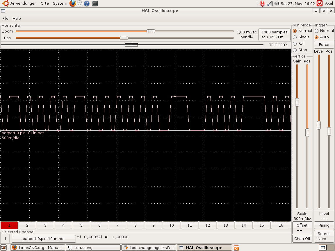

I found the reason for this error with the hal-meter:
If the "probe-switch" is open I've a clear FALSE if the switch is closed it toggles between FALSE and TRUE even if I press the switch so that I'm sure he's not at the break over point. And also with a second switch. I've already send the signal through an low-pass filter so I'm 99% sure that hardware couldn't be the reason.
Any Ideas?
Any Ideas?

It could be electrical noise. Exactly how is the switch wired, and to what?
What does the probe signal look like in Halscope?
If you are in the axis UI then it is Machine -> Halscope.

Ok i found the reason, my paralell-port has internel pullups, so if my switch was closed there was a current backwards through my lowpass causing 1,8V drop, an thats no clear signal.
EDIT: G38.5 works fine

You could probably remove the lowpass and use the "debounce" function in HAL.
www.linuxcnc.org/docview/html//man/man9/debounce.9.html
I think that probe moves towards the indicated position. You might need a G53 on the same line as the probe command.

debounce needs to be added to the hal file. The process is much the same for any HAL component.
1) load the component:This loads a 1 channel debounce called debounce.0
2) Make the debounce function run in the base thread:
3) set the debounce time:
4) put the debounce between the parport and the probe input
loadrt debounce cfg=12) Make the debounce function run in the base thread:
addf debounce.0 base-thread3) set the debounce time:
setp debounce.0.delay 104) put the debounce between the parport and the probe input
net probe-raw parport.0.pin-10-in-not => debounce.0.0.in
net probe-filtered debounce.0.0.out => motion.probe-input
The following user(s) said Thank You: Sadmeatball
