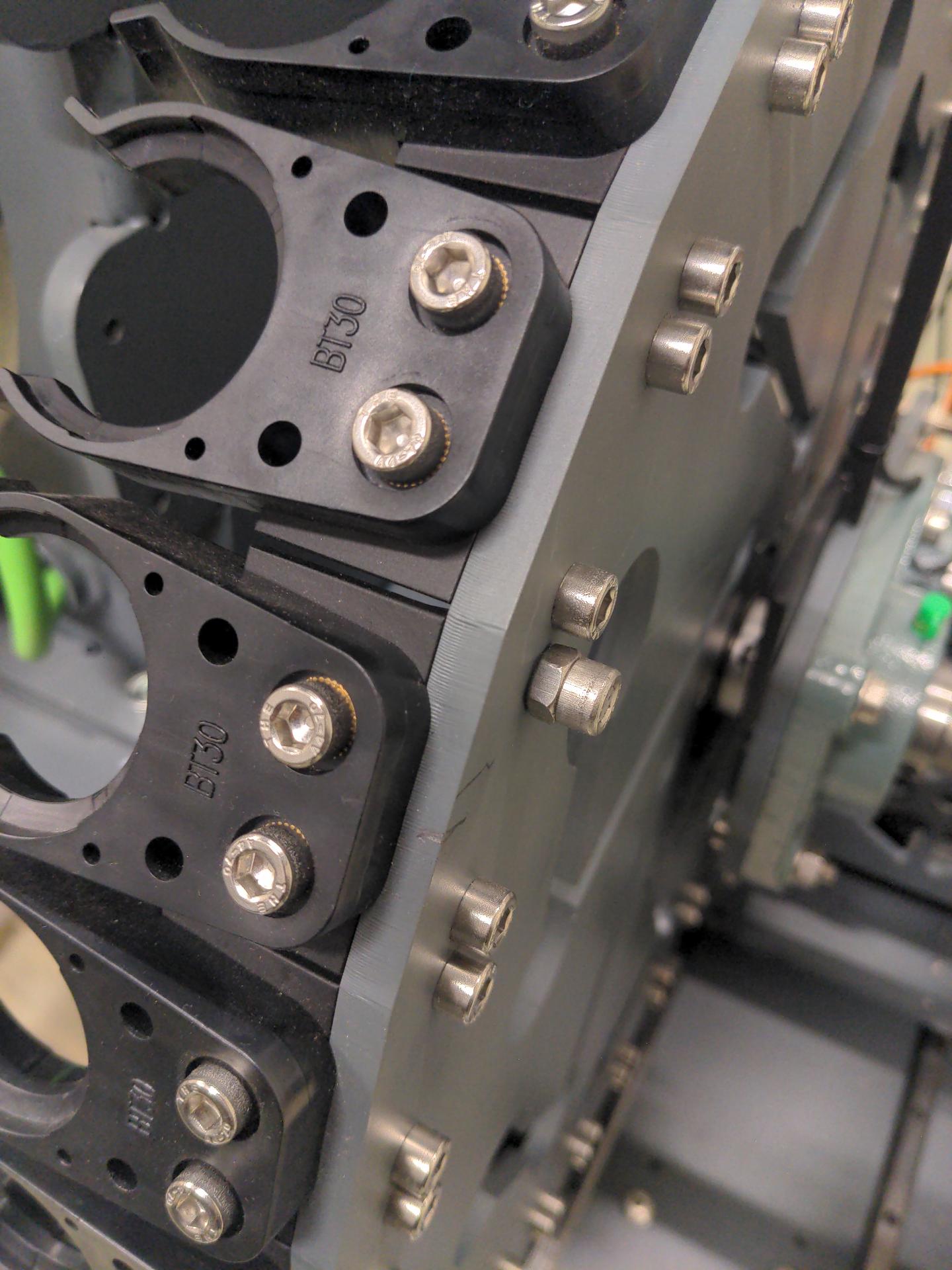

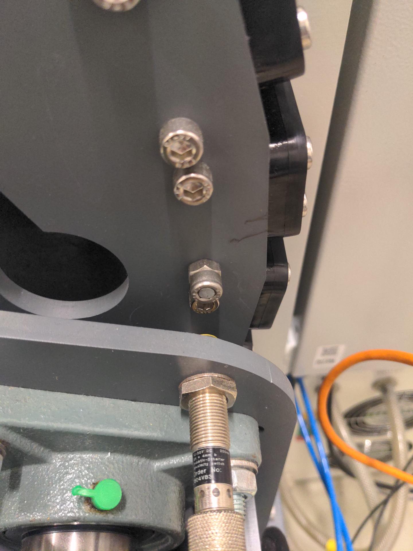

The ATC has one sensor (inductive). One bolt is longer, so it is used as a reference (pocket 1).

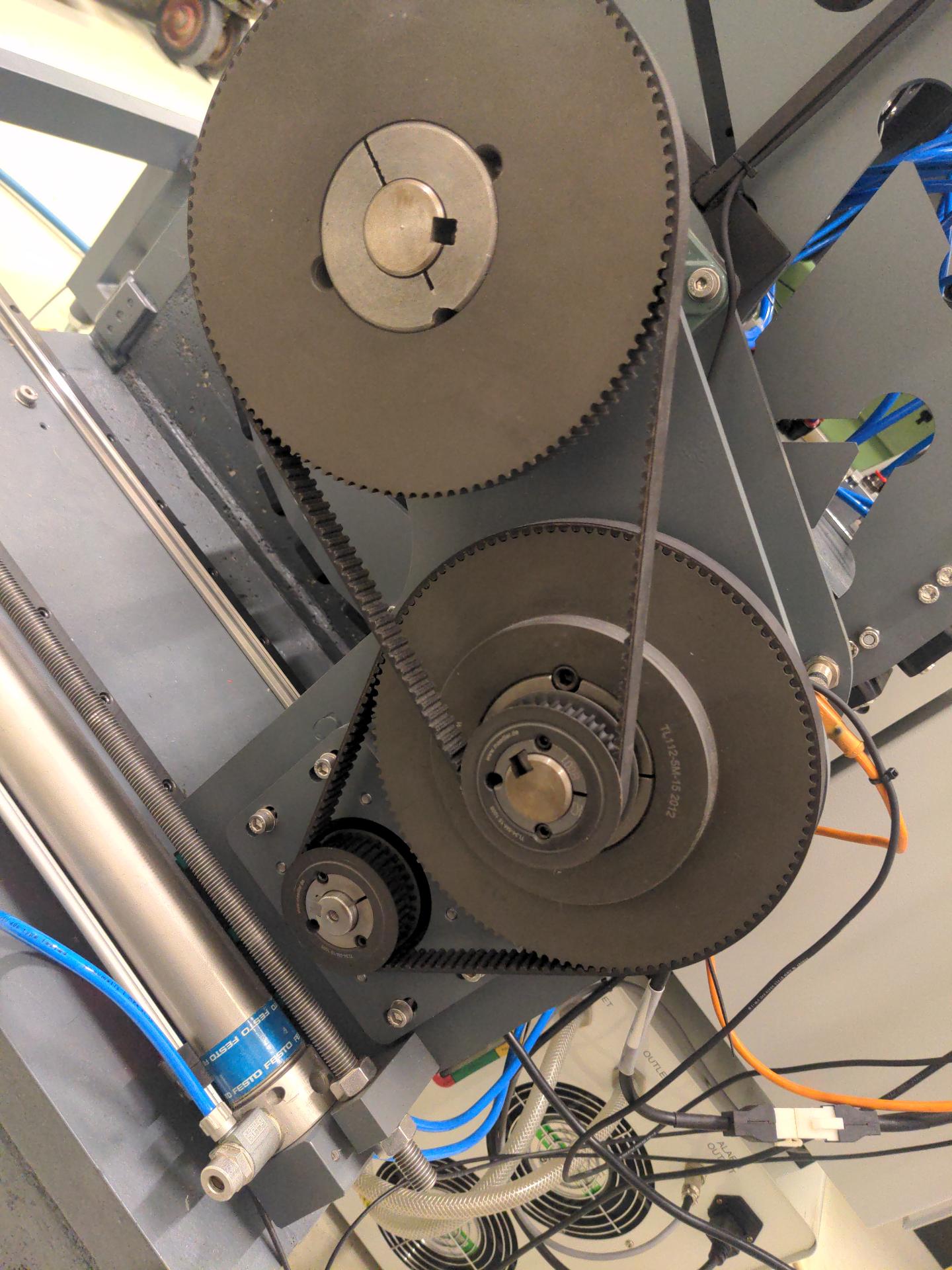

The other bolts have no effect to the sensor.The disk is driven by a servomotor (JMC 750W, analog input velocity mode)—it's connected to a 7i97.I have encoder counts from the motor as feedback.The linear move toward the spindle is done by a pneumatic cylinder.
this is how it should work :
The ATC moves pneumatically into the working area. The disk rotates to the corresponding tool pocket, and then the main spindle retrieves the tool.

You should be able to use the inductive sensor for the index pulse. (but you seemed to be saying that that was seen multiple times per magazine rev?)
In counts mode with the carousel .comp, with the right scaling, you should be able to use the encoder counts.
