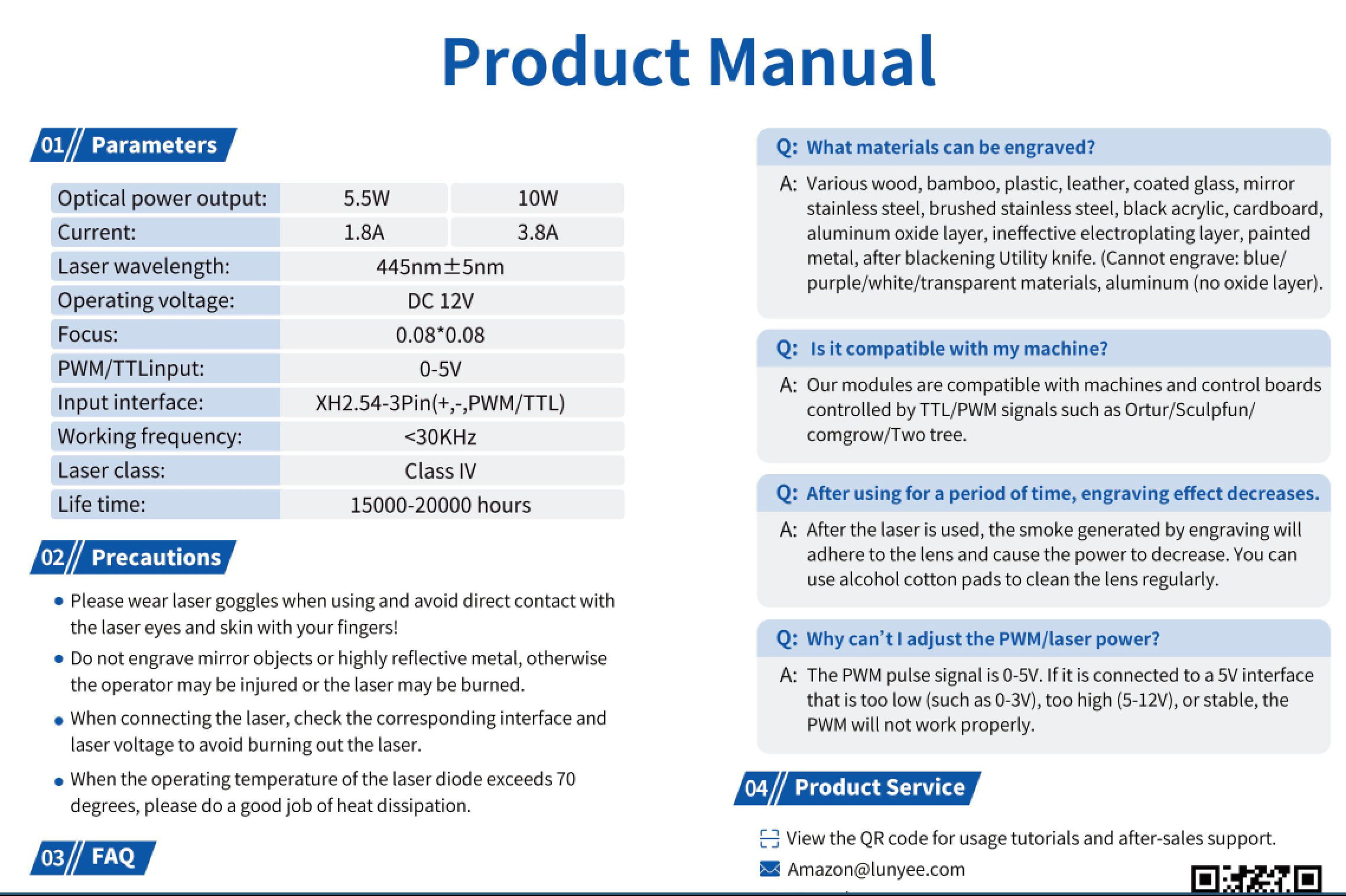

The scenario is as follows: there is a laser, controlled by PWM via LPT. It has been proven that the laser itself works. It has been proven that PWM also works (because we control the spindle through it).
The documentation indicates that we must set several mandatory parameters. It would seem that this is sufficient.
linuxcnc.org/docs/2.8/html/man/man9/pwmgen.9.html
forum.linuxcnc.org/media/kunena/attachme...19092/FRANKENLAB.hal
forum.linuxcnc.org/media/kunena/attachme...-mill_2019-07-26.hal
#spindle section
loadrt pwmgen output_type=0
addf pwmgen.make-pulses base-thread #enabled PWM frequency signal generation
addf pwmgen.update servo-thread #enabled control synchronization with the servo cycle
net spindle-pwm <= pwmgen.0.pwm #set the name of the signal controlled by the pwmgen.0.pwm signal
net spindle-pwm => parport.0.pin-14-out #set the LPT port pin to which the signal is transmitted
setp pwmgen.0.dither-pwm true #enabled frequency regulation stepping
setp pwmgen.0.pwm-freq 100.0
setp pwmgen.0.scale 24000
The spindle can be controlled normally with these parameters. If you connect a laser PWM to pin 14 instead, the laser should work somehow, either via M68 or M3S24000.
But the laser does not turn on. Only with the forced activation button on the laser body, and immediately at 100% power.
What am I doing wrong?

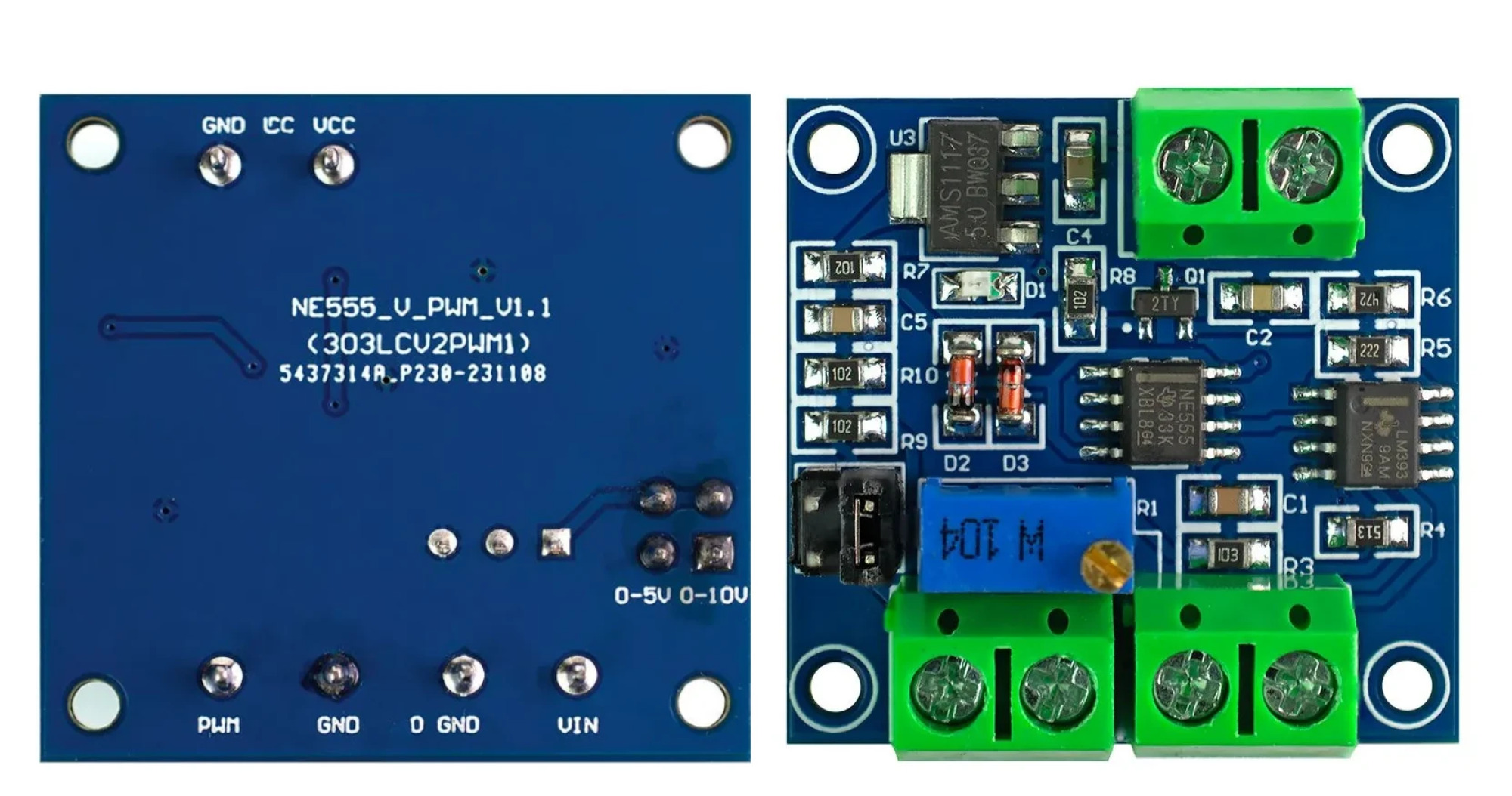

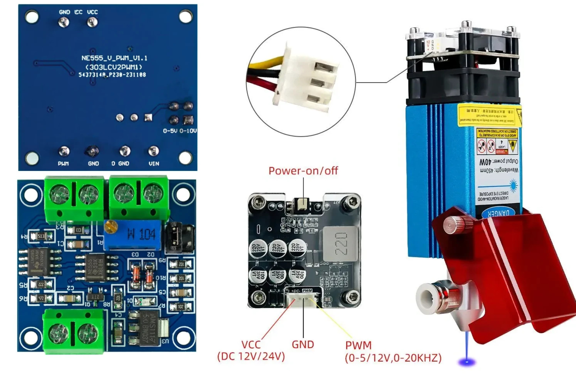

We are faced with the task of connecting a laser to a machine controlled by LinuxCNC. It doesn't matter, lan or lpt, the controller model doesn't matter either. Most often, the connection must be made to a machine that already has a spindle in use.
The simplest question is called LinuxCNC work, it, bunny, works without complaints and is easy to configure. But making the equipment purchased in China work adequately is much more difficult and therefore we will have to touch upon electrical issues.
1. The laser itself. Typically, the laser purchased has a laser housing and a power control board (2025) K
this board connects 3 wires - Plus 12 (24)V, Minus 12 (24)V - also known as GND, and PWM - control of laser power by a frequency signal. The main question is where to get this signal? Such a signal goes from the computer to the machine control board (controller), but the current of this signal is too small, and the laser refuses to understand it. This implies the need to purchase a separate Voltage-PWM signal conversion board. It can cost 1-10 dollars and will definitely be of mediocre quality. This board must be connected and it has three groups of contacts -
1.1. nutrition group, Plus 12 (24)B - it was called VCC here, Minus 12 (24)B - also known as GND
1.2. the control input is the signal wire, the same one that controls the operation of the spindle inverter, here it is called VIN, and GNG. But this is a different Earth, this is GND from the machine controller - an important note. Yes, all contacts of the GNG PWM generator are closed to each other on the board, so purely electrically they can be connected anywhere "before", but if there are terminals, why not use them as intended?
1.3. the control output is the PWM and GND signal wire. GND may not be used from here, but PWM is connected to the same PWM connector on the laser.
2. Now we need to resolve electrical issues. We have a spindle and a laser. If earlier our spindle inverter control wire went from the machine controller to the inverter, now from the controller and from the same contact (or from the same wire, but from the entrance to the inverter) we pull the long VIN signal wire to the laser itself. Several necessary actions follow from here -
2.1. It is necessary to make a separate inverter power switch so that the spindle does not spin when using a laser
2.2. it is necessary to provide for disconnection of the VIN wire going from the controller or inverter to the laser. This wire is long and there will be leads on it. If we do not turn off this wire, then when the spindle is turned on, the aiming will distort the VIN signal and the inverter will constantly change the frequency for the spindle. These can be such strong distortions that the spindle becomes uncontrollable - you give it a signal s1000 or even s0, and it either accelerates or brakes - such a swing.

1. Сам лазер. Обычно покупаемый лазер имеет корпус лазера и плату управления мощности (2025г.) К
этой плате подключается3 провода - Плюс 12 (24)В, Минус 12 (24)В - он же GND, и PWM - управление мощностью лазера частотным сигналом. Главный вопрос - где взять этот сигнал? Такой сигнал идет от компьютера к плате управления станком (контроллеру), но ток этого сигнала слишком маленький, лазер его отказыватся понимать. Из этого следует необходимость покупки отдельной платы преобразования сигнала Напряжение-ШИМ. Она может стоит 1-10 долларов и точно будет посредственного качества. Эту плату необходимо подключить и у нее три группы контактов -
1.1. группа питания, Плюс 12 (24)В - его здесь назвали VCC, Минус 12 (24)В - он же GND
1.2. управляющий вход - это сигнальный провод, тот же, который управляет работой инвертора шпинделя, здесь его назвали VIN, и GNG. Но это уже другая Земля, это GND от контроллера станка - замечание важное. Да, все контакты GNG ШИМ генератора замкнуты между собой на плате, поэтому чисто электрически их можно соединить в любом месте "до", но если есть клеммы, почему бы их не использовать по назанчению?
1.3. управляющий выход - сигнальный провод PWM и GND. GND отсюда можено не использовать, а вот PWM покдключить к такому же разъему PWM на лазере.
2. Теперь надо решить вопросы электрики. У нас есть шпиндель и лазер. Если раньше у нас провод управления инвертором шпинделя шел от контроллера станка до инвертора, то теперь от контроллера и от того же контакта (или от этого же провода, но от входа в инвертор) мы тянем длинный провод VIN сигнала к самому лазеру. Отслюда следует несколько необходимых действий -
2.1. надо сделать отдельный выключатель питания инвертора - чтобы при использовании лазера шпиндель не крутился
2.2. надо предусмотреть отключения провода VIN, идущего от контроллера или инвертора к лазеру. Провод этот длинный и на него будут наводки. Если мы этот провод не отключим, то при включении шпинделя наводки будут искажать сигнал VIN и инвертор будет постоянно изменять частоту для шпинделя. Это могут быть такие сильные искажения, что шпиндель станет неуправляемым - вы ему даете сигнал s1000 или даже s0, а он то разгоняется, то тормозит - такие качели.
