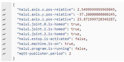

Hi all,
I experimented with the mqtt-publisher on a trial basis. It works well so far, but I can't publish more than 10 HAL pins. Even if there are more than 10 parameters under keys=, only the first 10 are transmitted. Does anyone know if I'm doing something wrong? I followed the mqtt-publisher instructions exactly.

Did you notice the bit where each token is limited to 255 characters and to get sound this you can use multiple "keys" entries ?
It's hidden in under the examples heading.
If you have no further luck it may be of interest to raise an issue on the GitHub page.

When I create multiple “keys=” entries one below the other, LinuxCNC no longer starts:
Preparing LinuxCNC2MQTT info: Publishing MQTT message (devices/linuxcnc/machine): {"halui.axis.x.pos-relative": -84.95, "halui.axis.y.pos-relative": -92.95, "halui.axis.z.pos-relative": 24.496, "halui.joint.0.is-homed": false, "halui.joint.1.is-homed": false, "halui.joint.2.is-homed": false, "mqtt-publisher.period": 10} qtdragon_hd_postgui.hal:30: Unknown command 'keys=halui.estop.is-activated,halui.tool.number,halui.machine.is-on,halui.program.is-running,halui.mode.is-auto,halui.mode.is-manual,halui.mode.is-mdi,halui.mode.is-teleop' info: MQTT connected: Connection Accepted. Shutting down and cleaning up LinuxCNC... task: 526 cycles, min=0.000012, max=0.011844, avg=0.009461, 0 latency excursions (> 10x expected cycle time of 0.010000s) Note: Using POSIX realtime LinuxCNC terminated with an error.

Try this for the keys
I see what you mean, even when it starts with multiple key entries only the last group of keys get sent

With your settings, I only receive 7 values.
After removing the axes and joints that are not present on my milling machine, the result is the same - only 7 values are received. Sorry, I don't understand the principle of keys entries.
I have now shortened the list to 9 entries and am only using one key= statement. This allows me to transfer all 9 values.

Like I said it may be worth raising an issue on GitHub as the actual behaviour does not match the behaviour in the docs.

yes, you are right. I'll do it.
