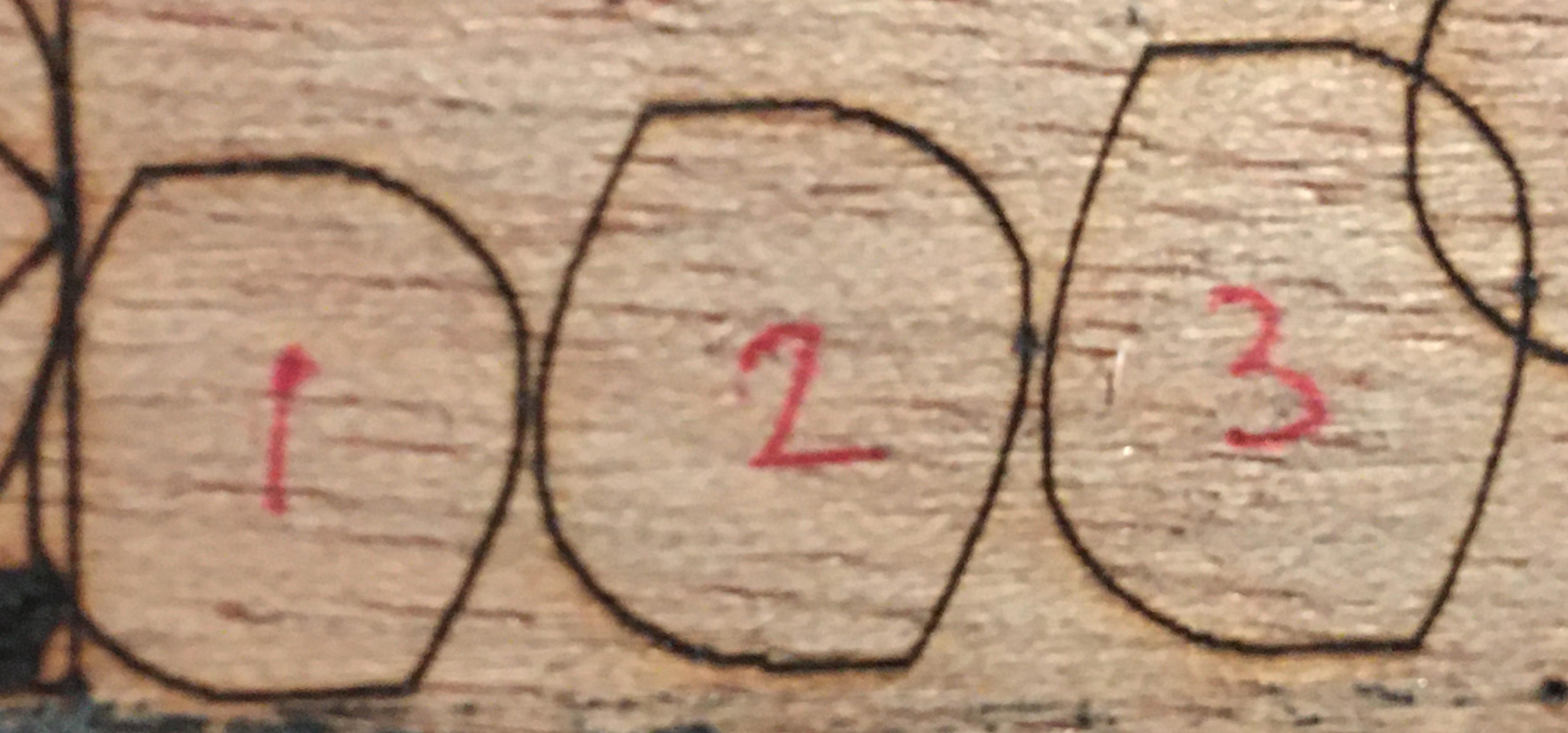

Backlash not working anymore in LinuxCNC v2.9.x
Build my own laser CNC machine about 4 years ago, which worked fine with LinuxCNC 2.8.2.
Using an RPi 3B+, laser and 2 x L293D controllers and 28BYJ-48 steppenmotors.
After trying to update Debian to trixie the SD-card would not boot anymore, so build new one (back to Bookworm).
(Although i can get the old data from LinuxCNC of the card.)
Debian Trixie is not that RT compatible as written all over, still need an RT version to run LinuxCNC on RPI 3B+.
Pitty there is no complete RPi 3 (only 4 and 5) version of LinuxCNC available anymore?
After installing LinuxCNC v2.9.6 (on Debian Bookworm) I could not get the machine working as it did with v2.8.2.
I also changed X-axis steppenmotor with a spindle drive to make it more accurate, this works fine (backlash between 0.1 - 0.3),
but after this I still have trouble with the Y-axis (on which i did not changed anything).
Before (v2.8.2) the Y-axis had a backlash of 1.315, but now I can not get it right anymore.
It looks like the backlash is now only working in 1 direction and I do not see the backlash correction back on the motor movement.
Even if I make the backlash much bigger, just to see if is really done by the motor.
It only draws (i.e. circles) bigger, but the error stays (see IMG_4618a.JPG with BL of 1, 2 and 3)
My question is what has been changed in v2.9.x according the backlash, as I only find 'improved'.
In my case it is not improved but getting worse.
Maybe the new changes do not work with my controllers (L293D)?
And how to solve this weird issue.

Replied by dgdodo on topic [SOLVED] Backlash issues on Y-AXIS
Unknown:
I am very sure the .ini file was added in the first post, but I don't see it anymore?
Here again.
And yes I mentioned BACKLASH in the JOINT_1 section of the Y-AXIS, otherwise there wouldn't be any difference between 1, 2 and 3 in the picture? There the backlash was set to 1, 2 and 3.
Why does the picture get bigger (higher) instead of doing the backlash?

I Tried with 'hal_pi_gpio.write base-thread' at the end of the base-thread, but it does not make any difference.

Your ini file is a mess and very hard to follow, but:
Y axis/joint has unreasonably big ferror and min_ferror values, probably should be close to what X axis has
Backlash_speed is set at 6000 inch !!!
What is the drive train? Belt? Screw? Ball screw?
Since it is a laser, i would advise belt only on X and Y.

In all honesty it may be worthwhile going back to you original setup. I generally think of the PC for a cnc setup as a "black box". As along as it doing everything you want leave it that way.
But it is quite curious as to why backlash is not working as expected. Maybe raising an issue on github may get better responses. The guys that do the coding will be answering.
I hate to say this but backlash comp should be a last resort after you have exhausted all mechanical ways to reduce it.
Sorry I haven't been able to solve this issue and I wish you all the best. If you do find a solution it would be great to describe the fix for anyone else in the future. Good luck as always.

I not even sure if there Backlash_speed is used in the hal file, there doesn't seem to be anything related to backlash_spped or similar mentioned in the docs for motmod.

Backlash speed was functional last i used it for sure, some 15 or 20 years ago, no idea what's the status now.
Back then it solved the issue of missing steps i wasted 2 hours chasing, and ended up being the G540 issue where for 9 steps it did nothing.

tommylight,
Thanks for your info.

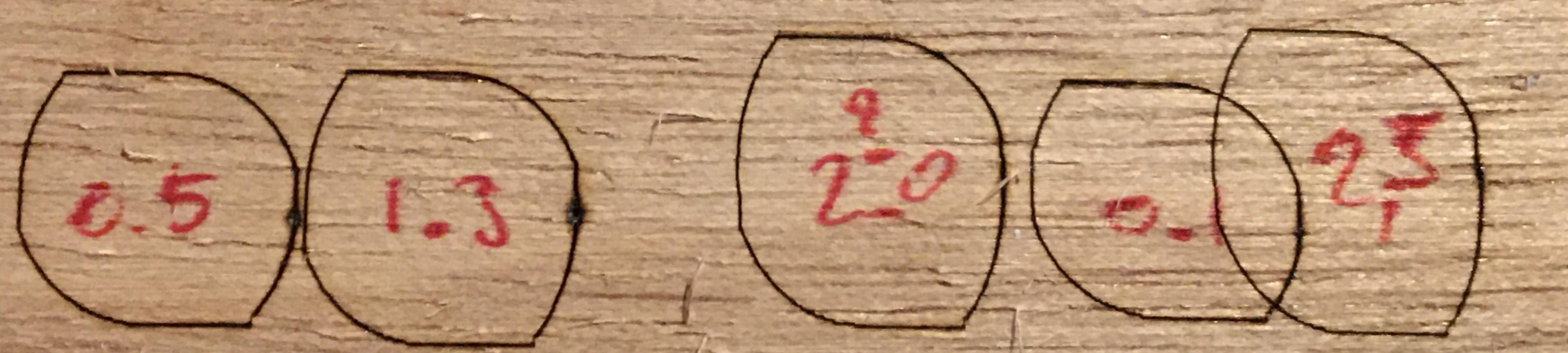

I changed the X-axis with an other old (3 fase) steppenmotor and a M3 spindle movement without any problem.
Nothing has been changed to the (4 fase) Y-axis steppenmotor, but there the issue starts.
Mechanically the Y-axis is indeed a mess, it is gear driven with 2 gears before moving a gear-bar (on which the laser is mounted)
Willing to change it into a spindle driven movement too, but the 28BYJ-48 is already x64 slowed down and is too slow for that.
But the old setup did worked for several years without problems, although the backlash of 1.315 (mm) on the Y-axis.
My setup was always with a Raspberry Pi 3B+ controlling 2 L293D and 2 (28BYJ-48) steppenmotors.
Now i only changed X-axis and updated the Raspberry OS which result in weird backlash issues on th Y-movement.
It looks like on picture drawings (2 way y-movement) it does now turn on the laser before doing the backlash.
On one way the laser burns much longer than usual (earlier).
I will add a picture with on top the old burning (g-code) and below the new ones, same g-code.
You will see much lines extra (longer) burned on the new ones (one way) regardless what backlash i give, although backlash does something.
In red the given backlash is written,
Btw: I added the BACKLASH_VELICITY as i found is somewhere on the internet, but it does not speed up the backlash nowadays.
