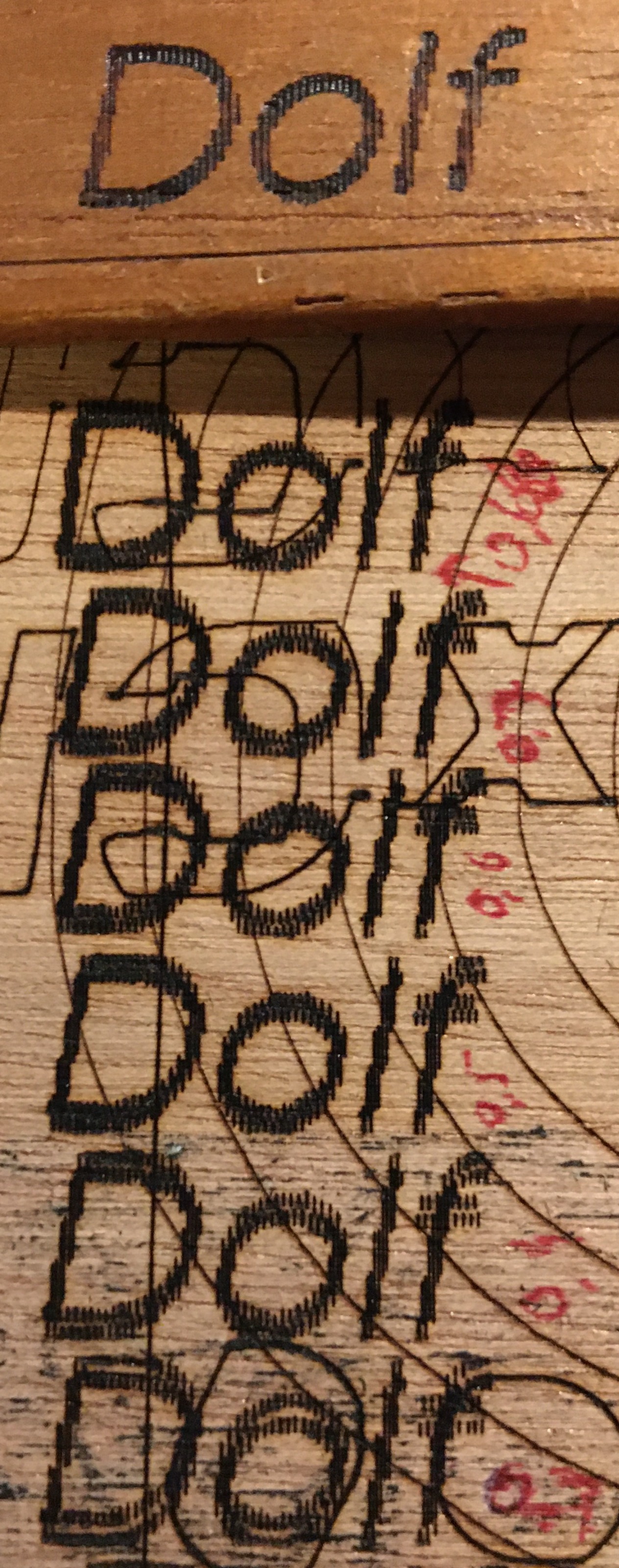

Replied by dgdodo on topic [SOLVED] Backlash issues on Y-AXIS
Thanks for all info so far.
I decided to change the Y-axis also with a M4-(screw) spindle drive (not M3 as I said before), as I did on the X-axis.
Had the (almost) same stepper-motor around, although after testing it needed 2 times more Volt to be powerful enough.
Now it all looks much better!
The old gear setup was too much worn out, I believe. And 2 (plastic) gears before driving the arm had 1.3 mm backlash is also kinda 'too much'.
PS. I thought I tried the write action at last position in the .hal file (base-thread), but was forgotten to change the .ini file accordingly.
It does run fine now and I am not (willing) able to build back the old situation to test this again, sorry for that.
And yes, I will cleanup my configuration files after this change, the X- and Y-axis are now the same.
Regards, DG.
