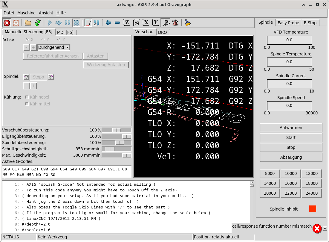

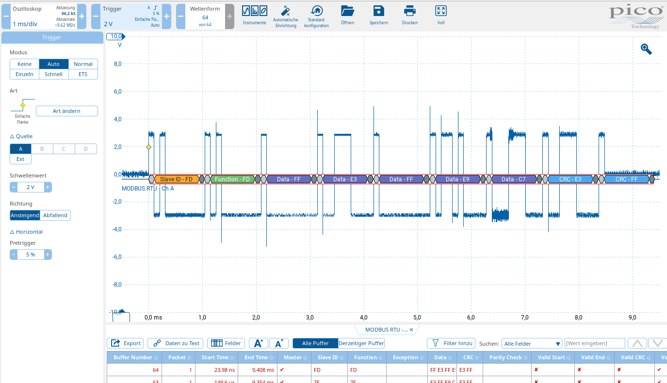

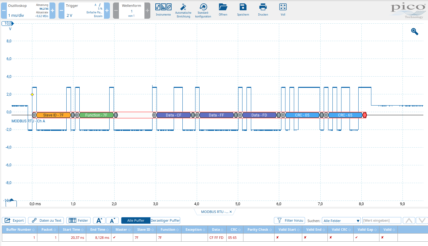

I took my oscilloscope to measure the output of the mesa 7i96s (modbus_mesa.png, not connected with the Vdf this time).
The signal looks pretty fine, but compare to the USB/RJ485 Dongle signal (modbus_USB.png),
I saw only a few packages every 20 seconds.
The Signal of my USB/RJ485 was running every ~10ms (not connected with the Vdf either).

Replied by PCW on topic Configure Mesa 7i96s and pktuart with Omron MX2 (wj200)
setp wj200-vfd.00.update-hz 0.1
Means you would get 1 packet every 10 seconds

Linuxcnc starts without any error, but still no Temperature from VDF (my indicator that it should work).

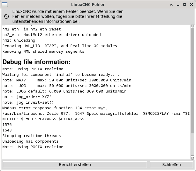

But if click the Spindle CW Button , my Vdf switched immediately into some E 12.1 Error Code (image):
If I click the ccw button, Linux CNC will close suddenly and create some error log about weird Modbus data. (modbus_error.png).
Itś hard to debug, my Workshop is 75m long walk, it is currently -5°C inside, so i bought a 75m ethernet cable to extend my Wifi for RemoteDesktop.
Actually I would move to the new and better supported hm2-modbus
as there are some long-standing bugs in mesa-modbus
(the call response mismatch is a known one)
