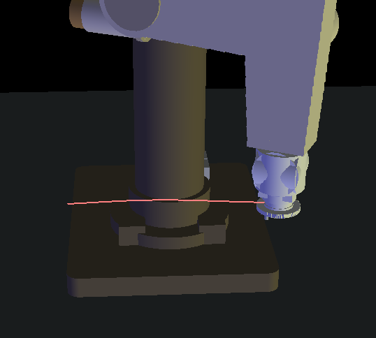

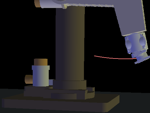

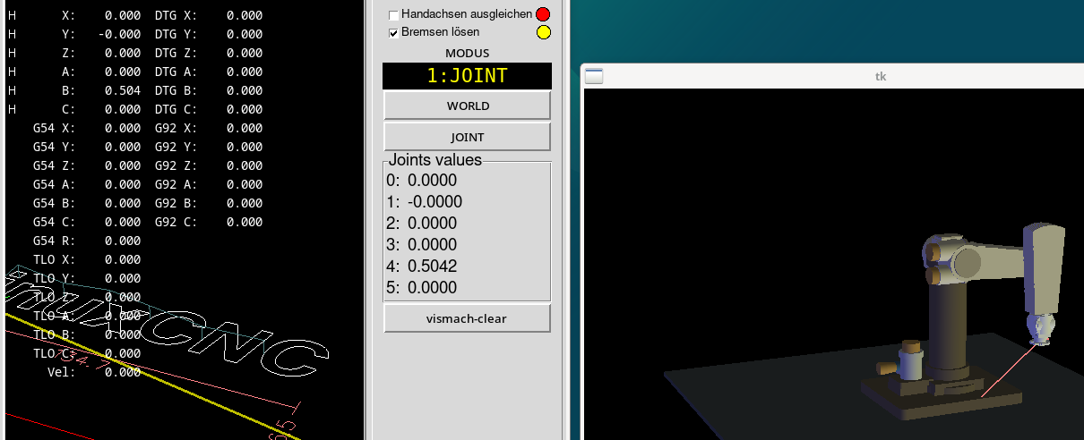

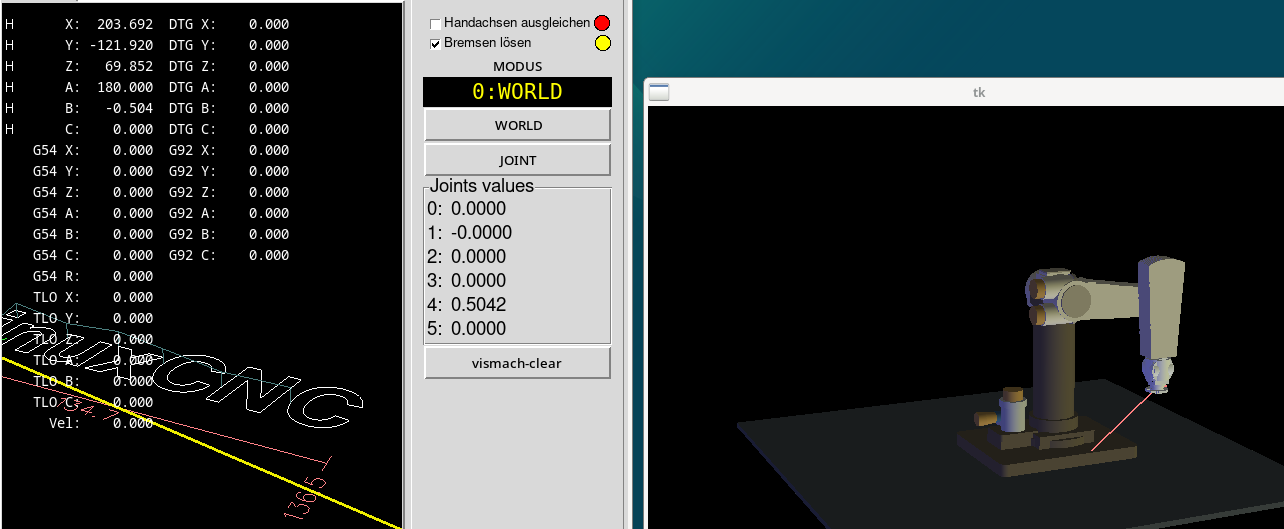

i made a vismach model... i update it to the home position i want.. its 1:1 after homing th real arm.
i dont know if it helps but if i home in this position. x0y0z0a0.5b0c0 in Identity/Joint Mode
and in the world mode
but if i jog in world mode  x + - i see the real failure on the vismach model..
same in Y
i dont know if this explain some wrong dh parameters?! but in some positions the A axis.. joint 4 on the arm starts flipping
thanks
Have you read the stuff I wrote and linked to regarding singularities?
Move joint_4 away from the zero position and try again.

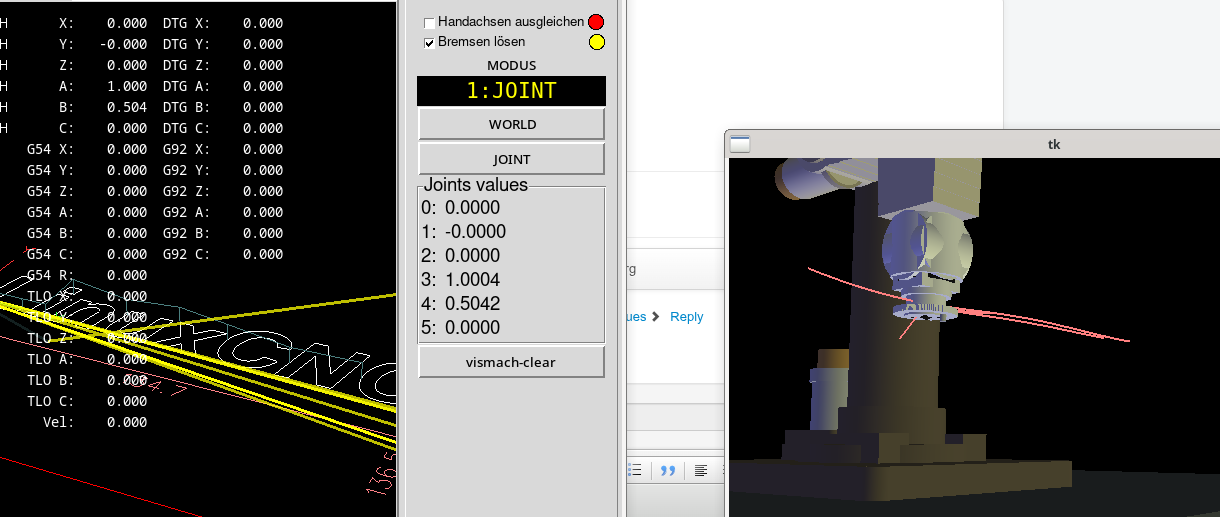

05 Aug 2026 08:52 - 05 Aug 2026 08:57 #348465 by hitchhiker
Replied by hitchhiker on topic PUMA 200 Robotarm and some Hal/INI issues
i read this yes but i dont think about the a to c axis.. joint 4 to joint 6 issue...
i homed all again to x0y0z0a0b0c0  and then jog ti a1 and b0.5 still flipping......
i checked again that all the movements in joint mode are correct ( encoder and motor to degree translation ) the scales are all correct.
an again i wonder that the tcp is upside down..

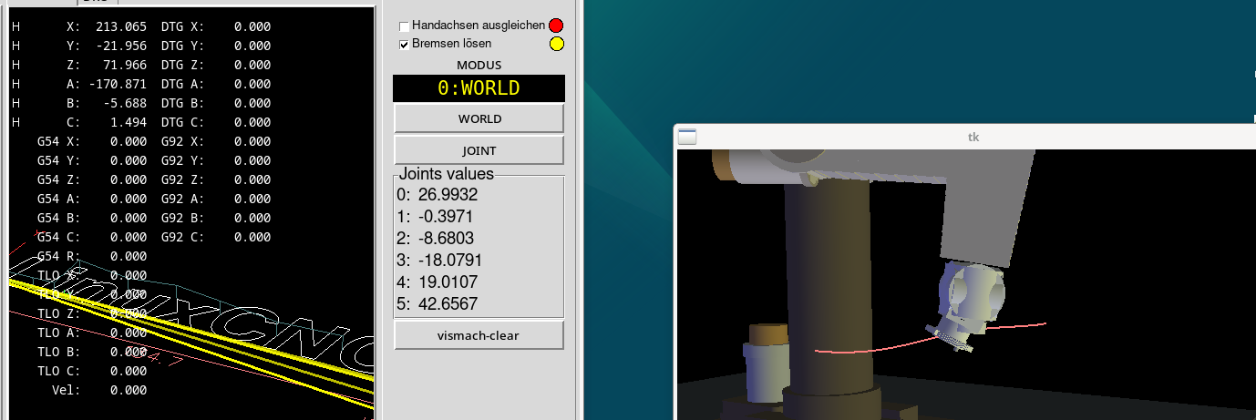

Looking at those curved jog paths I don't think you are done with your DH-parameters yet.
If you zip up the config folder with the vismach model I'll try to have a look at it.

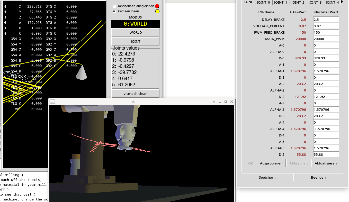

05 Aug 2026 15:41 #348472 by hitchhiker
here the zipped config.. hope it help us... thank you for the help and time and headache :)

The dh parameters i set are the parameters i get from right hand ruled cs. Possible i do it wrong. Because .. if i home over my sharpie marks the arm is in this position:
Joint 1 0 ( about 140 +- to the mechanical limits)
Joint 2 0 (90 deg to tower.. means parallel to base)
Joint 3 0 ( 90 deg to joint 2... means parallel to tower)
Joint 4 0 ( mid position +- 320)
Joint 5 0 ( mid position +-125)up and down same direction as joint 2 and 3
Joint 6 0 (mid position +- 280) left right same as joint 4
The values of A and D i get from the drawing
The Alphas i get from right hand rule cs.. and the signs for the A and D values i get with the alpha stuff.
And the angles after homing i checked with a digital pritractor... and the scales i checked with 90 deg moves looking to the digital protractor.
