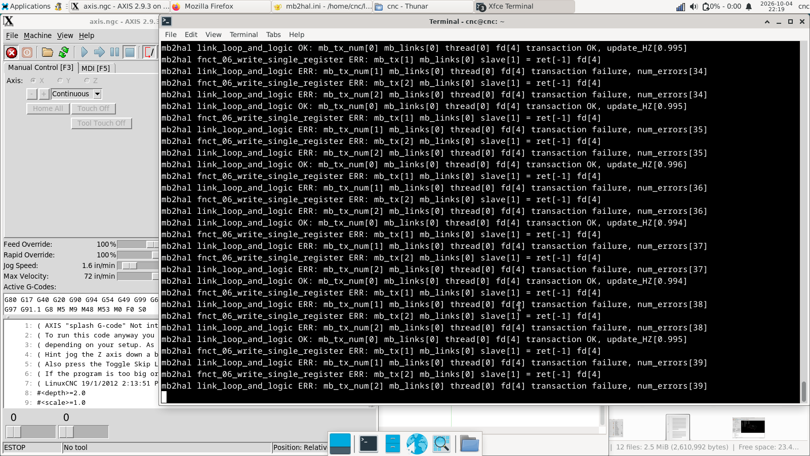

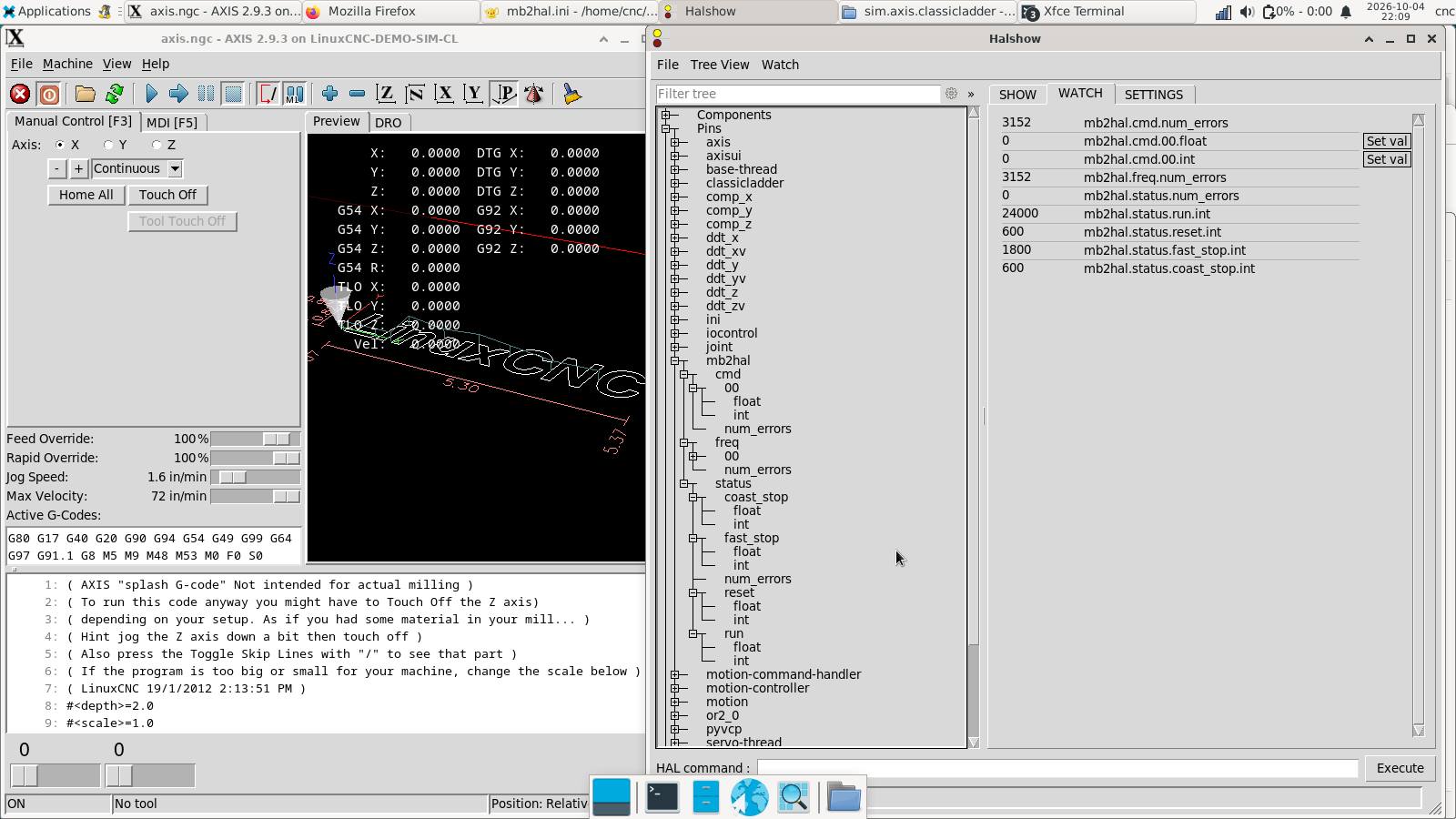

3) modbus.png which shows few hal pins of the mb2hal module. what I find a good sign there is that first transaction for reading the registers seem good, no errors are accumulated there
4) modbus error.png shows the error message in terminal when I started LinuxCNC there, maybe that is helpful for understanding what am I missing

I have a suspicion that "First element" in mb2hal.ini is not correct because of the values that are reported on hal pins.Values of those hal pins match following settings from VFD: P-01 (max speed) is set to 24000 and P-02 (min speed) is set to 1800 and P-03 accel ramp time and P-04 decel ramp are both 6.0 seconds
And now as I was writing this, I checked - if I change P-04 parameter (decel time) to 7.0 seconds, mb2hal.status.coast_stop.int immediately changes value to 700 and changing P-03 to 5.6 seconds changes mb2hal.status.reset.int to 560 - hooray I have some basic communication going!
I chose those names according to functions of first 4 bits of register 1 that show status of VFD - I thought that they would reflect values of the first 4 bits, but now I see that they are integer type hal pins, so now I am confused which registers am I looking at.

I took the "First element" value of 128 from very bottom of page 36 of VFD manual (section 8.4 "Modbus register map")
Could you please hint me what am I doing wrong? Because from that register map I understand that register 4 holds accel / decel (from modbus register map it seems that it is one value used for both accel and decel but I proved that those are 2 separate values received from VFD) and I am somehow reading that but I do not see in that map any register that shows min and max speed settings. Where do those come from (got curious and checked - hal pin values are updated immediately when I change those settings in VFD)?
And it seems obvious that if the first transaction is not reading the register that I thought it would then other 2 transactions will not write the register that I thought they would and they produce those errors...

The error messages indicate that transaction 1 & 2 are bad but in reality all are bad.
