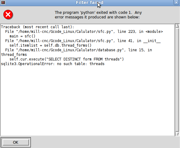

05 Nov 2012 19:23 #26267 by piasdom
Replied by piasdom on topic Machinist Calculator
i tried the calculator and got attached error win. but may not
know how to start. i opened py file in linuxcnc.

05 Nov 2012 19:43 - 05 Nov 2012 19:46 #26269 by BigJohnT
Replied by BigJohnT on topic Machinist Calculator
Just run it outside of LinuxCNC as there is no advantage to trying to open it as a filter is has not output to LinuxCNC and it looks like you don't have all the files in the same directory. Put the 4 files that came in the zip into a directory and use the file manager to launch it.
It does look like I need to fix the path finding in order to run it from a desktop launcher.
John

05 Nov 2012 19:47 - 05 Nov 2012 19:52 #26270 by piasdom
after reading the readme(dumass:) i see it says;
In Ubuntu run sfc.pyc either by clicking on it in the file manager or from a
terminal with ./sfc.pyc
i don't see the .pyc file. i do have the four file in one folder, that
and the readme file
opening in terminal works. is just the thread working ?

05 Nov 2012 20:03 #26271 by BigJohnT
It should say .py not .pyc.
The threads tab is the only one that is finished so far. I'm working on the drilling tab now.
John
