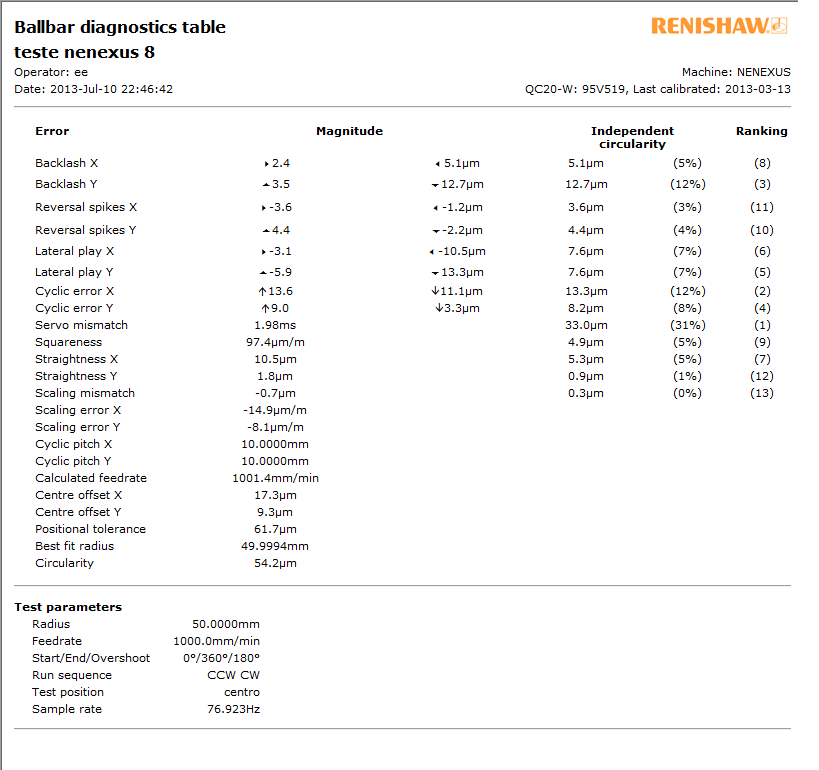

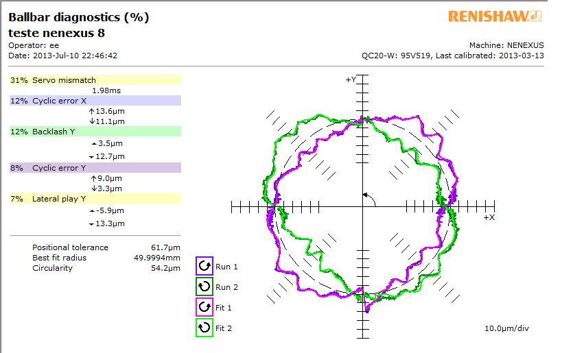

Hello !!
I used a Ballbar in my machine , in general the result was good (Graphic in annex), but the major error was in SERVO MISMATCH , but i use Steppers in my machine !!
I think that this problem is because i use a comp file to compensate the backlash (about 0.10mm to 0.15mm in differents places of the ballscrew).
My question :
Have a configuration on EMC to "correct" the servo mismatch error??
Thanks !!

IMHO you need to reduce the backlash first.
