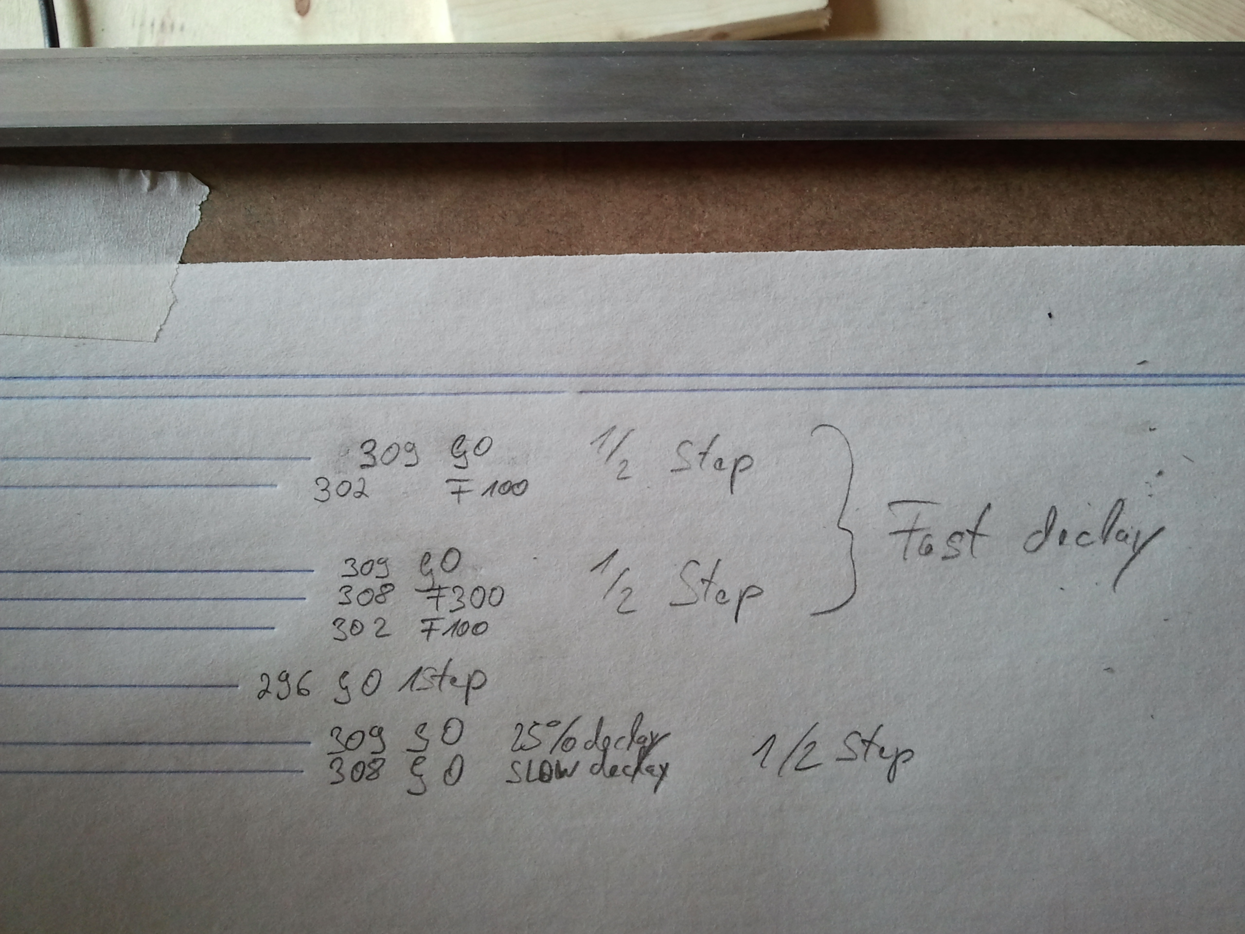

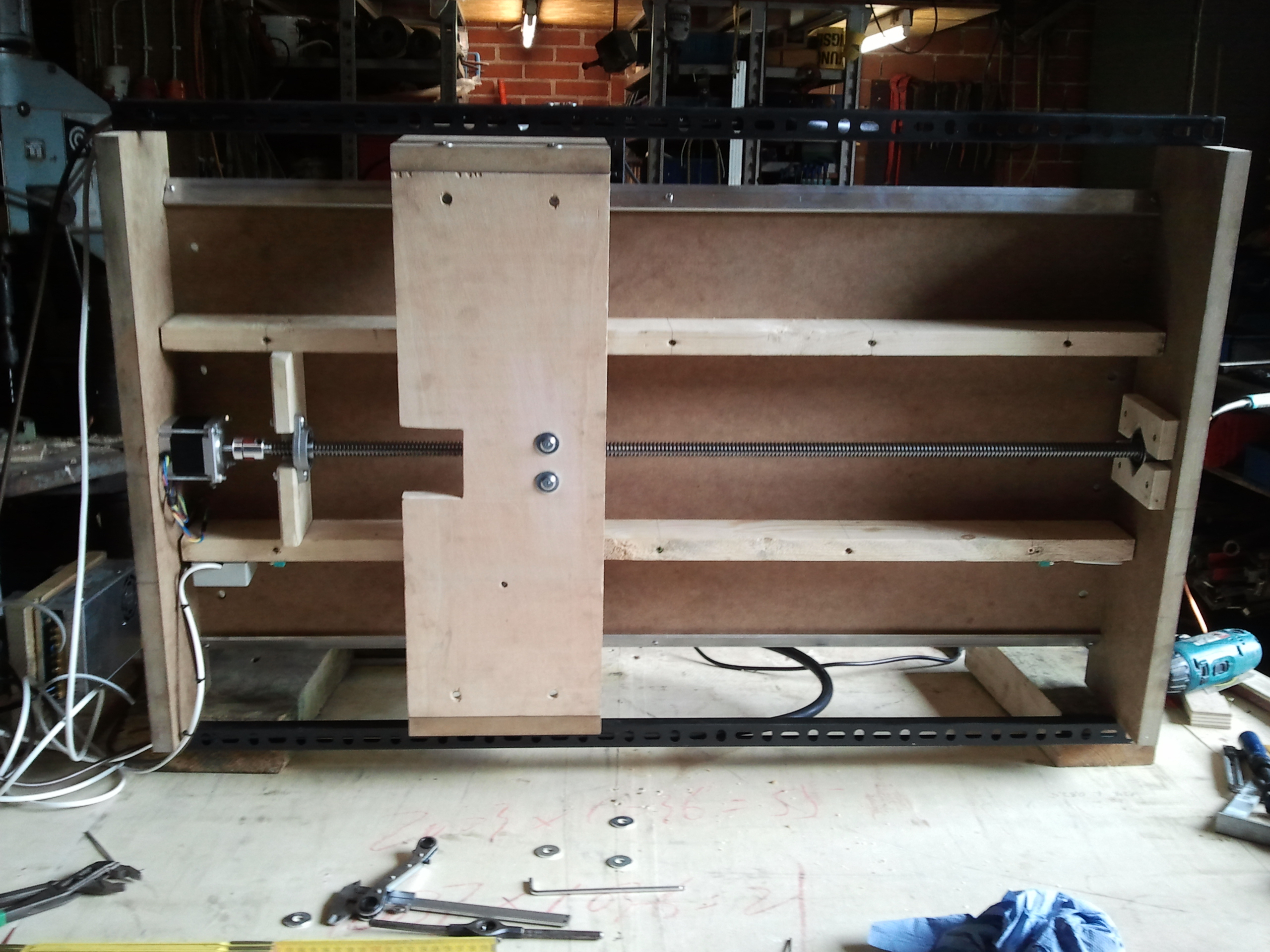

Hello, I've build my own CNC machine. But there is a problem with my Y axis.
For example I want draw a line of 600 mm, the machine draw 605, 620 or something like that. Alway too far. What could be the reason for this behavior?
The axis move relativ smooth in my opinion, but there is a strange sound like this:
dl.dropboxusercontent.com/u/33977923/Y_Noise.mp3
From my point of view it sounds like a step loss, but then the drawn line must be shorter.
Here the technical data of my machine:
Y spindle: 16x4mm
Y Motor: 0,91 Nm; 2A
Driver: Chinese TB 6560 3 Axis, 75% Current; fast declay; 1/2 step
PC: latency 16000 ns
regads
Sebastian

can be a number of things . but i'll place them in order
Mechanical Binding
steppers at too high microstepping for the rated spec of stepper motor
steppers under powered
velocity too high
start by reducing the stepper driver micro steps by 1/2
over running of distance can be a number of things , mostly mechanical , such as backlash and sloppy movement
to check distance make a g1move say 1" and without making any changes set this as your touchoff point 0 then measure from this point and say move 6" and measure
adjust the scale setting in your ini to adjust measured distance , but this needs to be done a few times to get it right
measuring over a long a distance as resonable , will get better results

okay thanks.
The micro step is already 1/2. Actual the velocity is 10 mm/s and the acceleration is 100 mm/s*s. The other axis work well with this settings. On short distance there is no over runnung of the y axis. The LinuxCNC example looks very well.
I' ve tryed to comtensate the over running with the pitch settings. But if the over runned distance always change like discribed it is not a proper method.

Hello, today I've disconnected the motor and turn the whole way by hand. There are no spots or anything like that, it feels very smooth. Then I've tried to draw a line of 300mm by different velocities and settings. The result is a decreased over runnung by a low velocity. Then I changed to 1 step mode. There the way is to short.
In my opinion the motor is too small, because I can stop it by push my fingers together on the engine coupling. And because of it's the strange sound.
But why it runs too far and why the other axis are much better?

Yes I can turn the coupling by hand if the machine is on.
After a over run the machine doesn't return to the home position. It runs again too far, so it reach the endswitch.
By now I think the chineseboard is the nonconforming unit. I run it with a 34V supply. I have research a high voltage increase step loss rate by this board.
