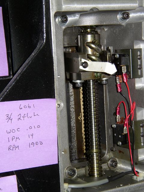

by jmelson
head here:
jelinux.pico-systems.com/zaxis.html
I got a ballscrew and mounted it as close to the front of the head as possible, to
minimize the moment arm of the link driving the quill up and down. I still get
.0015" of "backlash", which is actually flex of this link. This is a velocity servo
setup, so I have an encoder directly driven via helical-slit coupler from the
top of the ballscrew (red unit in pics) a dc tach driven by mini belt, and a
motor on the bottom driving the screw by belt.
I made this in 1997 or so.
Jon

- BigJohnT
- Posts: 3981
- Thank you received: 994
20 Sep 2013 05:29 #39047
by BigJohnT
Replied by BigJohnT on topic Quill Control
My Anilam is similar and suffers from the same kind of problems with backlash. Other than that it gets the job done.
Very nice work Jon.
JT

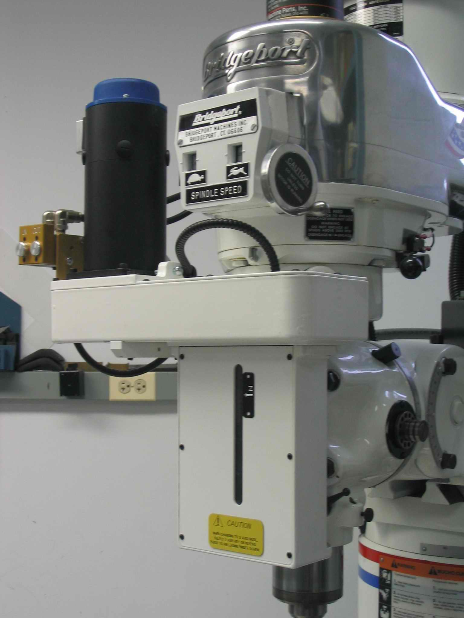

- Skullworks
- Posts: 12
28 Nov 2015 10:14 #65925
by Skullworks
Replied by Skullworks on topic Quill Control
I know I'm late to this party but if anyone else has this issue. Check out Elrod Machine in AZ. They make a complete Z axis bolt on assy for B-port type mills that is 1st rate. I made the trip down to Elrod Machine to check this option out for a company I was working for. Our machine had a Z axis issue and while apart several key parts were lost and the OEM no longer supported this machine. As it turns out the retrofit was never done as a machine dealer made a trade offer for a Bliss OBI press that our VP wanted for a project.

28 Nov 2015 10:27 #65926
by ArcEye
Replied by ArcEye on topic Quill Control
I think you are referring to this
www.elrodmachine.com/Z%20Axis%20CNC%20Quill%20kit.htm
Don't know what the price is, just powder coating is $155.
Here is one fitted to the worlds cleanest Bridgeport
regards
