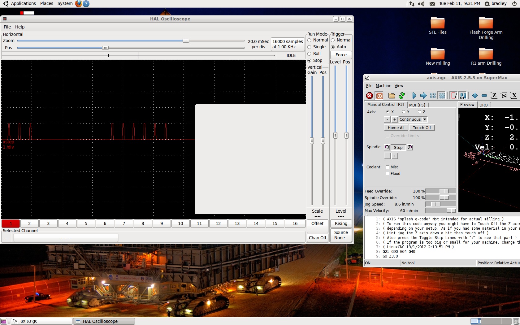

This is a manual mill which got converted to CNC and powered by LinuxCNC. Everything was fine until just an hour ago. It finished a part and when it homed back to X0Y6 for me to swap in the next item, I noticed it was ~0.020" off on X. I have an independent DRO on this machine which allows me to keep watch for any abnormalities. I went to jog it back to X0 and it started jumping around as seen in the video linked. I have connected the Y motor to the X motors harness and the results are the same (the video shown here is of the Y motor temporary connected to the X motor harness). I've attached a screen shot of the scope. I'm using a Leadshine driver for X. I suspect all these Chinese drivers are junk. Ive check the direction signal to the driver with a meter. In one direction, it's a constant 4.2V and in the other, it's a consistent 0V. Any thoughts and help?

In the scope, doesn't the on-time seems really short?

I couldn't really tell from that, I assume I am looking at X step?
I have always found it far more fruitfull to carry out thorough elimination tests using known good axes. In a few tests you can narrow down to the individual component if you are thorough and do not make any assumptions.
Connect the X output from the BOB to Y input. Y axis moves OK - eliminates any problem with X step generation and wiring to the driver. .. and so forth.

Yes, that is my X step.
