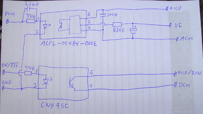

I do need some way to control the spindle, indeed. Currently I use this , works OK and is fully isolated. Currently it runs on a PDM signal generated by LinuxCNC in the basethread, but running off a PDM signal generated by Mesa HW or a pwmgen at the servo rate is fine too.
RS485 is also possible and probably even better. Or I can keep the 7i76.
It seems wasteful to use the 7i76 only for the spindle control channels.
The 7i77 Analogue outputs will control the VFD speed nicely, and the IO can switch the fwd/reverse.
However, it might be less trouble to keep your existing interface to the spindle and run that off of some of the 7i77 GPIO. You only get 1kHz PDM (using the software pwmgen in the servo thread) but it will work.
It is, although I need at least one stepper channel too for the Z-axis. Selling the 7i76 and using a small board with some custom electronics (which I need anyway) makes more sense; there are better ways to spend the euros than an 7i76 which is used for 5%. On the other hand the 7i76 is not an expensive board (at least not when considering the total amount of money thrown in the machine by the time it is 80% finished) and it is built very well, so the real gain is not that much. Not sure what to do with the 7i76 yet.
I am sure the 7i77 analog outputs will control the VFD nicely, but I rather keep the VFD electrically isolated from the rest as it is by far the noisiest component in the entire system and I hate electrical gremlins. 1kHz or 2kHz PDM rate on a regular I/O is more than sufficient for a spindle with a time constant in the seconds range.
