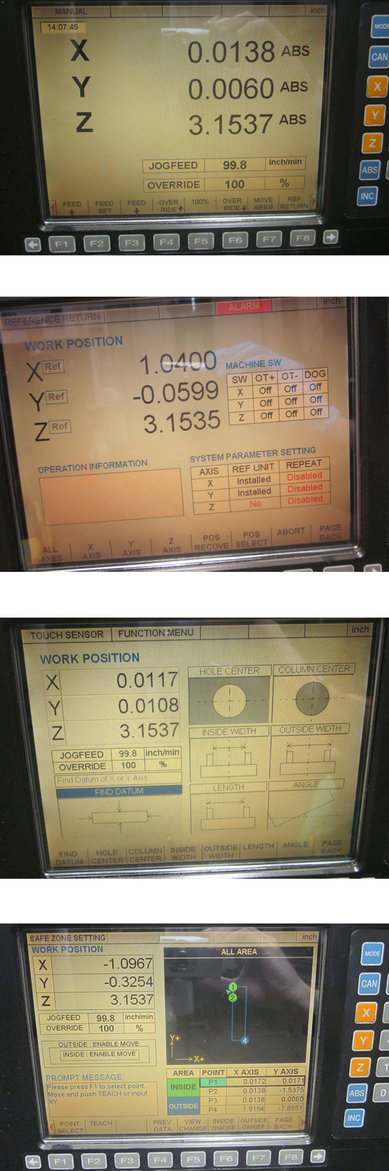

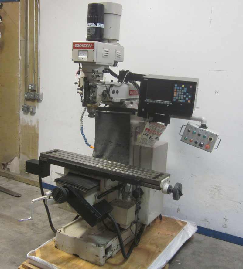

I have been getting inspired by stalking the LinuxCNC boards for a couple weeks... now I am finally ready to start a project. I am good with computers and good at operating CNC milling machines but I am looking to put an updated controller on a mill and need a little help. I have a mill with an old SONY controller but all of the retrofit packages I have found are thousands of dollars and require me to convert my machine to their proprietary computers, boards, servos etc. I am afraid of paying thousands for a new package then every time my machine goes down I would have to pay someone just to come look at their proprietary equipment. Since all my hardware already works, I would rather just change my controller.
My mill currently has 3 axis control and the SONY controller that has Windows 95 installed. I am traveling and cannot photograph my mill right now but this one is nearly identical (and appears to have the same controller & software.)
My question is: if I install LinuxCNC on a computer that has a parallel port, should I have to change any other hardware (boards, drivers, amps) on my milling machine? Or will this setup basically be plug & play, other than some software configuration? I really appreciate your guy help on this!

Here is the user manual for my controller. It is a Sony NU-20/30.
On page 9 it shows the serial port then a 20 pin and a 100 pin port that both go to the electrical box. I might be oversimplifying this in my head, but if I had a computer with the same configuration, would I still need the 5I25 & 7I77 interface? For that matter, the Sony controller is just a personal computer inside the box. Why couldn't I just install LinuxCNC on the Sony controller and utilize the existing configuration? Sorry if these are dumb questions. Again, I appreciate the help!

When you convert a machine like this usually you retain the servos and drives and the power supply and limit switches. The first thing you need to figure out is if the servo drives take 10+- velocity input. A photo of your drive cabinet may help. Assuming you have velocity servos with encoder feedback you need a PC and a motion card like the Mesa 5i25 / 7i77.
