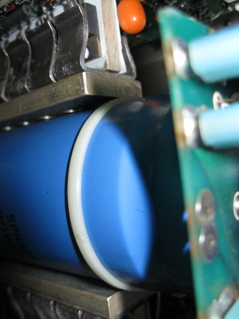

21 Apr 2016 00:27 - 05 May 2016 12:44 #73666
by new2linux
Replied by new2linux on topic Question relating to the tools & training

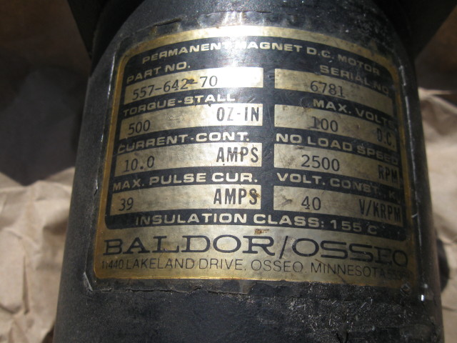

""and a set of Balder/Osseo drives as the start for the 2nd project)""
Could you give your best guess as to the work around (to find a power supply & the drives need power input) for a set of drives without any thing else, I have tried the "search engines" and find the company (or the latest version) OK, but don't see any way to get info there, after all they sell the new models, no reason to support the early stuff.
I have seen a power supply company called Meanwell, but from first glance it has to do with interior lighting power supply.

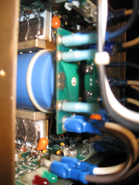

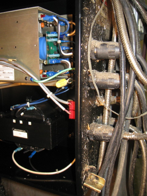

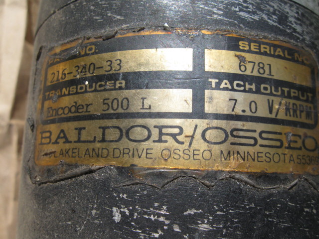

I have included the info from the tag on the drives and what they came from in the hope someone else may have access to a factory wiring diagram, and will ask around other forums for it. It would be helpful to understand what I am looking for, and I can understand this may not be easy to answer but I will need to over come this.
Drives are from a Bandent controller, made by Allen Bradley:
Baldor/Osseo ; 500 oz-in; 100 VDC (max); 2500 rpm; encoder 500L; p/n216-340-33
many thanks!
many thanks!
Last edit: 05 May 2016 12:44 by new2linux. Reason: Add pics of Power Supply and Drives

21 Apr 2016 02:51 - 21 Apr 2016 03:10 #73671
Replied by Todd Zuercher on topic Question relating to the tools & training

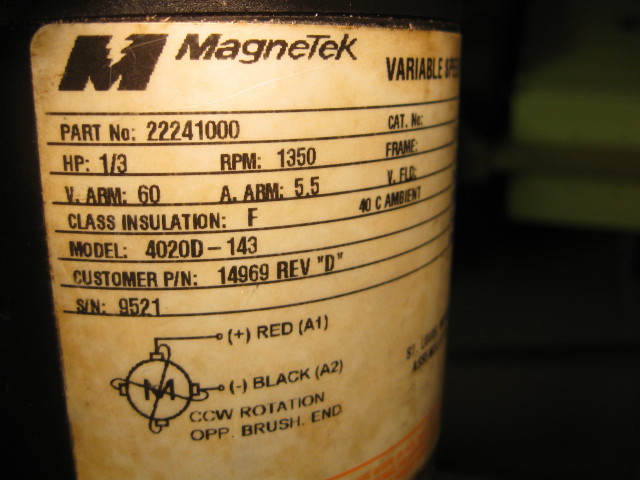

So we/you know something about what your motors and encoders are. Can you get any more info off of the drives, besides what control they were used with?
If you can't find any model or part number info on the drives, maybe some good photos of them might help someone recognize what they are. (or at least tell you "Hey look, that right there is the part number."
Your Magnetek drives are probably just a re-branded Yaskawa product, just have to figure out which one.
Last edit: 21 Apr 2016 03:10 by Todd Zuercher.

23 Apr 2016 12:11 #73746
by new2linux

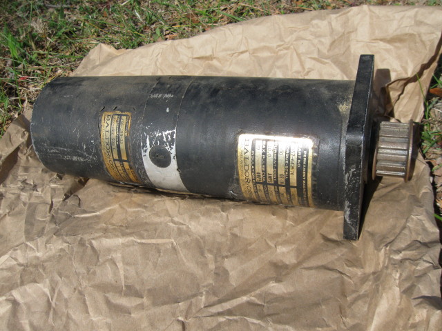

Thanks for the leads for power supplies; Antek & Teknic brands, and especially from andypugh "A power supply for a servo machine tool will normally be vaguely custom, but also not very complicated. Typically just a transformer, rectifier and a lot of big capacitors. "
I have looked at the 2 brands pictures, the price doesn't look too bad, do you need a power supply for each drive or as long as the drives are the same power rating I can use same power supply for more than one drive? It appears the power supply has a "Watts" requirement as to sizing, for the drives in question what wattage is required?
Attached are pics and some of it is hard to read so: Baldor/Osseo ; 500 oz-in; 100 VDC (max); 2500 rpm; encoder 500L; Tach Output 7.0 V/KRPM; p/n216-340-33; 10.0 Amp Current Cont; 39 Amp Max. Pulse Cur; .
Many thanks for all the help!!
Chris
Chris

Well 10 amps at 100v is 1000 watts. (Watts = Amps x Volts) so if you have say a 90v power supply and 3 10 amp drives that is 90 x 10 x 3 = 2700 watts. And yes you can power all the drives with similar volts with the same power supply. I might mention that my old BP knee mill with Analiam 1100M just has a bridge rectifier a rather large cap and a resistor to make a 90vdc power supply. I can give you the part number later if you like. The advantage of the Antek is you can get a 24vdc and 5vdc regulated power supplies built in.
JT
