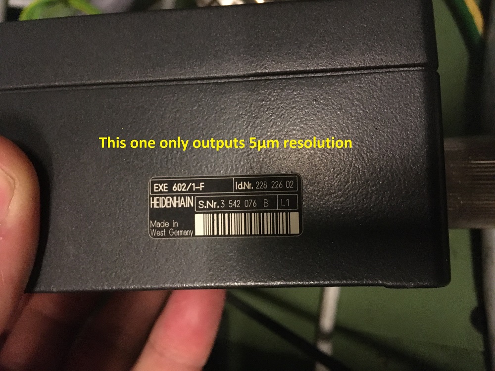

09 Dec 2019 09:20 - 09 Dec 2019 09:26 #152364
by RotarySMP
The single channel EXE's offer a number of advantages.
- They are built like brick outhouses. The housing must be indestructible.
- They only need 5V. Whereas the 3 EXE board needs both 5v and 12vdc supplies.
- 602 EXE's (at lest the two I have) have the differential signals wired in the output cable, so you should have better noise resistance. The three EXE only brings out the single end signals.
- They are cheap and easy to replace.
-They all seem to have the M23 connector for the signal input. You see a variety of output cables from Heidenhain. Heidenhain wiring is fantastic. Double shielded with very robust conduits.
- Heidenhain seems to use consistent wiring colors across the decades and products. Here is my wiring on my 602D/1-5
Heidenhain seems to offer versions with either 5µm resolution, or with 1µm resolution. I ended up with one of each. Doesn't really matter for my level of machining. I can snap off a carbide end mill on the vise just as easily with either system. You just need to edit the INI forinstead of 1000 for that axis.
The 602/1-F has only 5µm resolution
whereas the 602D/5-F ouputs 1µm resolution. I wonder whether the D means it has the extra interpolation?
I only paid about €50 for each. Both work perfectly. Some have ouput connectors and some have cables. I went for ones with output cables and hacked whatever connectors were on the ends and wired them straight in the MESA 7i77. I understand the appeal of finding three with the same output terminal connectors and making a break out connector for the 7i77 so they can be plugged in
