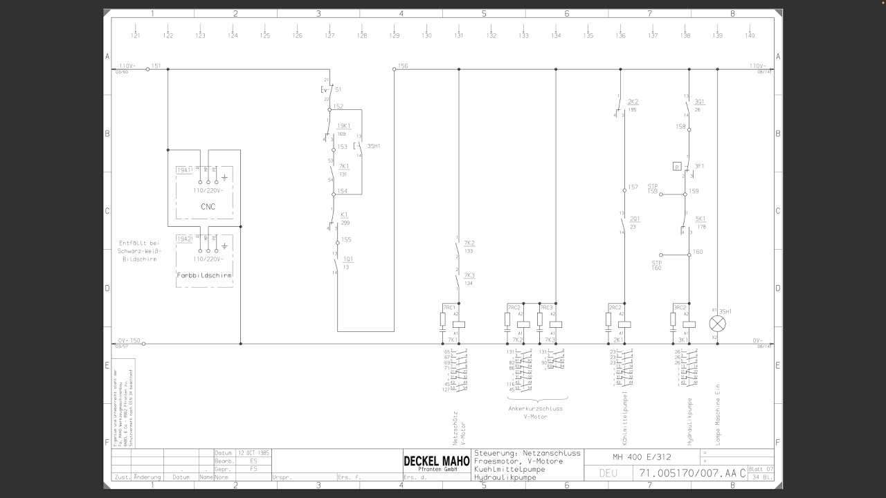

I am now having trouble with the Maho 400E. The machine was working normally, had a normal shut down, and the next day started erring out.
It does not seem to be a LinuxCNC or Mesa issue as it boots into LinuxCNC without error.
** Note - It is configured as a vertical mill, but Maho configured as a horizontal, so on the original schematics, Y and Z are switched.
** Note - The HAL and Ini are attached to the first posts in this thread.
Consistent symptoms.
- X axis jogs without error.
- Y axis will jog in either direction, as far as I like, but as soon as I release the jog button, it faults with a " Y axis following error"
- Z axis faults immediately as soon as jog button pushed to "Z axis following error".
These symptoms are consistent and repeatable.
In addition, inconsistent symptoms are
- When it first happened the "Control Voltage Fault" light was lit on the Indramat server amp. This has not lit again
- On start up, sometimes it refuses to latch on, sometimes it drops the latch immediately with a " External estop set" messages:
Troubleshooting:
- The 3Ph power at the wall probed normal.
- The 3ph power in the cabinet after the main switch probed fine
- The 2x90VAC and 2x 140VAC which input to the Indramat probe fine at the input to the 7K1 relay.
- The E-Stop chain has continuity.
- The Machine is ready chain through the motor overheat protection (8B2/9B2/10B2) is working.
- Interchanging the Heidenhain EXE's makes no difference to behaviour (withing the limitation that Y and Z EXE's have different resolutions, and therefore the PID tuning is off on the swap).
-manually jogging Y with a hex drive, the linear scale follows motion.
It would seem that the next troubleshooting step is to work out whether the Indramat is faulting and dropping the 7A1 contact.
or whether the Indramat is simple reacting to either a fault in the enable circuit
...or it the issue is driven by the latching circuit
How would you recommend troubleshooting to isolate which is cause, and which is effect, with these actions which occur nearly similtaneously? With pins or signals should I put on the Halscope, and what am I looking for please?

At this stage, I would bypass the contactors so the Indramat is on when the power is connected to the machine (maybe through estop chain) without LCNC and manually give an analog signal to the indromat using a 1.5V AA battery. If the Z axis moves, you can continue to troubleshoot the following error. If it does not, then the indramat is dead.
