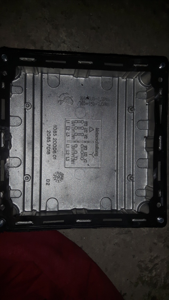

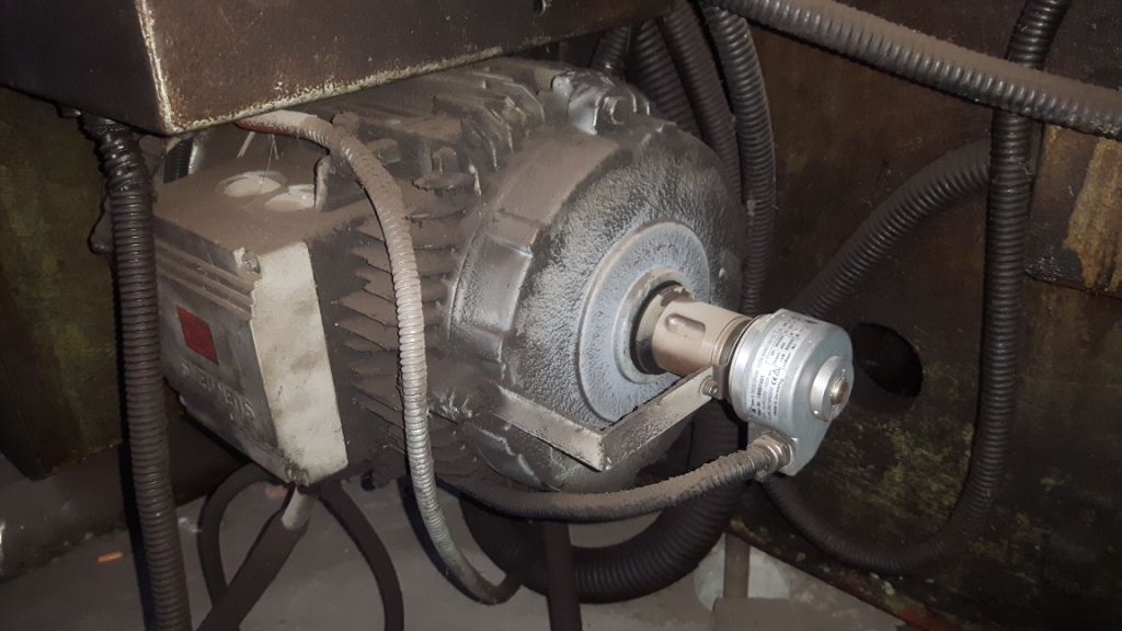

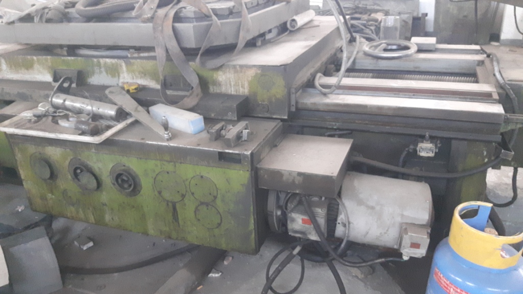

the mechanic, that has disassembled the machine and now should assemble it (seems not be very happy about it) says that there is motor in front of the table that drive all 3 axes + rotation of the table. Next to the motor is a gear box and coupling to transmit the torque from motor to leadscrews, they are trapezoidal on X Y (approx 80mm diameter and 12mm pitch) and ball on Z.
this motor looks like induction 2-3kW, the only plate that I found on the motor i attach. There is encoder mounted on the motor.
