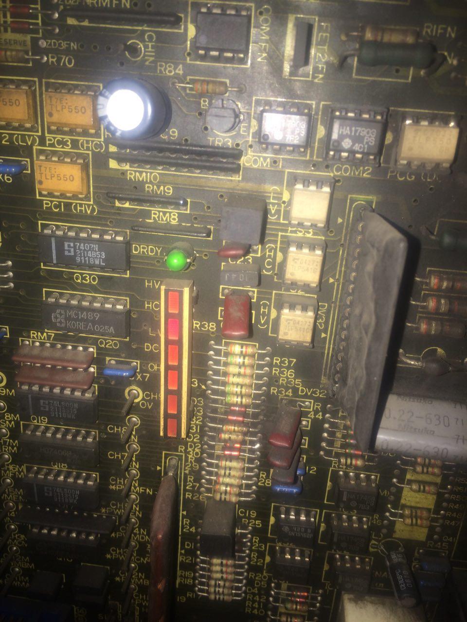

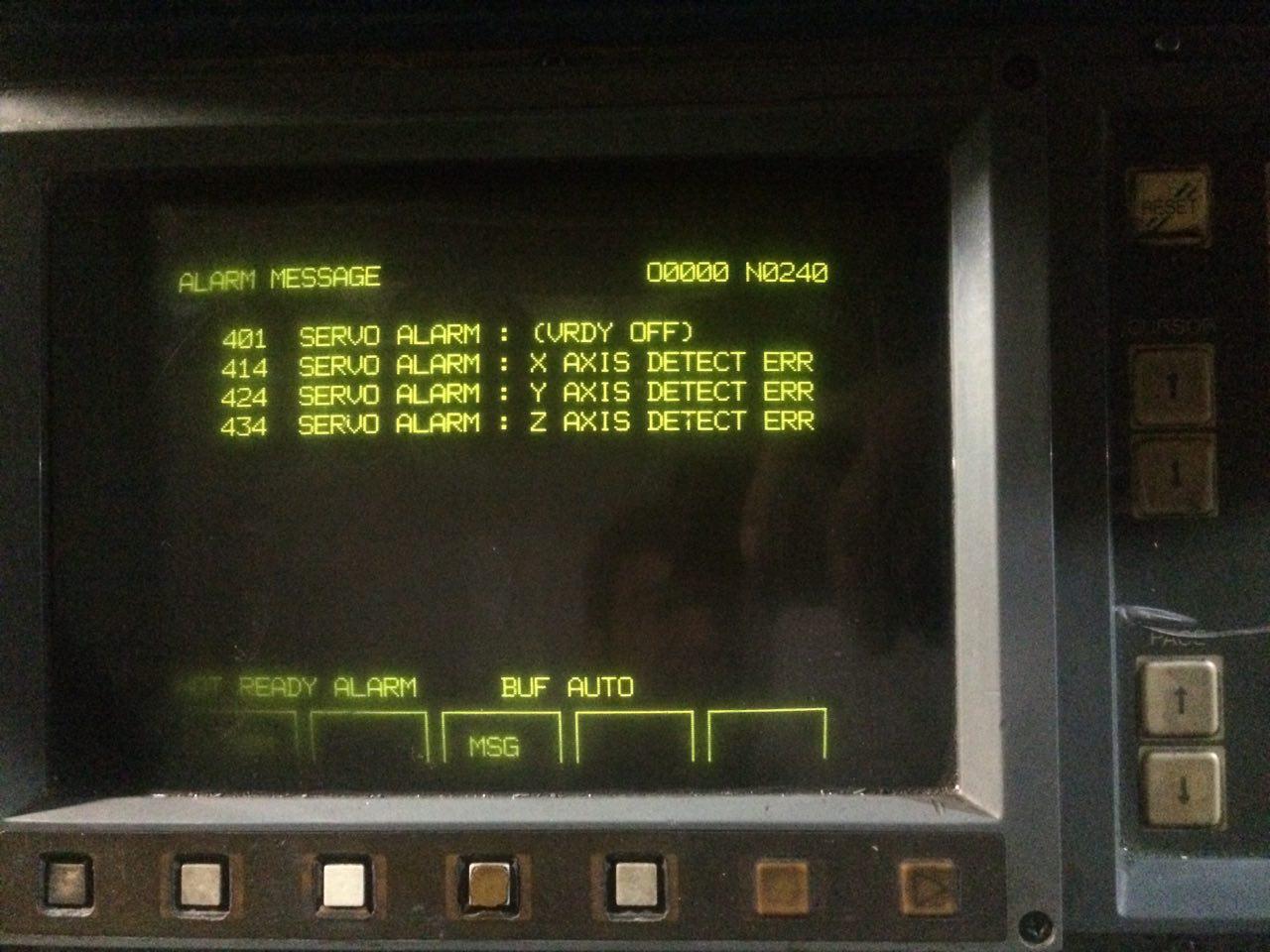

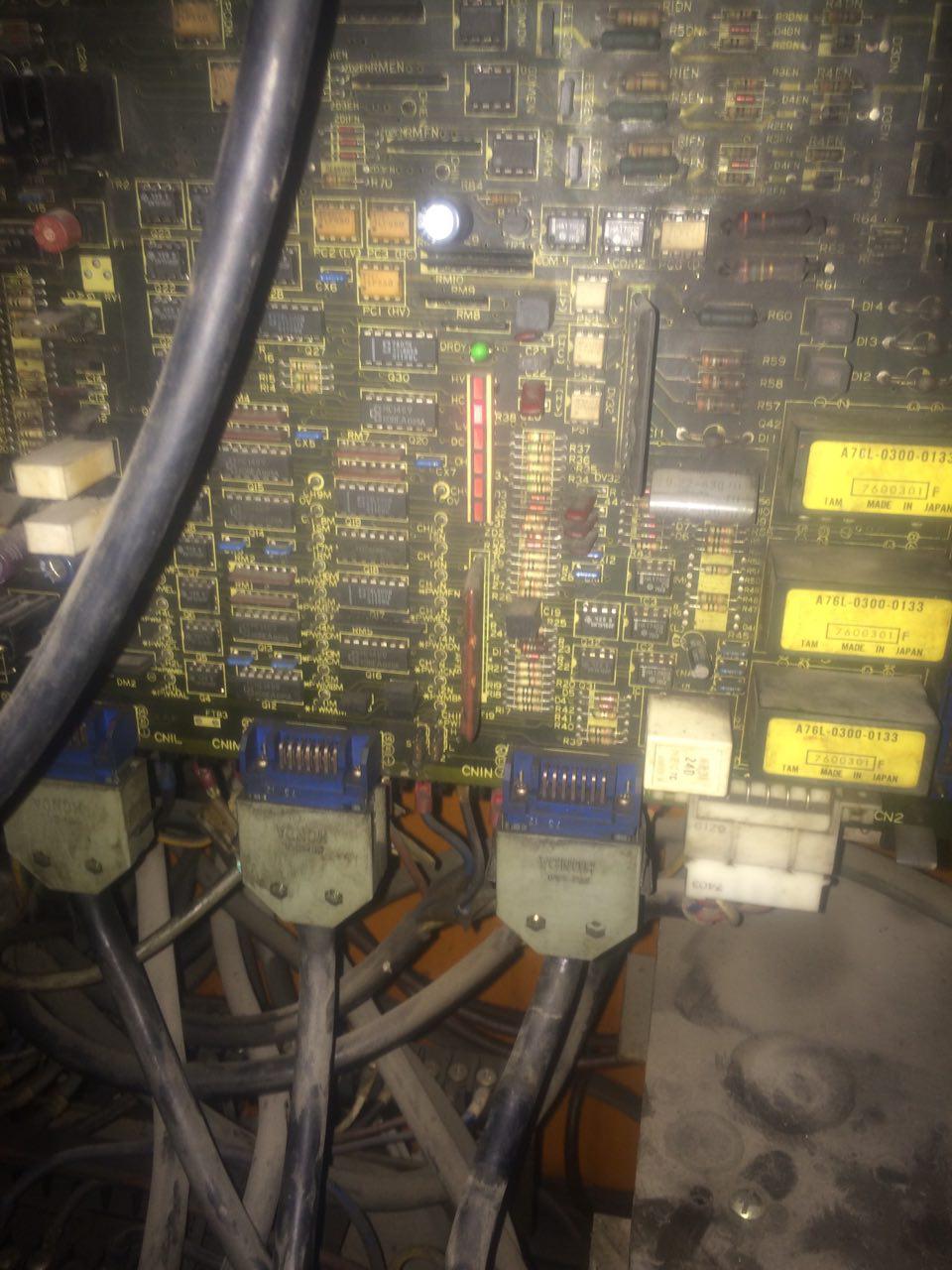

Hi guys.my machine have a aannoying error.10 min after power on this error apears and a led turn on in drive board.the controller is fanuc0m and servos are fanuc too.any suggestion?

I often see those alarms with a power supply problem. Such as a power blink or dropped phase will set them.

how can i be sure?
