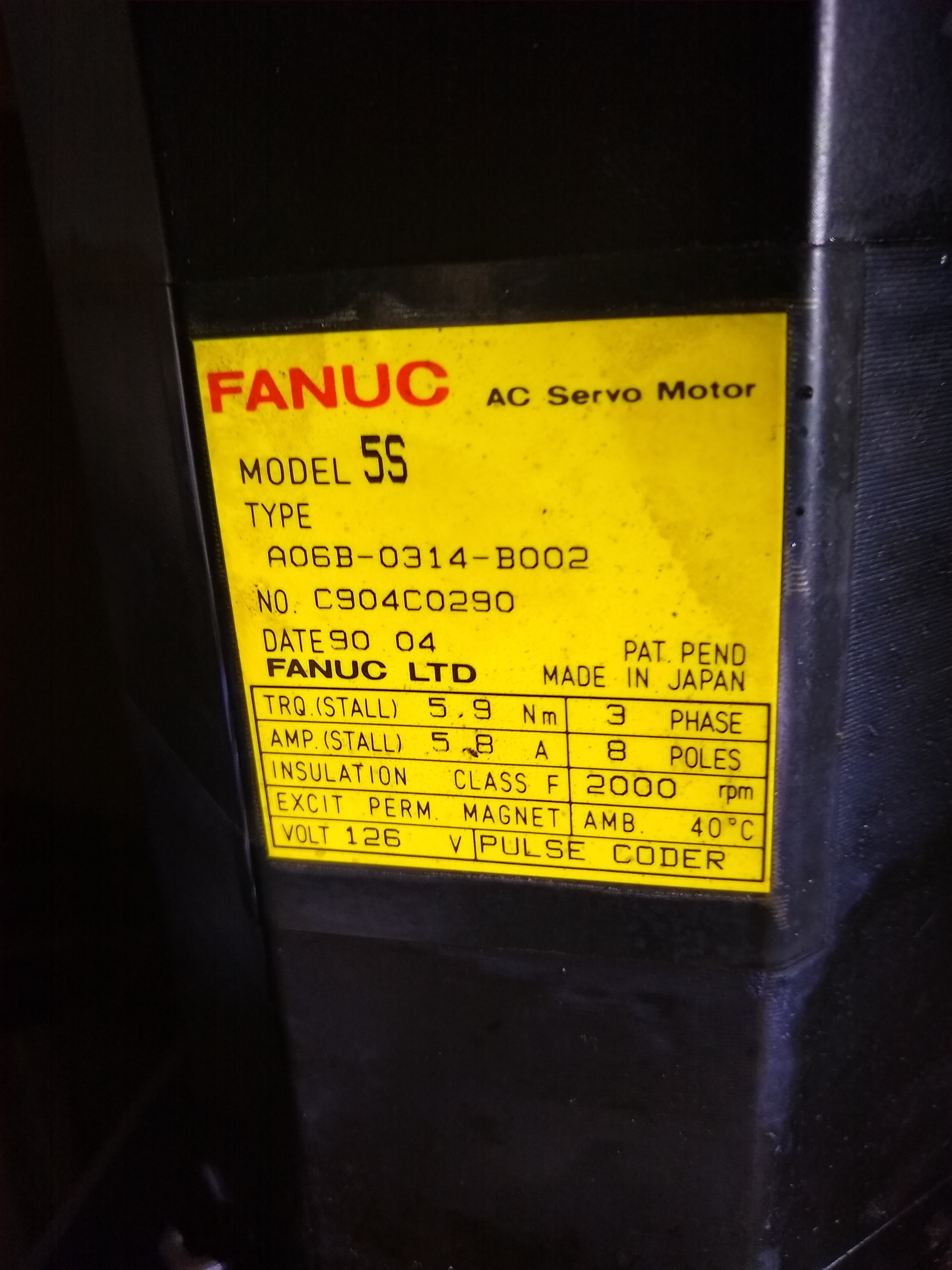

Hi Jon,
I just got pics in of the motors & control.
The control is a Fanuc 21iMA (Type A02B-0247-B545 from late 2000).
Two of the servo motors are model alpha 2/3000rpm from late 2000 (0.5kW cont. output), one is a model alpha 3/3000 from the same year (0.9kW cont. output).
The spindle motor is an alpha 1.5/15000 from the same year.
My understanding is that the 21-iMA control does not have axis drives that support the alpha i servo amps. The motors should have an amphenol connector on their encoders (didn't get a pic unfortunately).
Unfortunately I won't be able to inspect the electrical cabinet myself for a few weeks to get further info, although I may be able to get some more pictures if that helps.

Without more info, I can't even tell whether the encoders are old style with classic ABZ and proprietary commutation, or serial pulse coders which are totally proprietary.
I think I (Pico Systems) have converters for both types (but need the model # to be sure). The motors should have an A06B-xxxx-xxxx part number, which should specify this. There MAY also be a label on the encoders, but many Fanuc motors do not have such a separate label on the outside.

Thanks, sorry, I would have just supplied the pics but I didn't have them handy. The Model #/Motor spec #'s are:
A06B-0373-B075 for the alpha 2 models and A06B-0123-B175 for the alpha 3 axis motor.
The spindle motor is: A06B-0871-B390#0040 (the first letter A is obscured in the pictures I have, but it seems like a fair guess).

Wow, there's some real confusion here! The A06B-0373 shows up in my cross reference as a 1-0SP/3000 motor. The A06B-0123 does cross reference to an Alpha 3/3000, so that one checks out.
(A quick look at labels on eBay confirms that there are two "models" with the same "part #". I had no idea that Fanuc ever did this.
The specs on the motors look about the same, though.)
Anyway, the last 2 digits are the encoder type, and 75 means an A64 serial pulse coder. This gives 65,536 counts/revolution, and produces low-res absolute data immediately on power-up, so you don't need battery backup to have commutation data for the motor.
So, the Pico Systems serial Fanuc converter is suitable for these motors.
