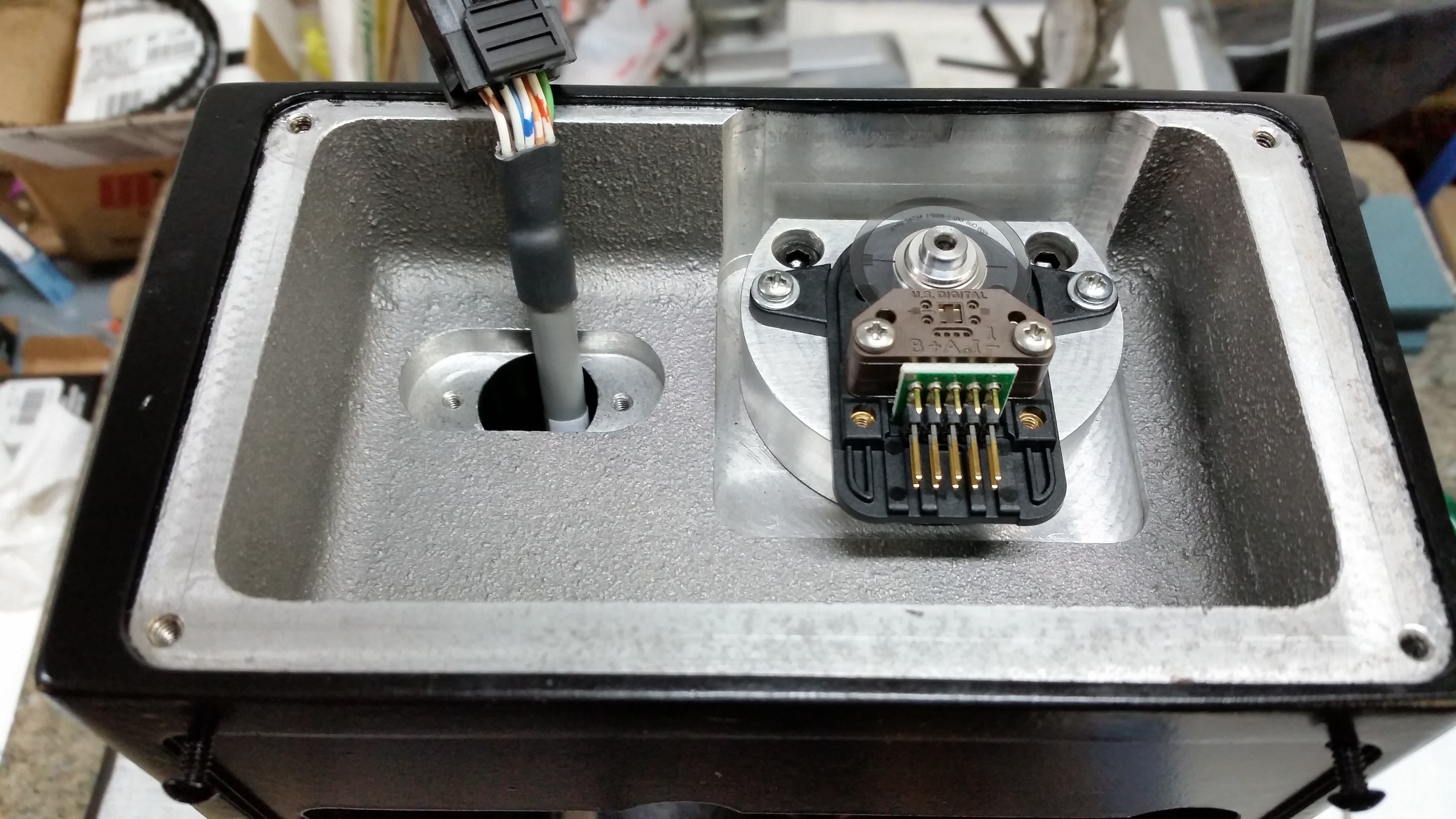

I would keep the linear encoders on the X and Y. Is this for the anilam project you posted on before?
If so, you need to understand that the ball screws on the older machines were not super high precision and positional accuracy was achieved with the linear encoders. I was reminded of that by an Anilam repair specialist.
If you have rotary encoder on the Z ball screw, I would replace that with a US-digital product. I used one that happen to be a direct fit with higher resolution. I can look for the part number if you're interested.
To get it going, I would try to use the boards in the machine as previously suggested if they still work and read in the encoder to a 7i77 etc.

- OT-CNC
- Posts: 617
- Thank you received: 75
26 Oct 2018 15:34 #119454
by OT-CNC
Replied by OT-CNC on topic What would you guy's recommend for encoders?
The following user(s) said Thank You: Catch22

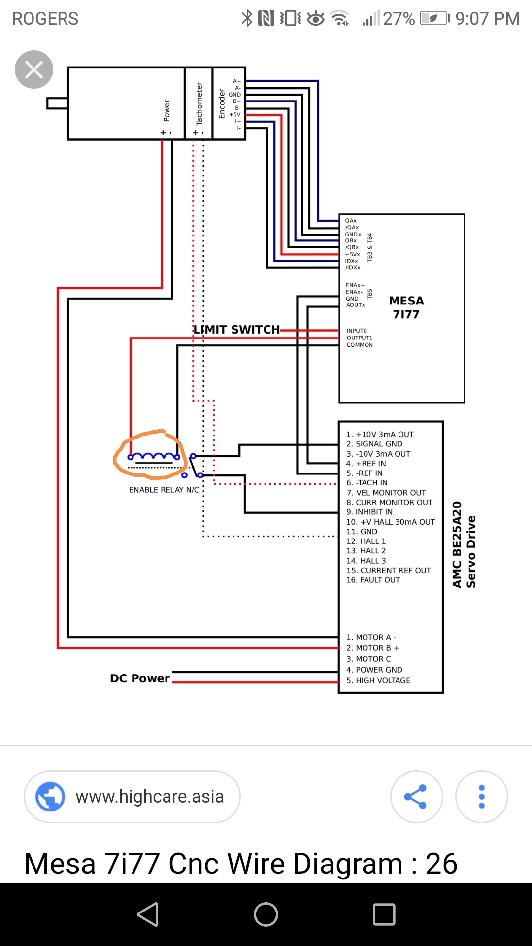

- Catch22
- Posts: 222
- Thank you received: 17
26 Oct 2018 17:59 - 26 Oct 2018 18:22 #119473
by Catch22
Replied by Catch22 on topic What would you guy's recommend for encoders?
Last edit: 26 Oct 2018 18:22 by Catch22.
- Posts: 12171
- Thank you received: 4153
26 Oct 2018 18:28 #119474
Replied by rodw on topic What would you guy's recommend for encoders?
That and the switch drawn beside it are a relay. You've circled the relay coil (low voltage side)
- Catch22
- Posts: 222
26 Oct 2018 21:18 - 27 Oct 2018 01:17 #119485
by Catch22
OK thank you, but is it really necessary to have a relay there, I wasn't planning on putting one in.
Thanks Mike
Thanks Mike
Last edit: 27 Oct 2018 01:17 by Catch22.
