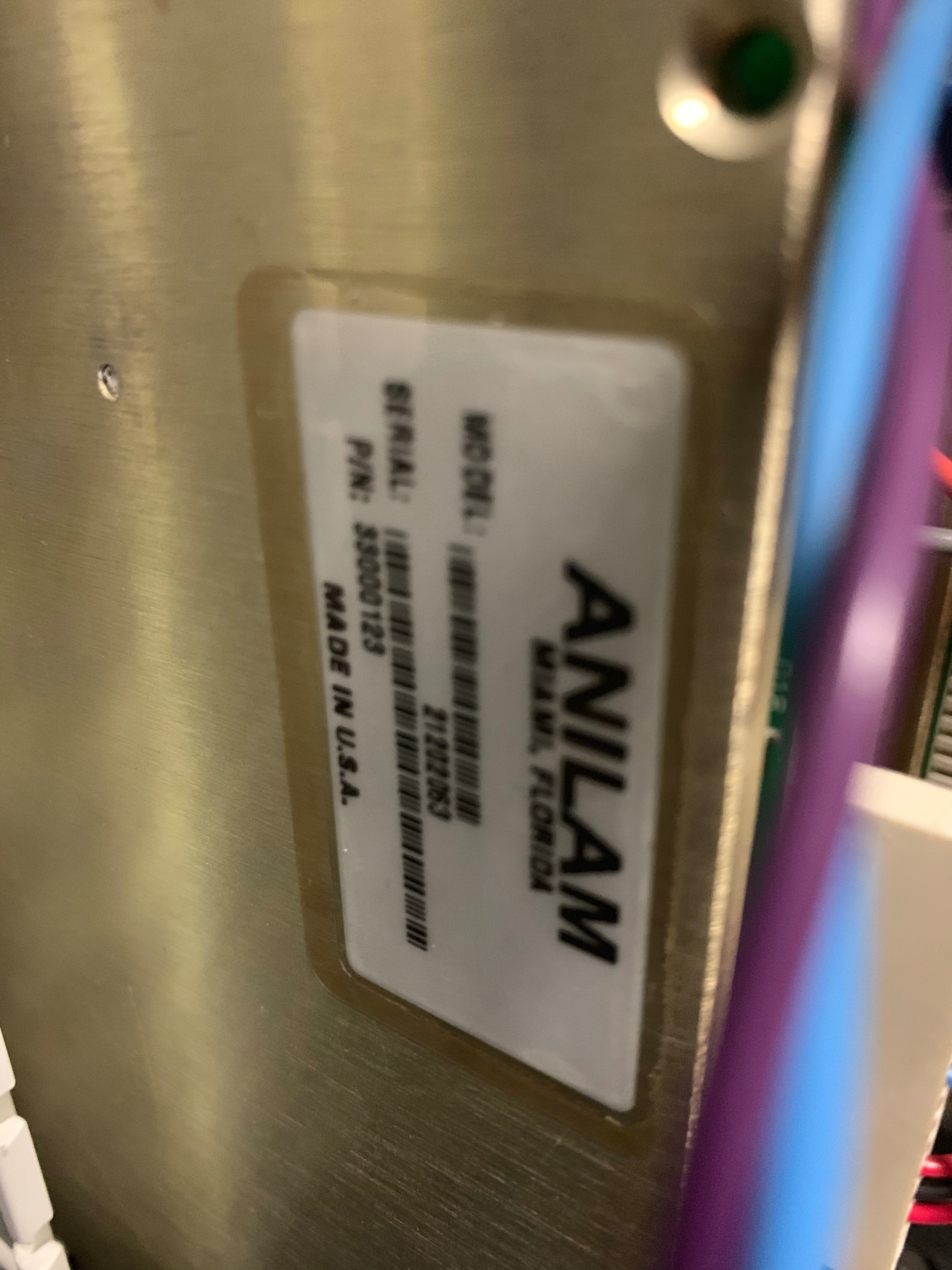

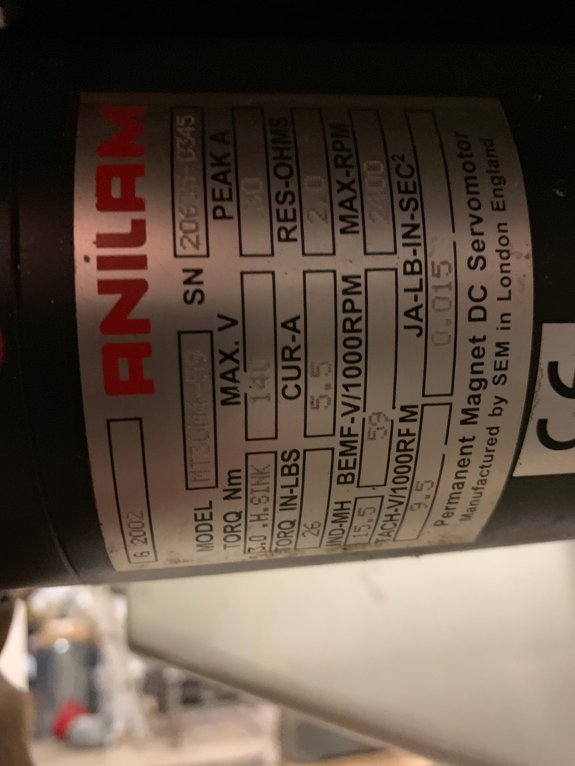

i have a chevileer knee mill with an anilam control i purchased on auction. half the control is missing so i haven't been able to test anything. i have the servo motors with tachs and encoders on them. and i have the servo drives. id like to run it with linuxcnc. and would like to use mesa cards. some kind of pci/pcie mesa card the witch ever daughter card. im not sure if i should replace the servo drives with a newer one and not sure what to go with here either. i would like it to be setup as true closed loop as in encoders back to the controller. i have attached pictures of the name plate on the servos and on the drives.

Welcome.
That looks like a perfect fit for linuxcnc.
Those will be undoubtedly be +- 10 volt analog drives.
(IIRC anilam rebranded some one else's drives)
If the drives are good it makes sense to keep them - they were chosen to match the motors/requirements.
If not there are lots of options - new drive/motor, ebay drive - (like advanced motion drive )
The mesa 7i77 is usually used with analog servo drives.
Most people use the ethernet cards like the 7i80 or 7i92 but you could use a 5i25 for pci. (there is a 7i97 ethernet card too but I'm not sure it's available yet)
Peter could advise you better on the most cost effective combo.
Any idea how much I/O you need?
How many MPGs do you want?
Will you want to do rigid tapping? (need an encoder)
Chris M

I have done a BP with anilam retro. What vintage are your drives? Mine are really old (crusader II, early 90's?) and work fine with the mesa 7i77 but the older drives emit a high pitch whine that can get annoying. Something to think about. I'll be swapping them out sometime in the future when they start to fail. If you have the power supply and relays in the drive box it will be a relatively easy conversion.

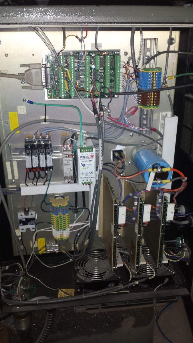

- OT-CNC
- Posts: 617
- Thank you received: 75
24 May 2019 20:00 #134846
by OT-CNC
Replied by OT-CNC on topic Retrofitting knee mill
Nice clean box JT. I wish mine was roomy. The old ones were smaller and I had to hang the 7i77 off the end in a separate enclosure. I assume your drives don't emit that annoying high pitch whine? Where did you mount the vfd?
